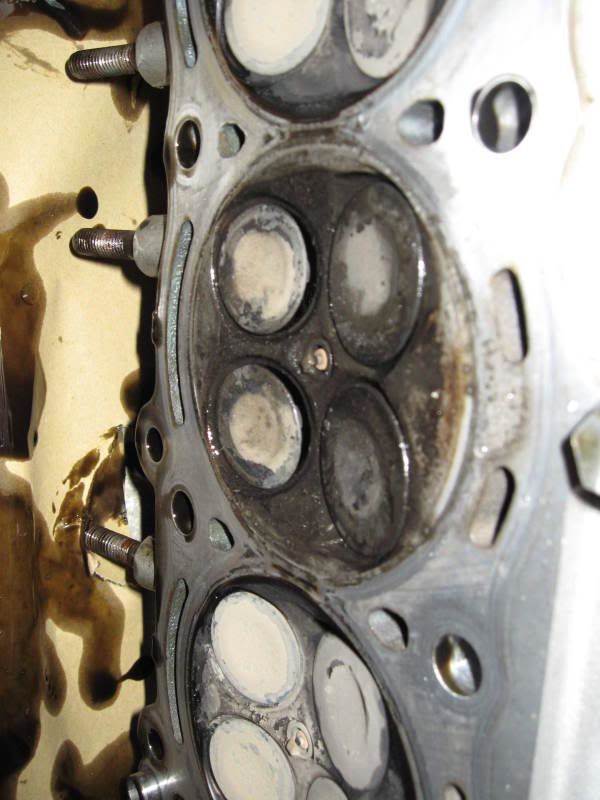

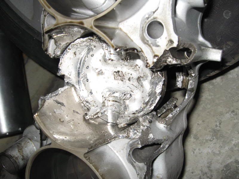

few developments today.set about with my spanners to see whats what, crank looks fine, 4 valves slightly bent and two fooked casings and cylinder scrap. everything else looks brand new still.  :D getting crank and head checked 2mrw, the outcome will influence of what I do, If both ok looking to get a more powerful version of what I broke built  :oops:  :t-up:  :t-up:

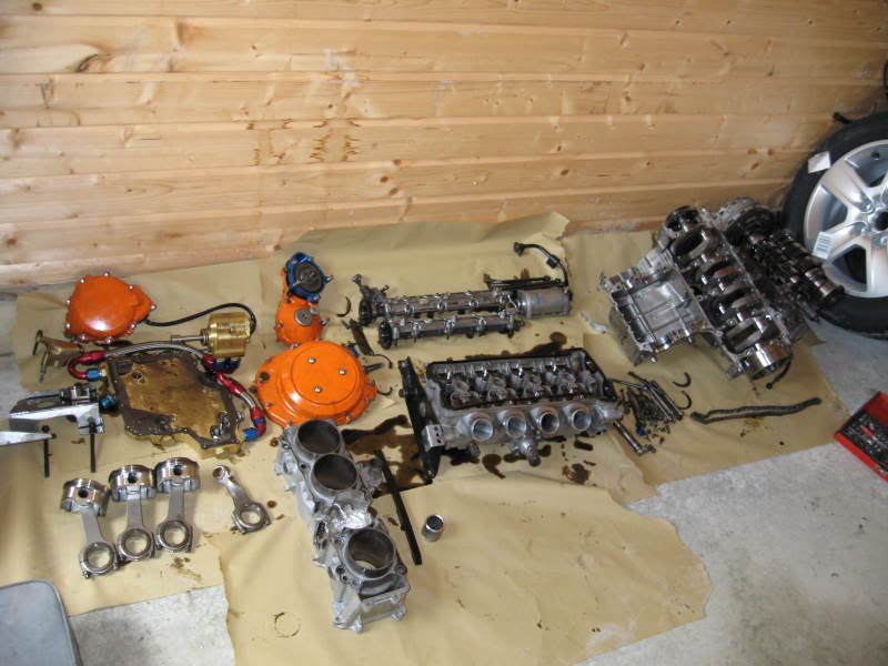

complete engine in bits, nowt to it is there  :t-up:  :t-up:
