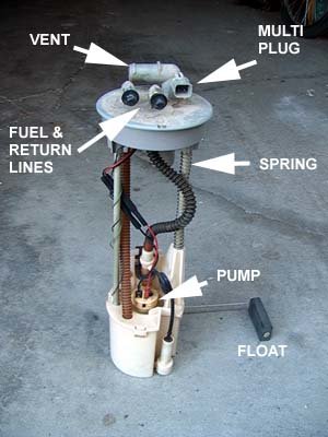

Another question. I've found this nifty fuel pump / swirl pot / sender from Land Rover
33771-b3488d4ce308c69be0568d81407141ff.j
and it even allows for a different depth of tank as the bottom part slides up/down to fit. Can anyone see a problem with using one of these inside my carb tank where I currently have the VDO sender (in the middle on the top)?
I think I've come to the conclusion that this thing, although very nice, is not suitable for our application as it can not be secured to the tank without some kind of screw collar and locking tabs that OEM manufacturers have on their fuel tanks. Unless someone else can see some alternative way of mounting?
I've used a similar bmw unit in the past. Snug hole in the tank rubber gasket and a large aluminium ring to hold it in. 5/6 sealed end rivnuts and bolts. Will see if I have a pic somewhere. Very simple and never leaked
Not the best pic but hopefully you'll get the jist
Cheers! I was concerned about additional holes, but I suppose sealing the rivnuts would take care of that. Hmm, that gives me hope again :yes:
Before I fitted I'd contemplated getting an aluminium ring with threaded holes welded to the top of the tank to avoid unnecessary holes. But went with the closed end rivnuts and it was fine. Just beware of flushing the tank if you do drill it to get all the swarf out.
