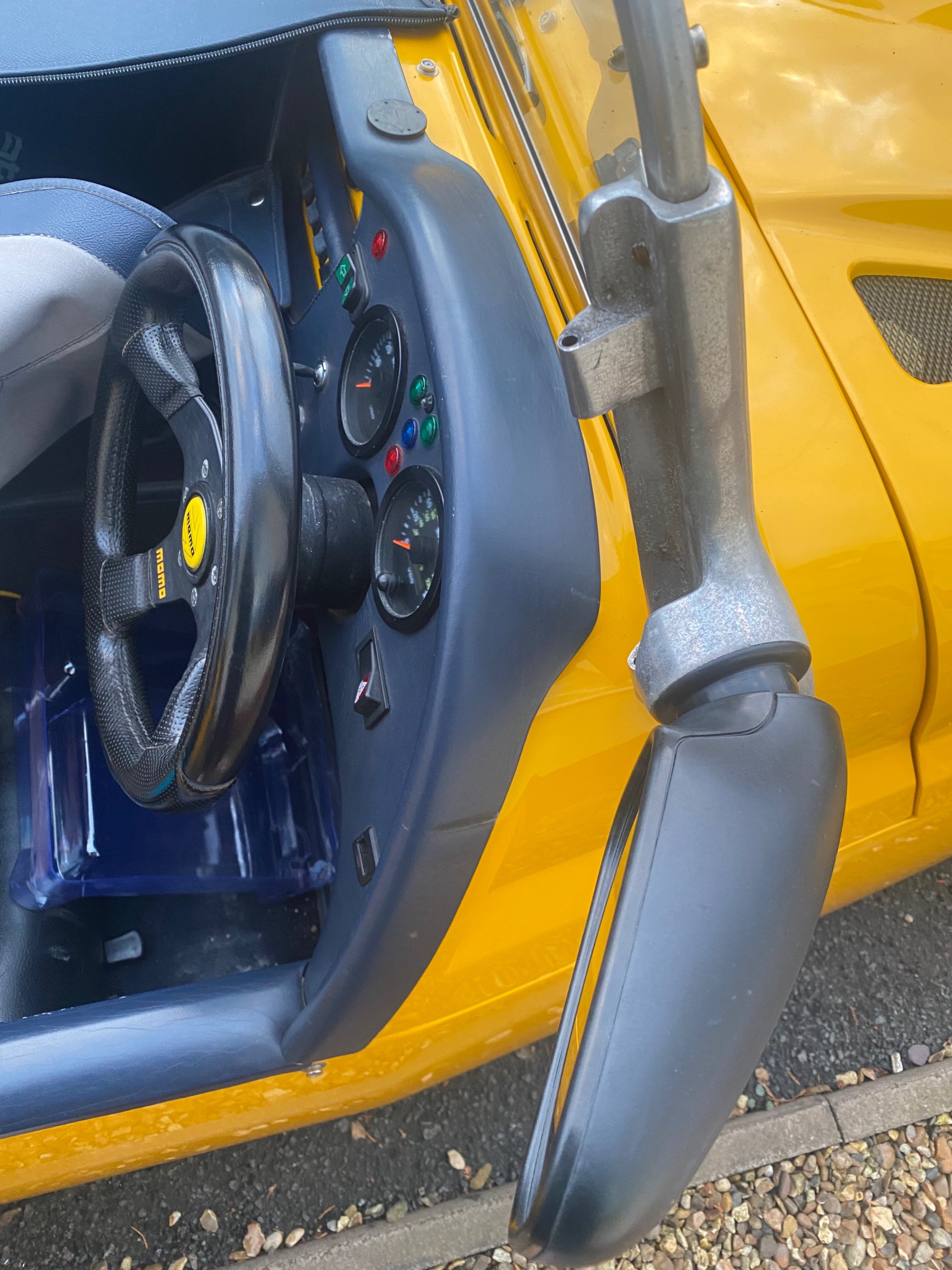

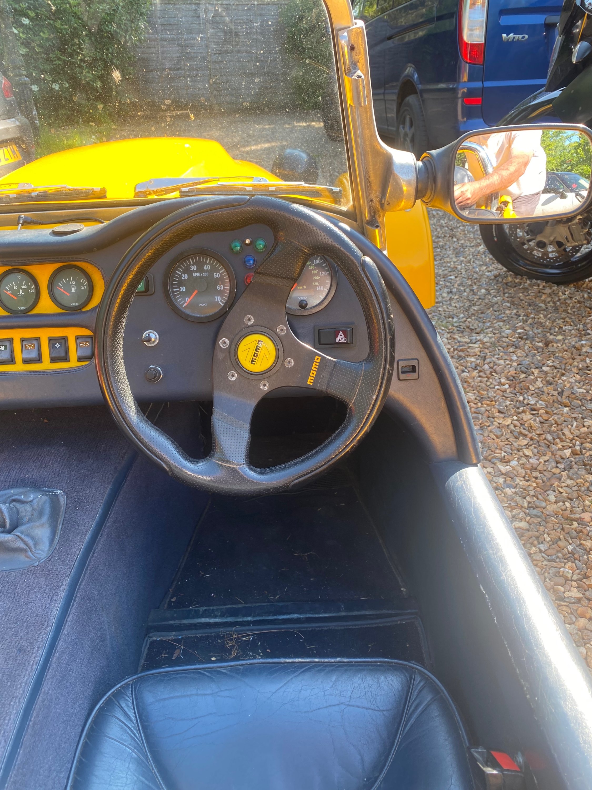

  3. It will definitely help. As per @RickRack’s photo, the Team Momo wheel in 280mm is a good choice (I’ve got one as well) due to the size and large top opening to enable easier viewing of the speedo and rev counter. Beware of fake ones however, avoid buying from eBay, lots cheap and nasty ones out there that would bend if you farted wrong. This will sound silly and I regularly get stick for suggesting it, but if you cut out a 280mm diameter circle out of cardboard and sit in the car with it over (or in place of) the steering wheel, you’ll get some idea of how much it may or may not help before purchasing.

  6. Hi Seb, welcome to Westfield ownership & the club. I see you brought ur’s from Toybox, did you sit/drive any other cars before buying yours? I think there’s no “std” wheel position & there’s a lot of retrofit options - size (diameter) and shape of wheel, detachable/fixed, bosses, spacers, etc - companies like Demon Tweeks sell every type & size. But I’d start with seat position! Are your seat’s adjustable, if so, with wheel off, set seats for your pedal box & a comfortable leg position, then hold the wheel in the ideal position for you. See where that is in comparison to its current fixed position. Then you need to make that distance up with different wheel & spacers. Also see your in Shropshire & there’s a number of owners to meet up with to compare alternate set up. Local to you check out Shropshires & Mid Wales @Nic Chase (NICO) - Shropshire & Mid-Wales AO& Black Country @Rhett Turner - Black Country AO Meetings - plus if it helps, I’m in Wolves 2 miles from M54 Junc 2 if you wanted to compare my Fixed Momo as in photos. Cheers Phil
