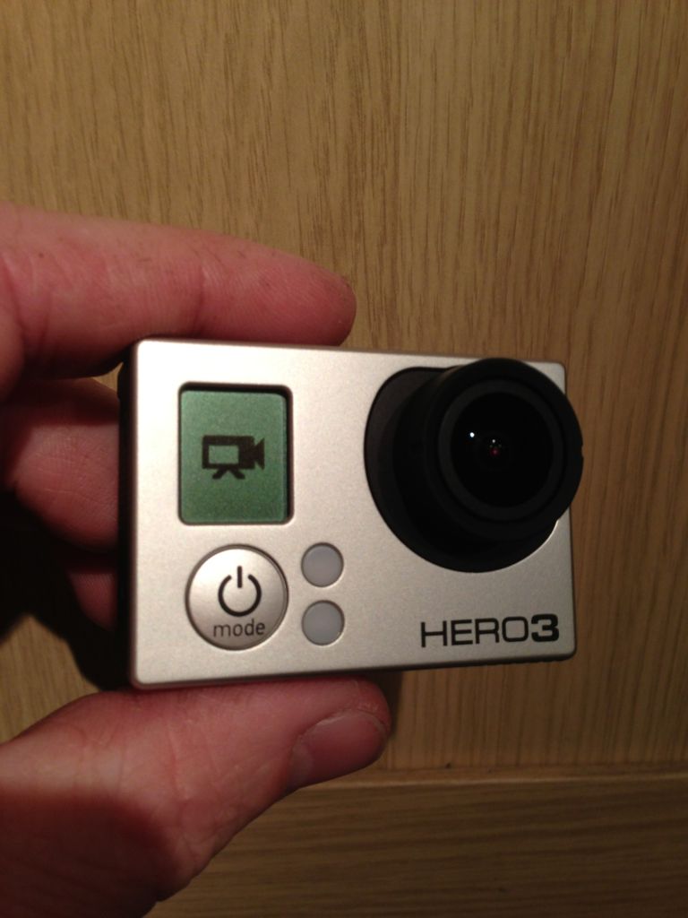

What on earth could this be?? :p
31D06732-7D9A-47E3-8202-7FBA61FB9EBA-422
Cheers, Adam! :t-up:
