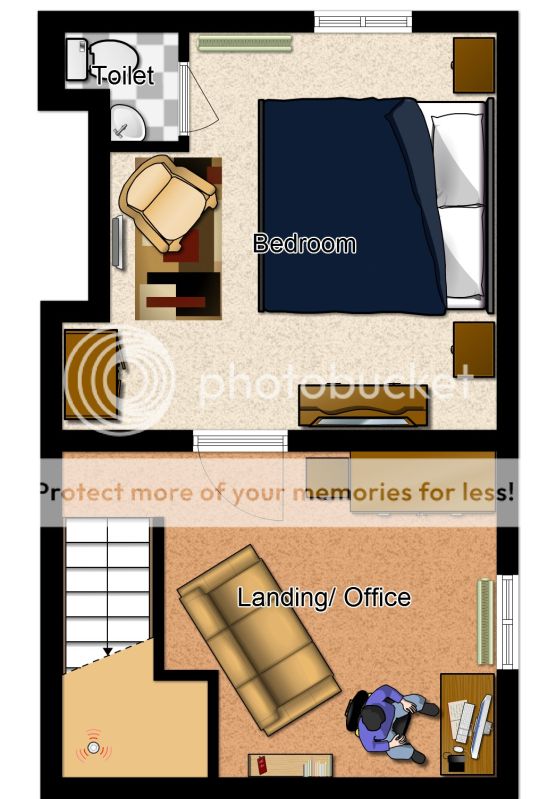

Now chez Smokey isn't the largest of establishments, indeed the garage is almost as big as the rest of the house so accommodating an en-suite would be a challenge as well as getting water and drainage to work. He's a quick layout to give an idea :)
After a bit of head scratching the best place was found on the front of the house, although fitting a WC down the side of my neighbours chimney would be a challenge.

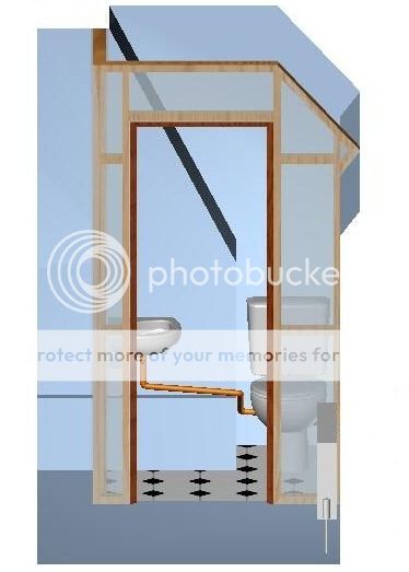

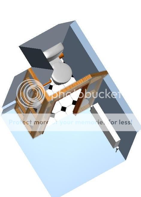

A few 3D drawings later, and everything seems to fit ok, so time to start building :oops:

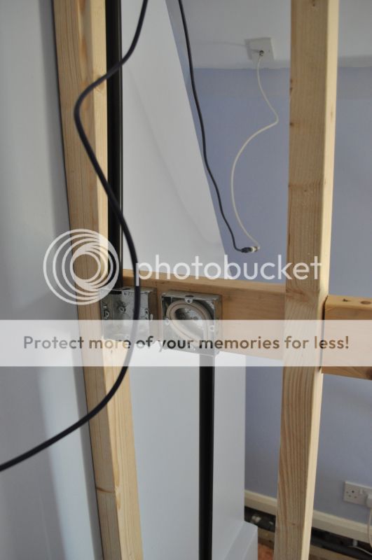

First off, lift a few floor boards, and build the studwork frame.  As internal space is so tight i opted for 63mm studs, it wont be quite so rigid but when the internal dimensions are only just over 1m those extra 35mm make a massive difference :d
Once the studs were all in place, the next task was the electrics. As the new en-suite wouldn't contain a bath or shower, the electrical works wouldn't be notifiable for Part-P as I'm only extending the existing bedroom circuits.
