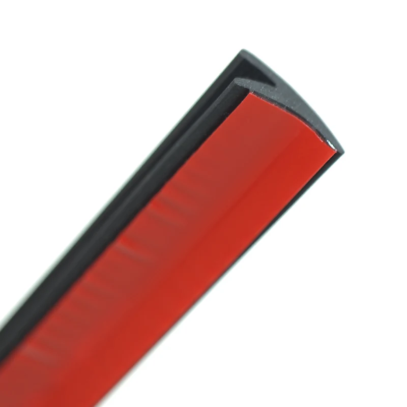

Another job for the winter is to stop the water coming up under the sidescreens (doors). Despite having mudflaps, bubble-doors and adjusting the door strap to bring the door edge tightly against the body, I’m still getting a wet elbow in decent rain. I’ve seen a rubber weather-strip used on Rab (McWestie)’s car so will experiment with that. It’ll stick to the body just off the edge of the door and hopefully prevent water being wind-forced under it. The trick is going to be putting a curve in the strip to match the shape of the leading-to-under edge of the door, and making it all look like a factory option. We always use the doors when roof-less, so the strip shouldn’t be too obvious.

@BigSkyBrad be interested to see how you get on. Currently I use the simple option of putting a microfibres cloth between the door and body panel to keep my elbow dry. Keep forgetting its there though, open the door, cloth drops into inevitable muddy puddle! Please keep us updated, thanks.
