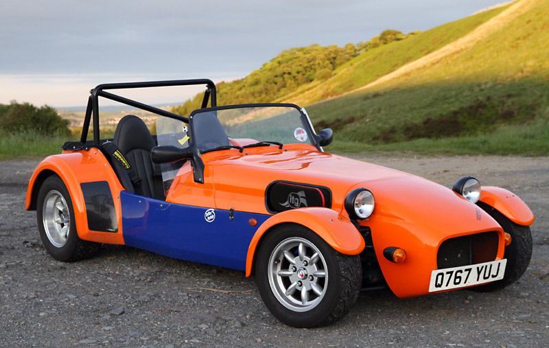

My 1998 Westfield SEW with 2.0 Zetec Silvertop engine is up for sale. In my opinion it's an ideal first Westfield, being quick, flexible and reliable - it's certainly served me well!
I've had the car since around May 2011, and it hasn't skipped a beat in 3 track days and around 1000 road miles. The only work I've had to do was re-seal a temp sensor, other than that it's just been straightfoward MOTs (last one was a couple of days ago), oil and filter change (last one was 1 track day ago), and to let upgradeitis take hold!

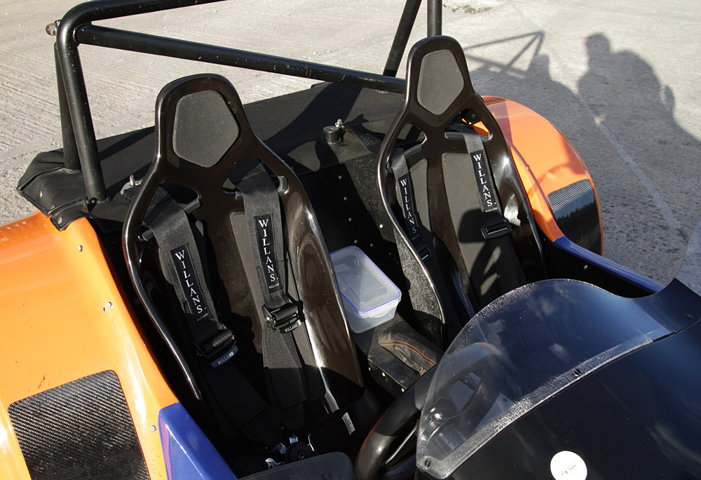

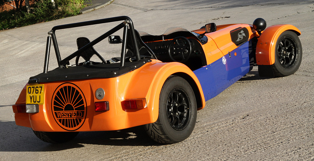

Upgradeitis resulted in GRP seats, a Quaife LSD, a Westfield aeroscreen, a custom made front anti-roll bar, some Carbone Lorraine RC5+ front brake pads and a set of Compomotive CXRs with Yokohama A048R tyres being added to the car during my ownership.

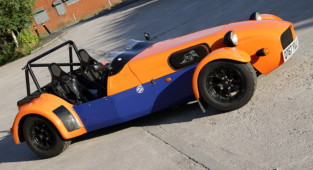

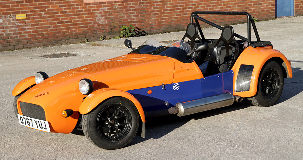

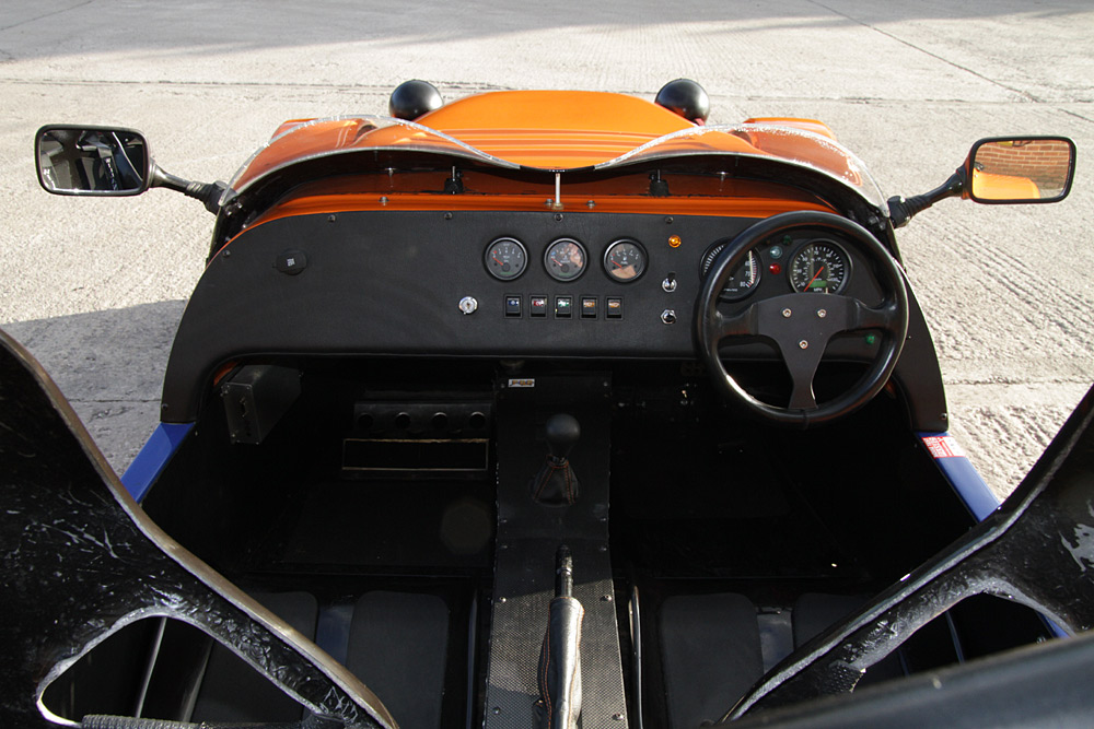

It now looks like this...

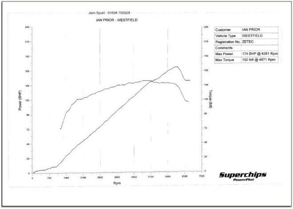

Facts and figures aren't the be-all and end-all of how Westfields perform and drive, but the combination of a superbly flat torque curve (see below), plenty of BHP (and still going strong at 6400rpm), a good overall weight (575kg), balanced suspension / geometry setup and grippy tyres (nearly new Yokohama A048Rs in Medium) make the car very easy to drive - either cruising at 30mph in 5th gear around town, or on track at 70mph mid-way through a 4-wheel drift in 3rd!
The rev limit is set at 7400, with the engine mapped to 6400. This is a very safe level (especially with the ARP conrod bolts which are installed), and even if the engine did go bang, you could drop any standard Zetec 2.0 straight in and achieve the same power.

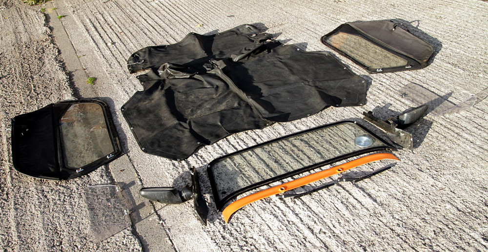

I have the full screen, pillars, mirrors, wind deflectors and side doors from when I bought the car, which will be included in the sale.. The heater and wipers are still installed, so swapping everything over is a job that involves about 8 bolts, 6 grub screws, and less than half an hour.
The tonneau cover is also made to fit the car, however it does not fit over the (now slightly taller) new seats - this could be easily modified to fit though. It's equally useful to keep the elements out both in storage, driving by yourself or while the car is on a trailer.

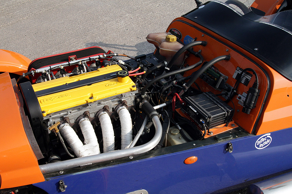

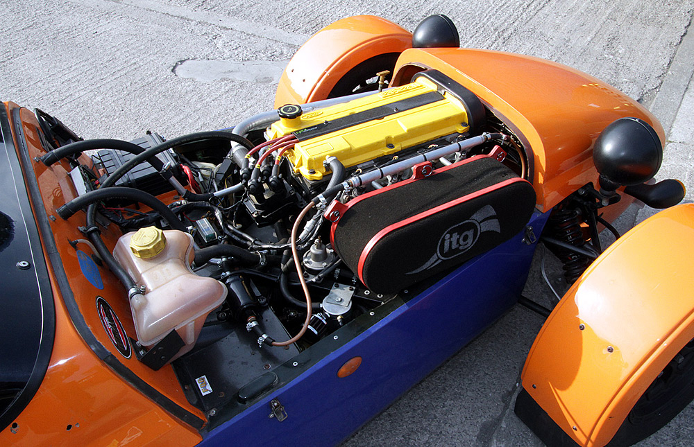

Engine and gearbox:
Zetec "silver top" 2 litre (Ford Mondeo).
Head, block and cams as standard.
Shallow sump with revised baffles (Dunnell Engines).
Lightened flywheel and heavy duty clutch (Dunnell Engines).
ARP rod end bolts.
Intermediate spec hydraulic tappets (Dunnell Engines).
Carbonmods carbon plug lead cover.
Modified cooling system (Dunnell Engines).
VW Polo rad with Pacet Profan.
Individual throttle bodies (Suzuki GSX-R600).
Red Bull manufactured fuel rail, swirl pot and 0.5 litre catch tank.
ITG performance air filter.
Megasquirt ECU.
Magnecor KV85 competition plug leads
Large bore competition spec exhaust manifold and silencer (Dunnell Engines), with heat wrapped manifold.
Varley Red Top racing spec gel battery.
Brise high performance starter motor.
Type 9 5-speed gearbox, with gear lever extension to move it away from the dash. Driving position is very important and I've sat in a few cars with the gear stick in a clumsy place - makes it much harder to drive!
Best run on 5w40 oil (standard engine is 5w30) as recommended by Dunnell. I have always used Fuchs Pro Race S and Ian used Millers CFS - both over £10 a litre. The engine doesn't use any oil, even on track.

Power - 174 bhp at 6350 rpm (rev limit set at 7400 rpm).
Torque - 152 lb ft at 4830 rpm (mapping done at Jamsport, Northampton - I have a copy of the map file just in case!).

Well-fitting GRP seats, with JK 5-piece padding, which are a perfect fit for my ~36-38 inch waisted frame (is that giving too much away?). I actually prefer them to the JK seats in my other car, but they took me a long time to fit so I'm not doing the swap! The drivers one is on a standard Westfield runner, the passenger one bolted into the floor.

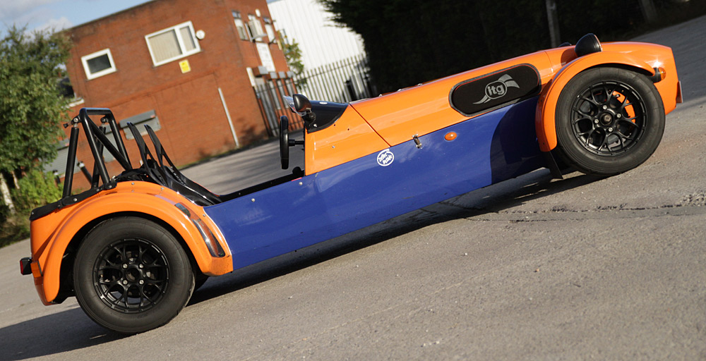

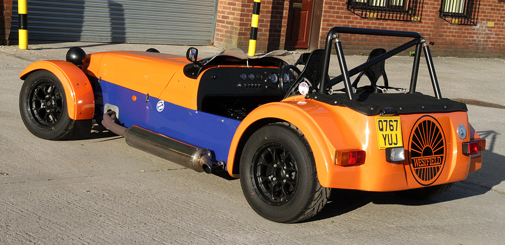

And some more pics...

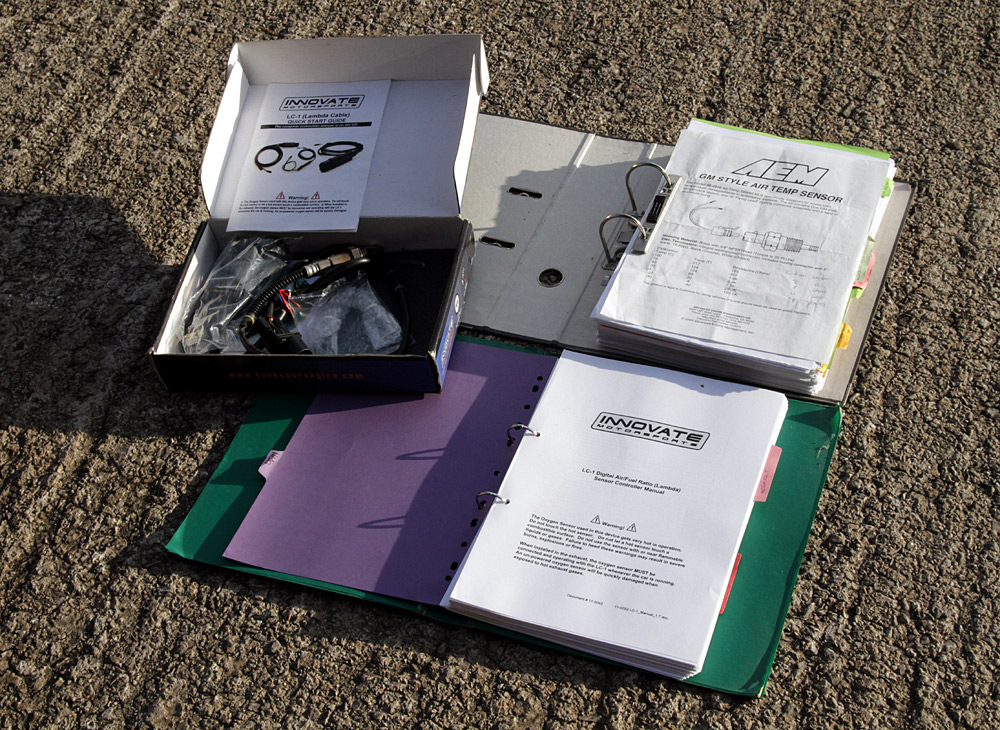

The sale includes the spare screen setup, the Innovate Wideband Lambda sensor, 11 1/2 month's MOT, 11 month's tax and a big grin every time you plant the throttle :)
