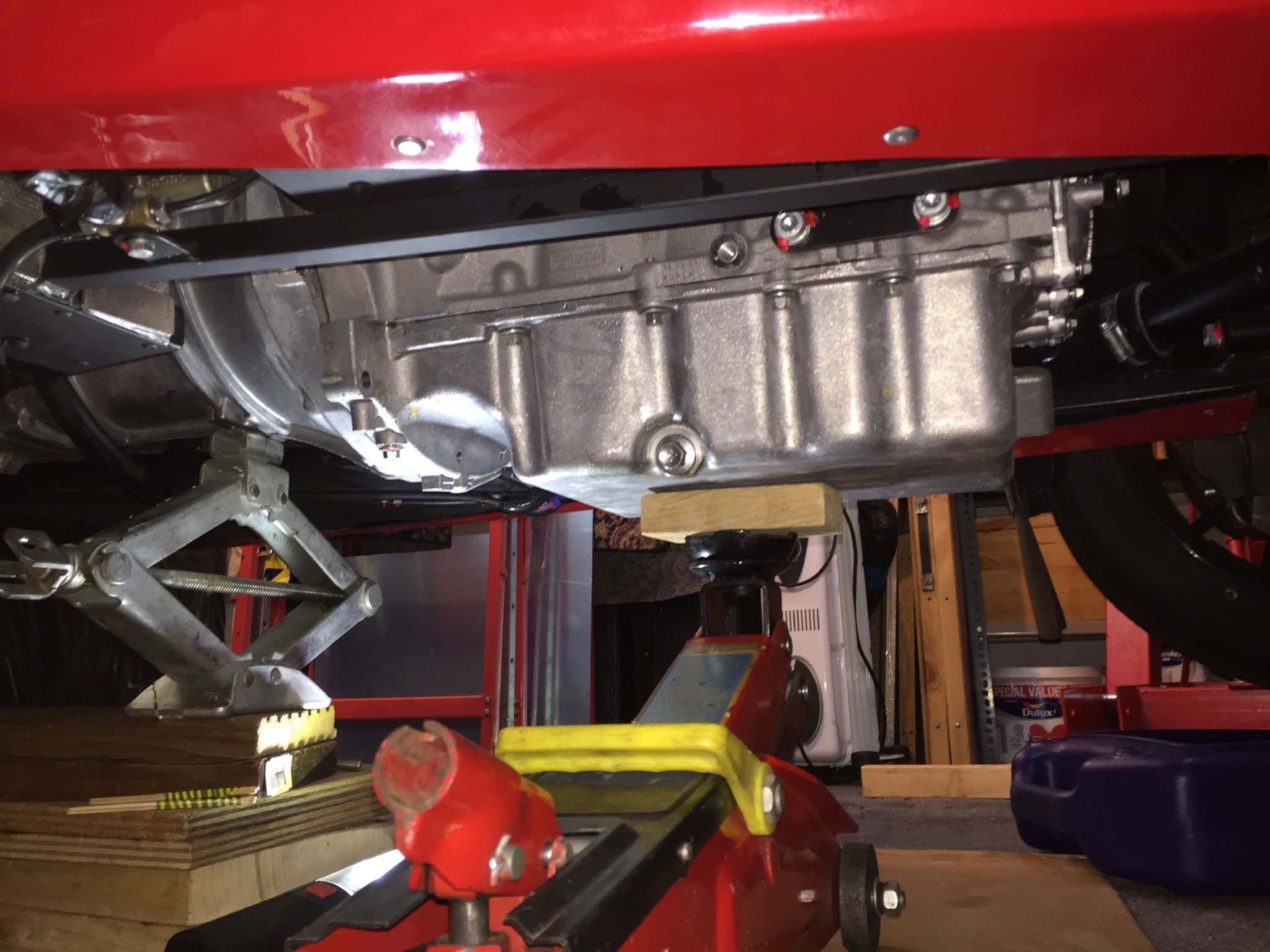

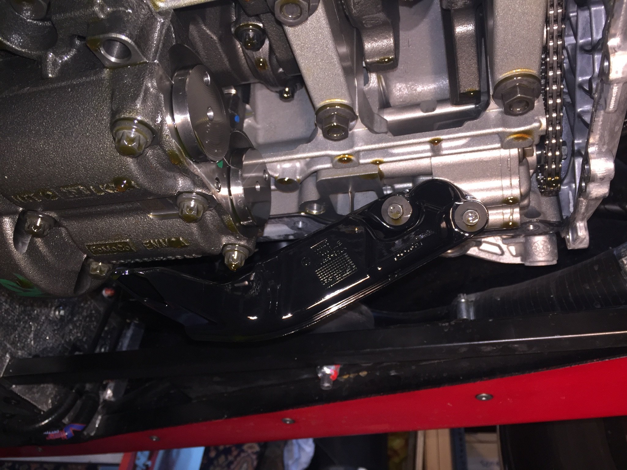

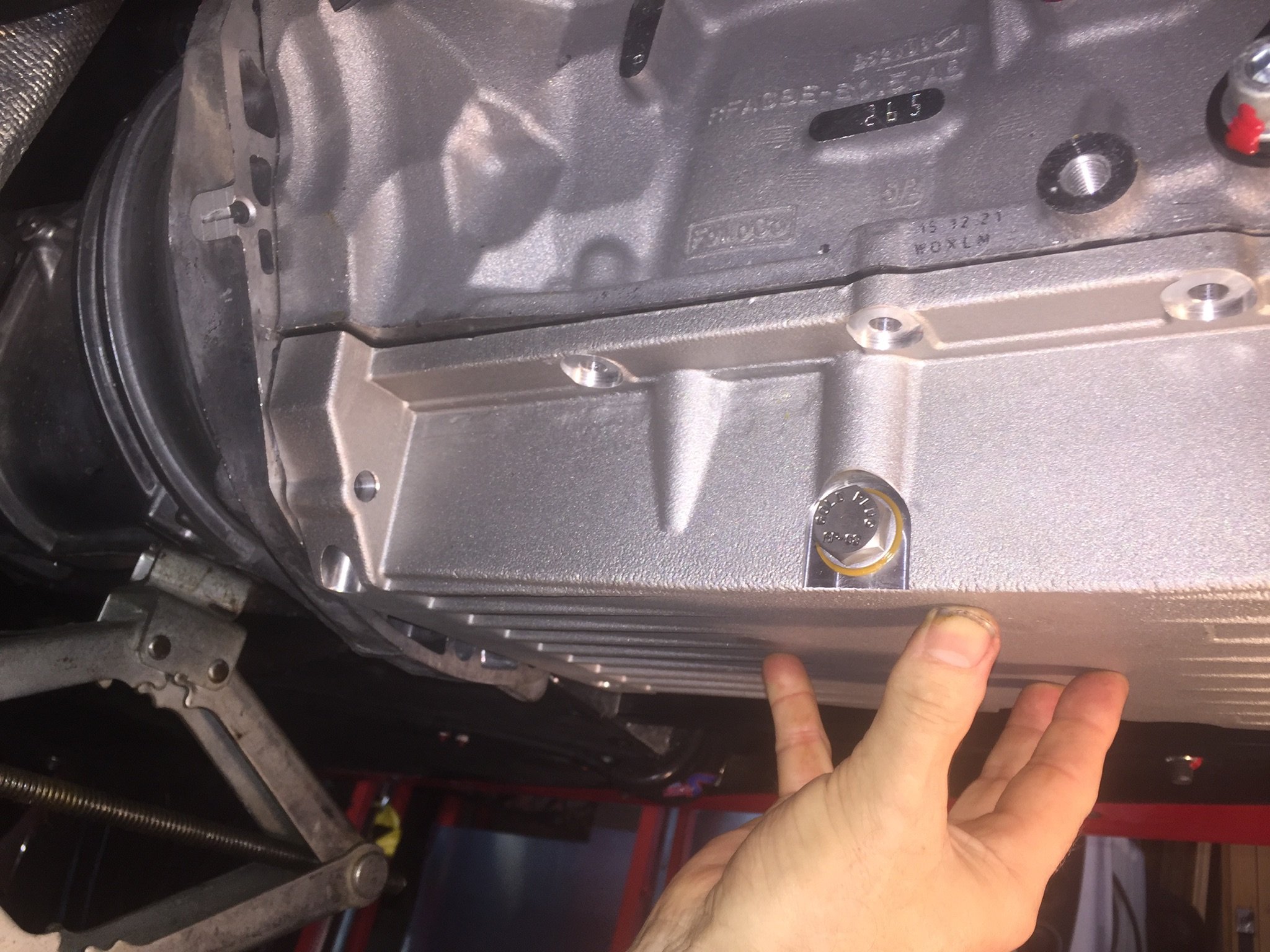

All of us have build logs up, which I’m sure you have already looked at, and the biggest thing is ground clearance and replacing the sump and pulling the 8Kg balancer shaft, which I’ve just completed following AdgeC’s guide.  Do this before you load the engine into the chassis for God’s sake, otherwise it’s a nunney of a job.
