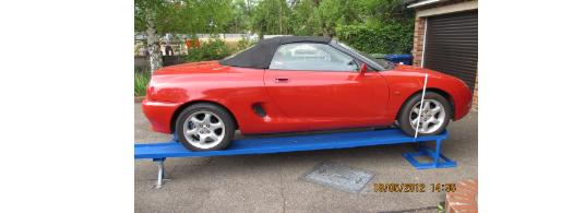

Edit: I have looked more carefully at the ones from Dash 57 and I think they are quite clever. At the price they make an attractive option. For suspension work no 'ramp' type is any good but these allow you to drop the car onto axle stands and remove the ramps for 'hanging wheels' jobs. The ones I linked to from the USA are ideal if they're laterally stable... if!
Like you I feel an itch in the credit card wallet... ??? Are you going to take the plunge?
Think so - building myself up to dropping 'em an email Tuesday morning
I woke this morning with an important query regarding these items. Looking carefully at the mechanism, it is clear that there are two positions only: 'down' and 'up'. The ramps latch in the raised position; witness the gesture of removing the bottle jacks to show that they are not involved in holding the ramps at the raised position. My worry is that the amount of lift could be too much for some cars with long overhangs, and there is a possibility that ground contact could occur before full height is achieved at the raised end.
I have asked for exact elevation distance and then I'll do a bit of geometry...

I have had the lift amount confirmed and calculated the relevant angles based on wheelbases, and of my family garage only my son's Z4M Coupé on its modified suspension would come anywhere near close to fouling the ground with the unlifted end. Even that is very marginal and only if the rear end is lifted. My Z3 is fine as is my X-Type Estate.  For reference the angle is 9 degrees at most with the shortest wheelbase (2445mm).

Well I've taken the plunge and ordered the Dash ones.  They are currently £225 unpainted or £275 painted but they say this price has to go up soon.  You can collect from Doncaster or Birmingham or have them delivered for £32.
So at last I should no longer have to squeeze myself under cars raised with a jack onto axle stands :).  Thanks for all the comments guys - will let you know what I think when I have them.

Collected this afternoon and already had the back of the Westy up on them.  I'm delighted with 'em.  The guys have a decent workshop about 4 miles from Hopwood Services on the M42 and are working on other things too like having a load sensor on the jack so you can corner weight.  The slidey things that the set up guys use to set caster to fit on top of the ramps too.  They even have a plasma cad-cam unit and can cut dashboards out with it.  Proper welding kit and the welds on the ramps actually pretty good.  Darren has buit a Cobra and says they would be happy to have a go at any kitcar related fabrication.
Nice guys and even threw in a set of short lock bars so I can lock the ramps half way up.  Brilliant.
