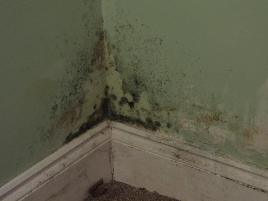

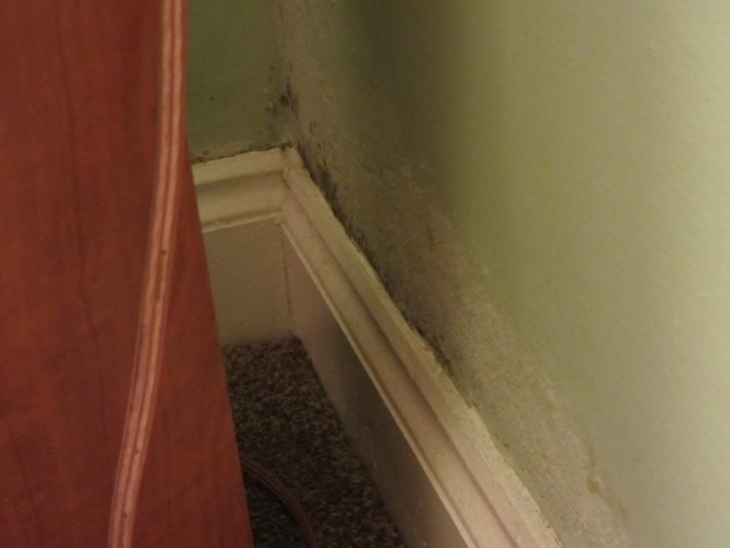

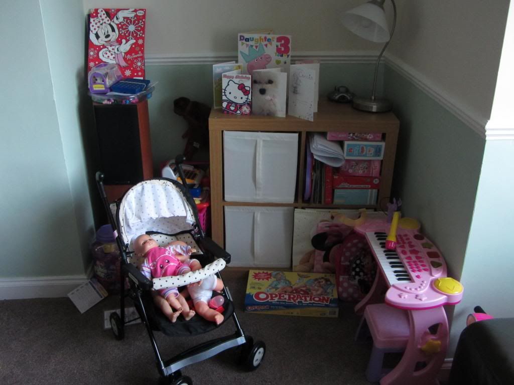

westfield_bumble Posted December 1, 2013 Author Posted December 1, 2013 Busy couple of weeks. The cupboard heaters have came and the air smells better and the wardrobes feel warmer. But we went for a little rearrange of the living room tonight to put the christmas tree up and came across a lovely patch of mould http://i169.photobucket.com/albums/u233/scott_prelit/mould/IMG_1349_zpsdba9a7e5.jpg which was sat behind the toy corner as below http://i169.photobucket.com/albums/u233/scott_prelit/mould/IMG_1332_zpsbc57f386.jpg then a little more looking i spotted mould behind the speaker which had plenty room around it to breath and also behind the speaker the other side of the chimney breast too http://i169.photobucket.com/albums/u233/scott_prelit/mould/IMG_1353_zps6562f97e.jpg I'n not sure wether this is condensation or the damp course which was done in 2008. I'll ring them in morning to come out and check as its got a gaurantee. I've had the guy out from envirovent about the piv system. it came in at £900 and then he recomended one of his moisture tracking extractor fans at a further £300 fitted. had a dig about and i can pick one of these fans up from about £50-£100 on ebay and it will just be a swap over. I'm gonna email the photos over to him to see if he agrees it will stop this Quote
Mark (smokey mow) Posted December 1, 2013 Posted December 1, 2013 That looks like Black Spot Mould which would me commonly be a condensation problem rather than the DPC. Quote

Terry Everall Posted December 2, 2013 Posted December 2, 2013 The white furry stuff is salts forming as the damp plaster is hygroscopic and attracts moisture From the pics those areas look like rising damp. The black spotted area is condensation mould caused by warm moist air condensing on a cool surface (with minimal airflow) Quote
westfield_bumble Posted December 7, 2013 Author Posted December 7, 2013 i had the dampcourse guy out and he checked and all appeared well. he also did a humidity check while he was here and it was a tropical 75%. Dew point was measured at 4.5deg C. I hadn't had the windows opened for a few days to ventilate. So i've ordered an envirovent humidistat extractor capable of extracting 6 times more air than the current one for the kitchen. I dont think theres enough space to change the one in the bathroom for this one so will wait and see if it will fit before ordering another one for there. Thats short term plans sorted till next year and will get a piv system sorted for next winter Thanks for advice Scott Quote
