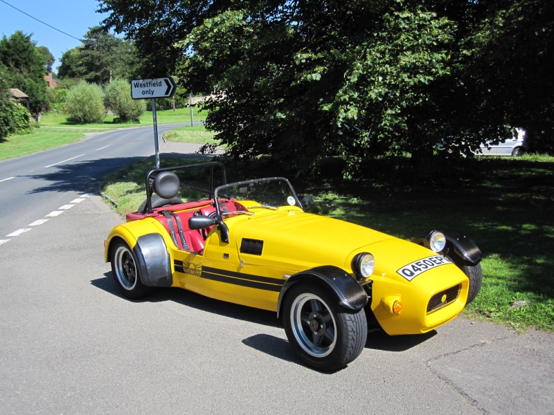

I've done it on mine. Some things to bear in mind:
As you've said - you'll have a number of holes to fill. I used fibre glass matt / resin to bridge them from the back, sanded back then filled with new gelcoat.
The holes will likely have crazed and pulled proud of the surrounding panel due the strain of holding on those enourmous wings. This means more sanding back and filling than just the bolt hole.
Gel coat is horrible, messy stuff but easy enough with a bit of practice. I use a disposable pipette to squeeze it into the holes then sellotape over the top to keep it in place (needs to be covered from the air or it won't go off fully).
Remember that two or three of these holes are into the cockpit area so if you have internal panels fitted, you'll have to carefully drill out the rivets and remove the panel to get at the back of the holes.
On mine, the side panel was quite rippled after I removed the wings where the fixing bolts had pulled the panel out. Looks a right mess when you first take them off but leave in the sun on a few hot  days and through the magic of fibreglass, it will mostly sort itself out (although mines not perfect).
There will be a nice bright line where the wings covered the fibreglass (this will fade a bit in time but not totally).
The gelcoat you fill with is unlikely to match fully.
In the end, I bought some stripes of ebay. The chap is very helpful and made them a bit longer than advertised and got rid of the chequers that are on his listed ones at no extra cost (picture below).
Edit: some more things I forgot:
If you have cortina uprights and swept wings, the uprights probably won't have been modified to accept the Westfield cycle wing brackets. You can use Tiger ones though as they bolt onto the dust cover holes. I swapped to Westfield alloy uprights as someone was selling a set on here.
You'll need some new headlight brackets. I ended up making my own with my mate's welding assistance as the narrow ones are hard to come by and some of them hit the wishbones on full upward deflection. If you use the braced type, you'll need a longer bolt for the suspension mount that they attach to with the spacer (Westfield can supply). Other folk on here have used the ones that just fix with the clamp alone with no issues but I didn't want to.
As indicated on the FAQ, once you have cycle wings fitted, they will almost certainly hit either the bodywork or your headlights on full lock. Technically this is an MOT failure but I've got away with it so far. You can remedy this with lock stops but they tend to limit more of the lock than necessary so you get the turning circle of a bus.
I've probably forgotten lots of other things but you're welcome to PM if you have any questions. The above makes it sound worse than it is. I'm glad I did it but it's one of those jobs that involves more work than you'd first think!
Looks like this now:
Before I fitted the stripes but after filling and much sanding, rubbing down etc (it was a bit more visible in reality). Gives you an idea what to expect - click on the picture for a bigger version.
