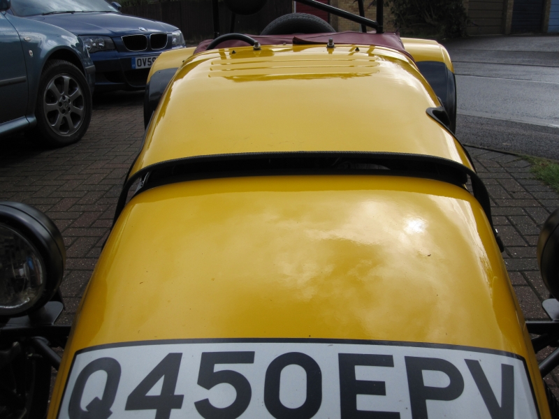

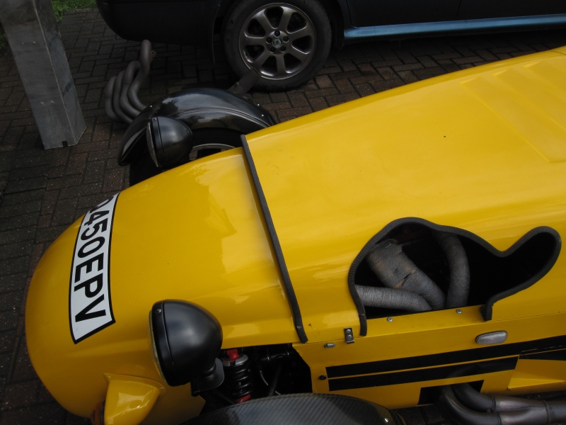

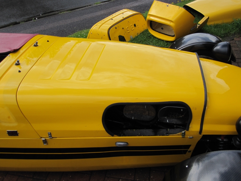

Geoff101 Posted October 1, 2012 Posted October 1, 2012 Some pictures of a highline bonnet on my lowline car to show the difference: Quote
