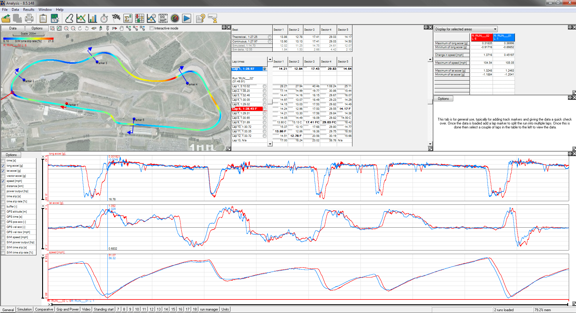

One of the things I'd been doing over winter was some datalogging. I have found it very very useful in identifying areas to gain time very quickly and in an easy to understand graphical format. I'm a big believer in developing the driver instead of the car, and it seems the ideal tool to do it.
Here's an overview of the qualifying session, with my quickest lap highlighted in red. It looks a mess if you don't know how to read the data, but here's some of the stuff I look at...
- Braking / acceleration G, cornering G and speed trace at the bottom. If any of the 'spikes' under braking or cornering are obviously smaller in one corner, then you know immediately you are not using all the available grip at this point!
- On the lap times chart, F means fastest sector, FC means fastest consecutive sector (top middle of the pic). On Lap 7 the first sector was actually 0.17 faster than the first sector from my fastest complete lap (lap 10), for example. So, my overall theoretical quickest lap (if I'd have strung together all my fastest sectors into one lap) would have been 1:28.63 - about 0.4 faster than my actual fastest lap. This is useful to see how consistent your driving is - if your theoretical is miles quicker than your actual best, that tends to indicate things are a bit erratic!
- You can also see that laps 4 onwards (with the exception of lap 8 where I got held up) are all pretty consistent and gradually tending to get quicker. You must complete 3 laps without firing it off or you aren't allowed to race, so I always take the first couple pretty steady, build up pace, get some heat into the tyres and brakes, learn the track conditions, try to find myself some space in the traffic, and then press on.
- The coloured track map shows were I can go faster and where I did ok. You set up a 'simulation' car (using power, weight, drag coefficient, maximum cornering (1.25) and braking g (0.9), and a few more) and the software compares your performance to it. Red means I'm slow and blue means I'm not so bad! It doesn't take into account gradients and cambers (those who have done Donington will know how important these are!) but the main areas it looked like I could gain time were the braking zone into the first corner (Redgate) and the uphill entry to the right hander at the back of the track, Coppice. This is where I could hopefully gain some time for the race... The section between marker 3 and 4 is all uphill, hence the simulation software thinking I was losing time.

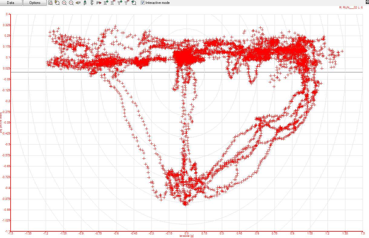

'Driving the circle' is a phrase used to try and explain how the g-force trace should look if you are using all of the available grip of the tyres. You get hard on the brakes, then gradually reduce braking force as you turn in, seamlessly blending into full cornering force at no braking or throttle, then transition back into full throttle. If your car can brake at 0.9g and corner at 1.25g, this means you can actually 'cheat' some extra grip out of the tyres and corner at 1g while still braking at 0.4g, say. The best drivers ride the rim of the 'traction circle' all day long and make it look easy, but it's not!
Here's a video from the start of the year where I started logging and using the circle to show me where I could use the available grip better (don't need to watch it, just look at the shape of the blob):
And then at Cadwell a month later...
The first video is more of a 'pitched roof' shape and the second one is much more rounded - this is what we're aiming for!
Checking the g plots from the quickest lap in Race 2 it seems I'm getting there but I can still fill out the circle better. Since there are only a few left-handers at Donington and none of them are 'true' braking zones, the trace on the left could never reach as far to the side as on the right:
I'm relatively happy with the progression there from the Blyton video above.
Looking at the overall data from Race 2 shows the following...
- I'd got rid of / reduced the red zones at the two braking points I wanted to (compare the pic below to the one above).
- Consistency was bad! Compare theoretical to actual lap times - in fact my quickest overall lap this time only had 1/5 quickest sectors, compared with 3/5 for the quali lap. I think this may have been down to traffic / other cars, you can see at the first corner my speed plateaus for quite some time, and then again at the 3rd 'spike' in the lap. The second speed spike which also plateaus is Craner Curves, so no matter if you're flat on the throttle the car speed doesn't really increase as there is so much tyre scrub.
- If I had strung 5 good sectors together I'd be down at 1:27.25, which I was pretty chuffed about!

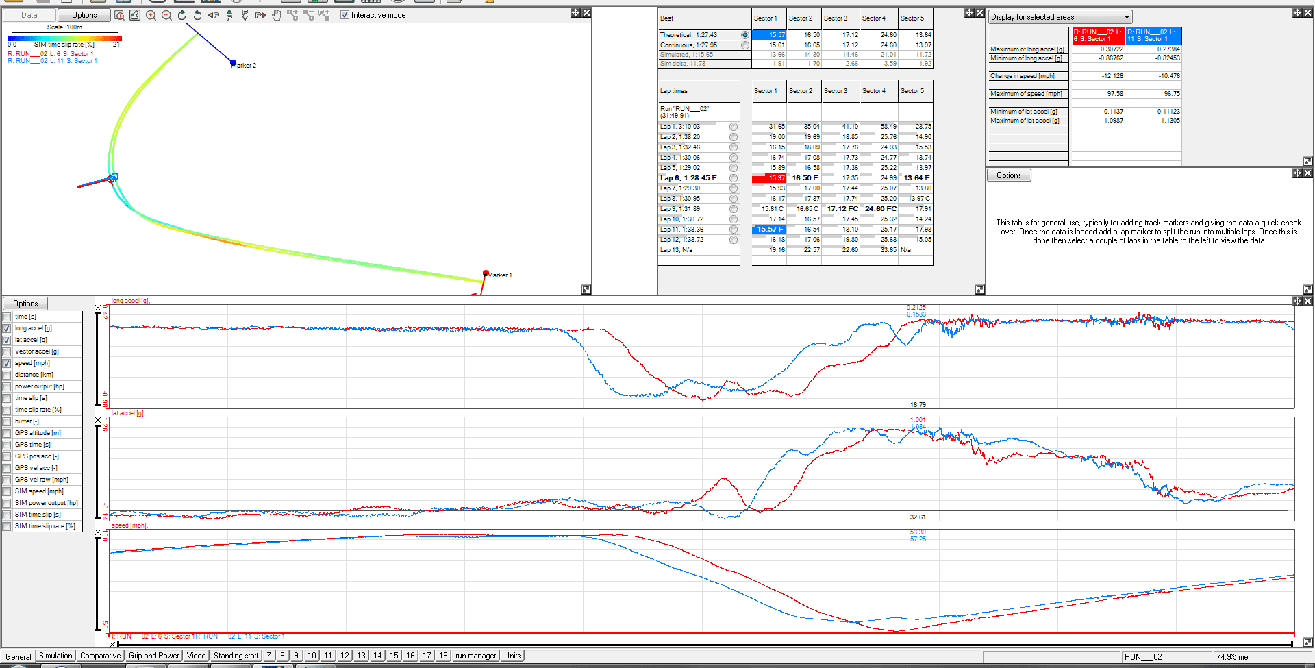

The datalogging software is also really good for finding out why you were fast or slow at a particular part of the track.
My 'goal' had been to brake later in general after I'd seen the simulation comparison following qualifying - I managed this and it did gain me over half a second, but the data reveals that I probably overdid it a few times...
The comparison below is my fastest lap in quali (blue) vs fastest lap in race 2 (red):
- I hit the brakes much later (up to 10m!) at nearly all the corners, but this hurt my apex speed everywhere apart from the chicane. I had gained time, but it was from carrying my end-of-straight speed for a little longer rather than carrying it through the bends.
- Example: Where the vertical line is across the speed trace, I was 5mph slower through the first corner apex on my race lap compared with qualifying lap, because I'd braked too late and gone in too deep! This sort of thing was the same throughout the lap, I'd gone from braking too early to braking too late. The video I'll put up later shows the consequences of this :)
You can also study closer into this first corner example, and that looks like this...
The pic below compares the first sector only of my race 2 fastest lap with a different lap that was slower overall, but was 0.4s faster through the sector...
I braked harder on the 'red' lap (0.86g as opposed to 0.82g), but the 'blue' lap had a higher peak lateral g (1.13 - 1.09). When you look at the lines it becomes obvious why!
The blue blob on the track map shows I took a tighter line through the apex, so even though I braked later for the 'red' lap (the traces cross over - the blue sector's line turns orange in the braking zone, indicating I was a bit early on the brakes) and carried more speed into the turn, I couldn't keep the car on line, couldn't get on the power as early and ended up being slower all the way down the next bit of track, losing time overall!
So, it really is a delicate balance - and there is still a lot of work to do - however I have learnt a few things from yesterday...

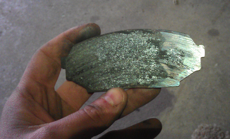

AFter the race I realised one of my front pads was down to the metal - that may have had something to do with the lack of retardation towards the end of the race! (Racing Driver Excuse #457)

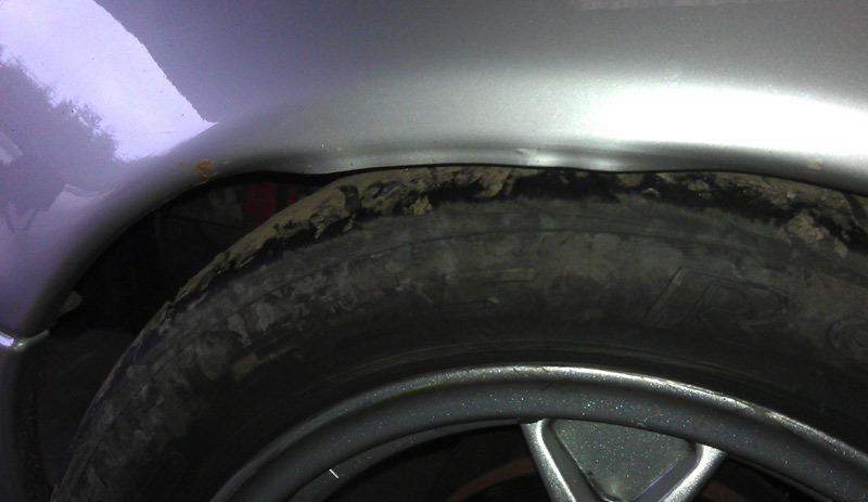

And a couple of post-race pics, possibly related...
It seems the front tyre / something flexed enough for the tyre to pull the return lip on the edge of the wing straight when I went over those kerbs!
