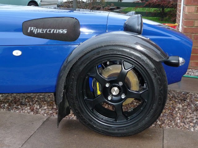

chappers Posted February 9, 2012 Posted February 9, 2012 Yeah I thought so too.. impressed! I'd like to make the cut out bigger but a little nervous about hacking away at the bonnet. Any idea of the best way to approach this? Fairly straightforward. I just marked the bonnet where it touched the filter, took the filter off and refitted the bonnet then dremeled it out to the marks, replaced the filter and bonnet and marked it again and repeated the process. I thought it might be easier and more rigid to dremel while the bonnet was fitted but that's just me. Obviously taped over the air inlets and covered the engine from fibreglass dust. I also angled the cut edge so that you didn't see the thickness of the fibreglass at the cut edge and so that there were no sharp edges to touch the filter, though I did open up the cutout so there was a little gap all around to allow for a little engine movement. Take your time and it will look great. I also put some enamel blue paint on the cut edge to seal it. Was a bit scary making the original hole but well pleased. Quote
Young Pretender Posted February 9, 2012 Author Posted February 9, 2012 Ooo liking that mate.. and you made it sound so easy. I was only looking at dremels today actually. Quote
