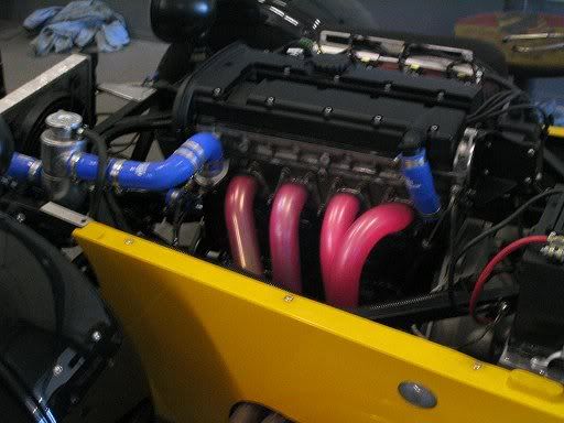

Took the day off work on monday to trailer the Westy upto Essex to get Steve Greenald at Race Engine Calibrations to work his magic on the map.
Got there at 10am after a 3 hour drive and work got under way around 11, after we had a cuppa and a chat.

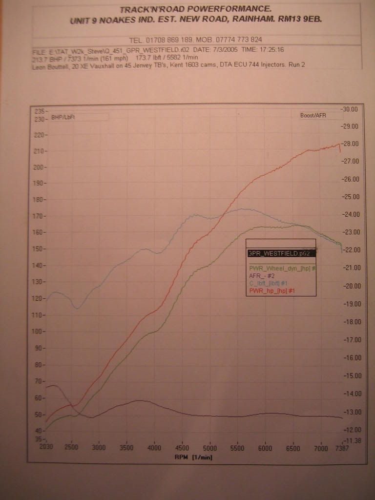

Was really impressed what Steve had done with the engine last time so went back to him.  The previous engine made 184bhp / 153lfbt torque, standard 20XE with Jenvey 45tb's.  This time the engine had Omega deep pocket forged pistons (think these change the compression ratio), SBD 4-2-1 manifold and ti can, lightened and balanced bottom end and Kent ast1603 (278 duration 11.6mm lift) cams.
The mapping lasted a good 5 hours but the end result was well worth waiting for.
Engine made:  213.7bhp @ 7373
                   173.7lbft @ 5582
Speed in 5th @ 7373 rpm - 161mph
The power just kept rising but unfortunately my VX cream injectors got to their max duty cycle.
Now having driven the car it is totally transformed, love it  :D
Just need some sticky tyres to put the power down.
More pics here.....

While I understand the Red & Blue lines, how come the Green line tails of @ 164bhp @ 5750rpm ??? & Wot's the Purple line ???
I think the Green line is power at the wheels, but the rollers are setup to calculate power at the fly so that figure is a load of   :arse:
After they've done the power run the computer does some calculations and porduces the graph as seen, if i wanted power at the wheels it does a different calc.

Purple line is Air:Fuel Ratio.
For power it needs to be around 12.8:1 at wide open throttle and it looks like it is.
Yep thats the one Chris, air/fuel ratio, they have a wideband on the exhaust to monitor this constantly during the mapping.
