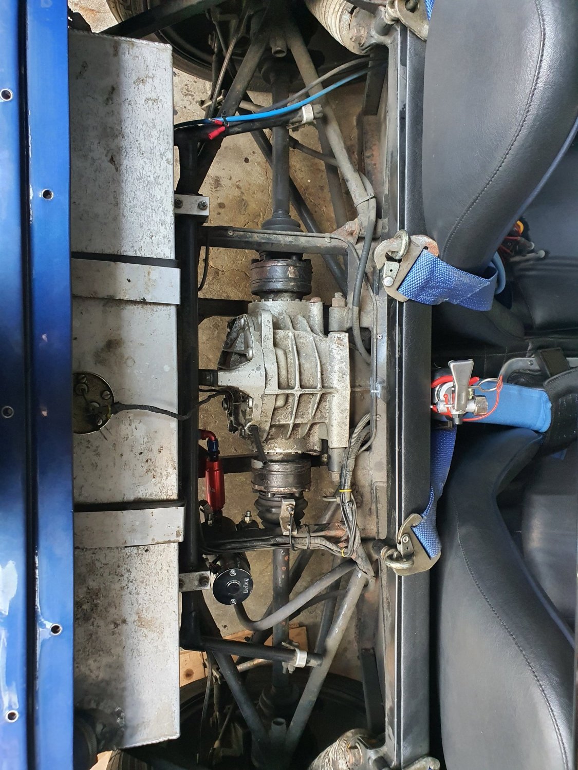

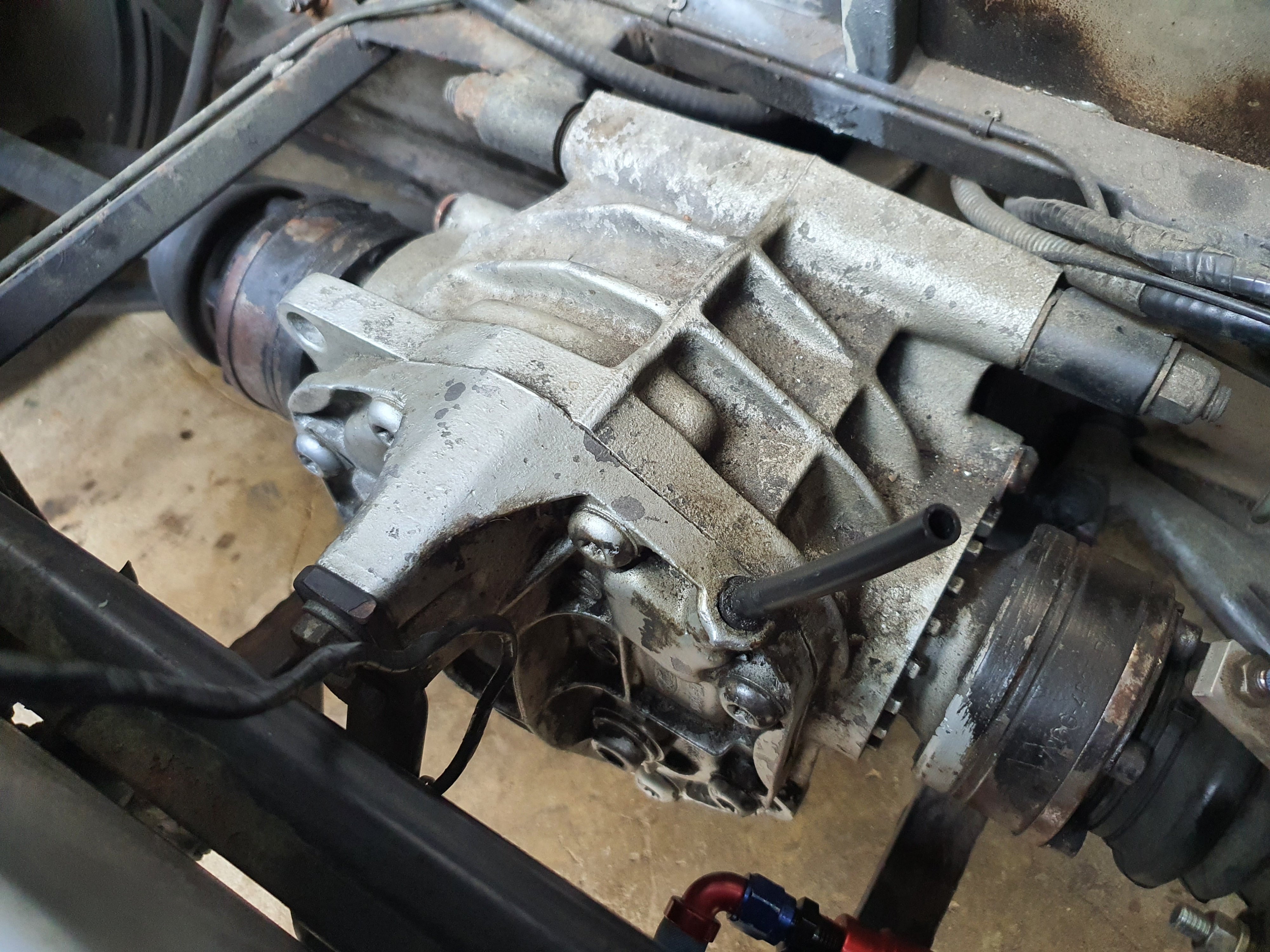

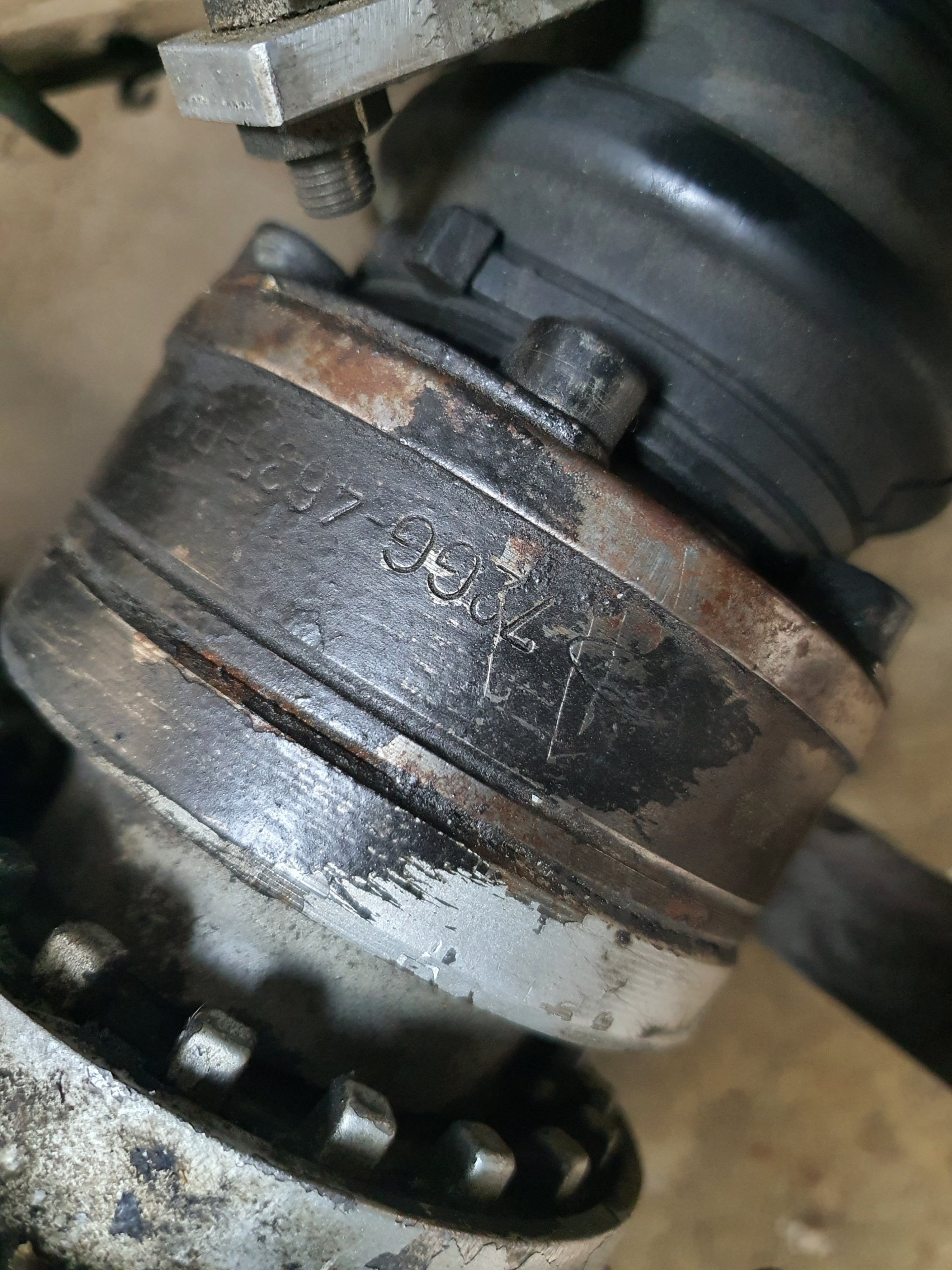

Hey guys, thanks for all the replies.
So yes ideally something cheap and easy to fit. Usage will be for fast road, and spirited driving while touring around mountain passes in Europe.
Reason for LSD is to have a bit of fun around mini round abouts, coming out of junctions, maybe the odd baby burnout here and there, all slow speed fun. At the moment I can do all that stuff but it's all with 1 wheel, if you accidently did a burnout you wouldn't even know as it goes in a dead straight line, no snakey stuff, very safe and controllable, but need a bit of danger in my life, I used to do it all the time with my MX5 1.8s which had a LSD.

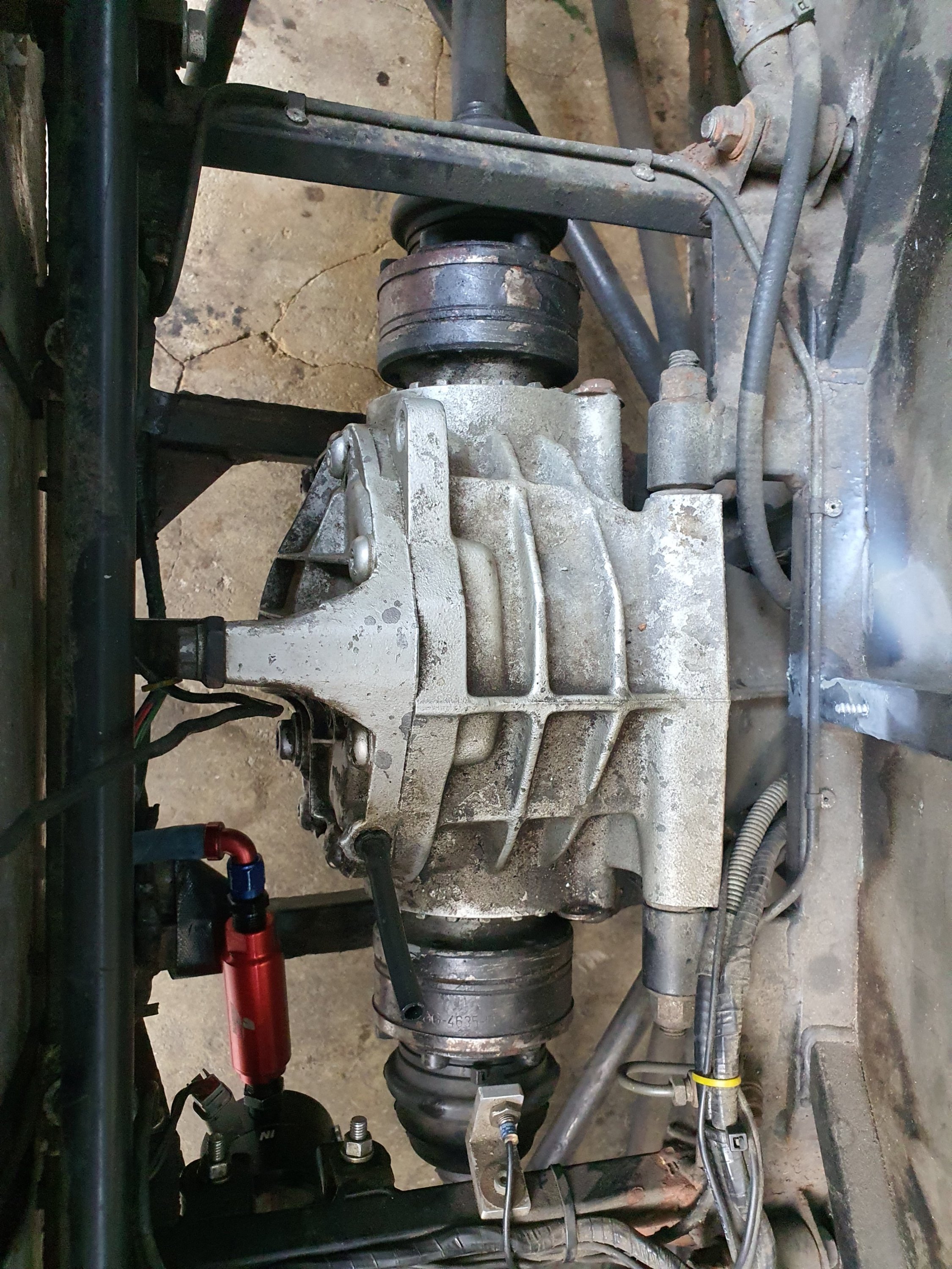

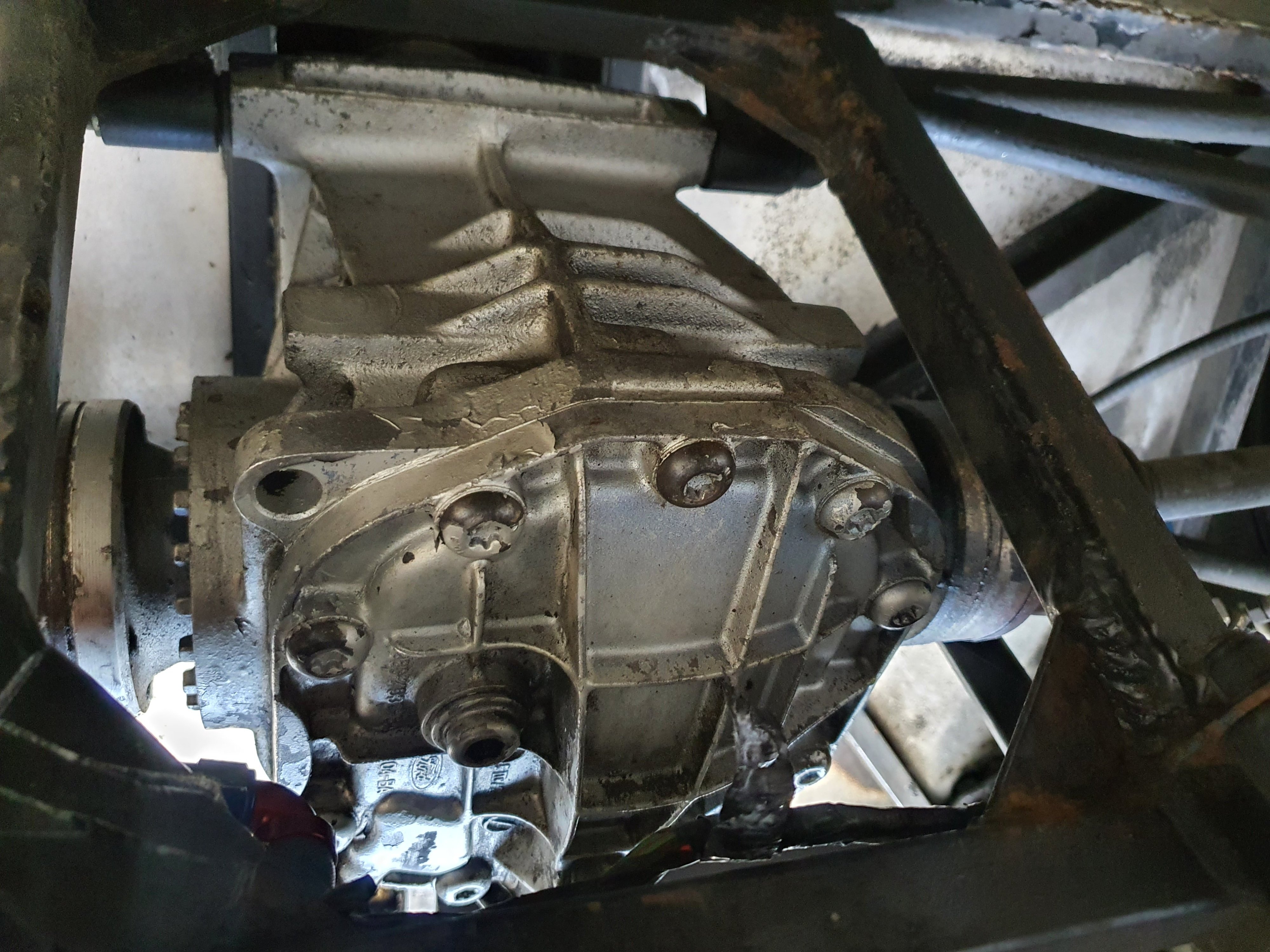

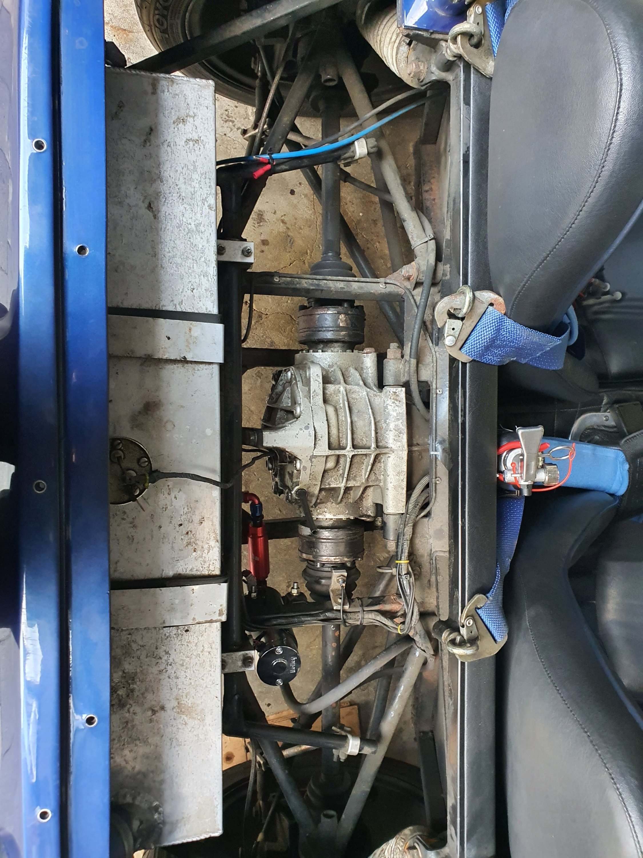

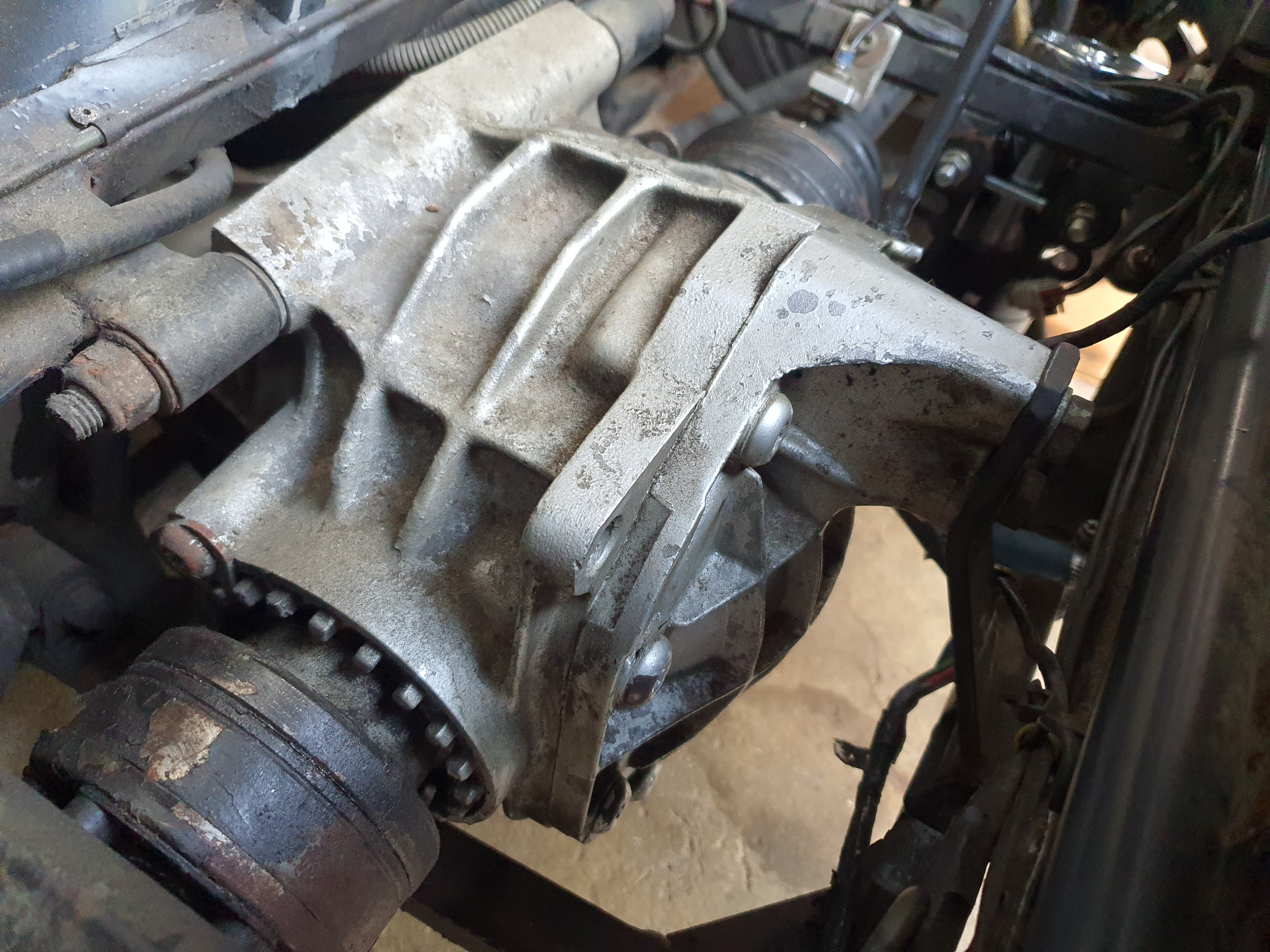

I've attached some pics of my diff but how no idea on models and ratios, I'm totally new to the westfield world
Hi guys,
Did the pictures not help at all?
I have a 3.36😀
The pictures only tell so much.
It looks like a 7 1/2” diff, as there’s no spacer on the top mount, but the trouble with these Sierra/Scorpio diffs now, is they’ve been around for so long, that many don’t necessarily have the same internals they started with - swapping parts to make the right ratio LSD version etc has been common.
You really need to work out the ratio, count input turns against output turns, to calculate it.
