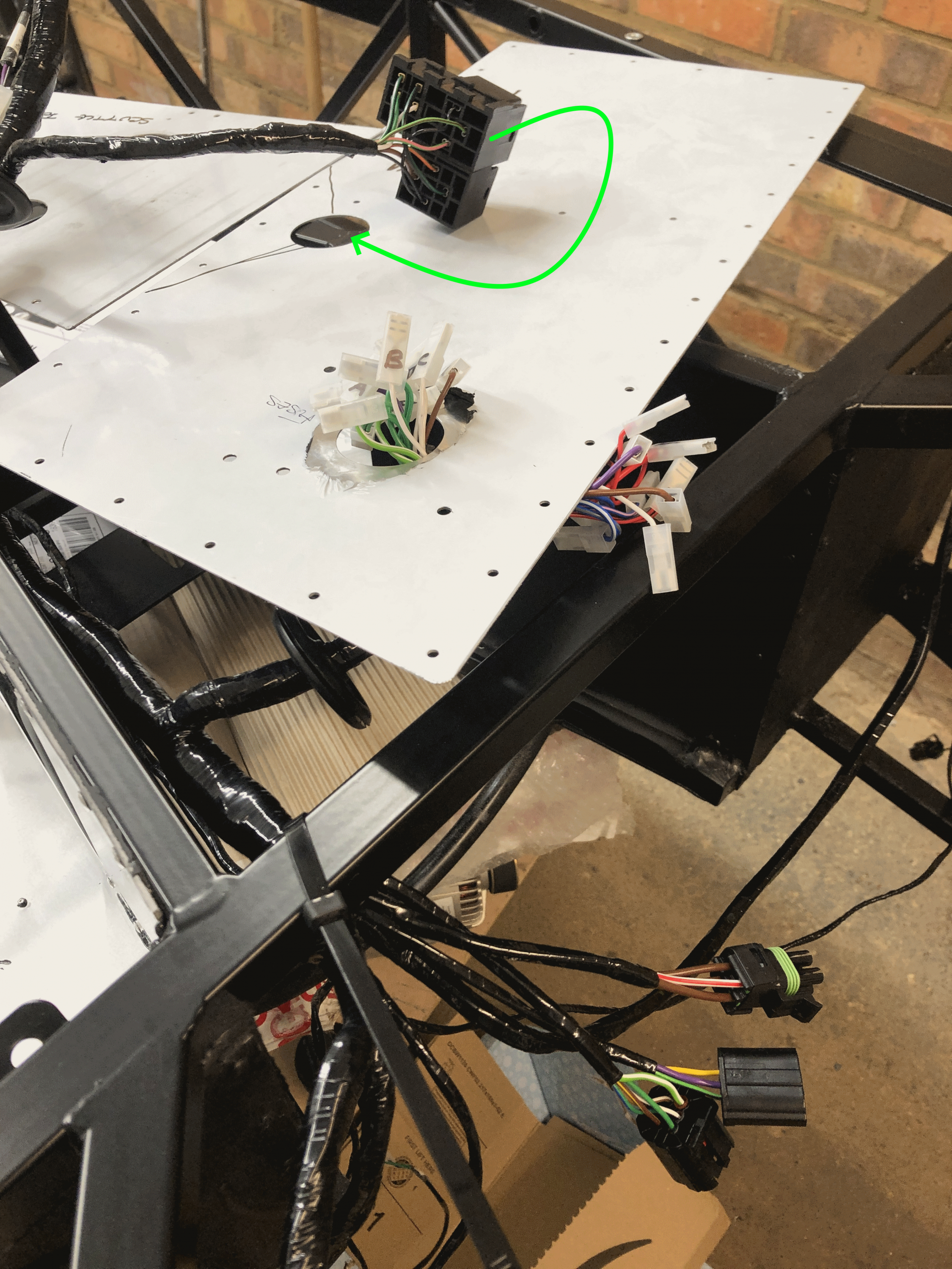

I'm trying to build a 2019 FW, kit collected October 2019, from a 2013 manual. Several expletives are deleted at this point.
OK. So I believe that the fuses go through the left hand hole in the scuttle plate. Does anyone know where the other block goes? I've shown my fear that it goes through the other scuttle hole - green arrow. Please say this is not so. I really don't want to take the blocks apart and feed the whole of the dashboard and rear loom through this hole.
If not, where does the block and the grommet on the main bundle go?
Thanks in advance,
Gerry (in Hertfordshire)

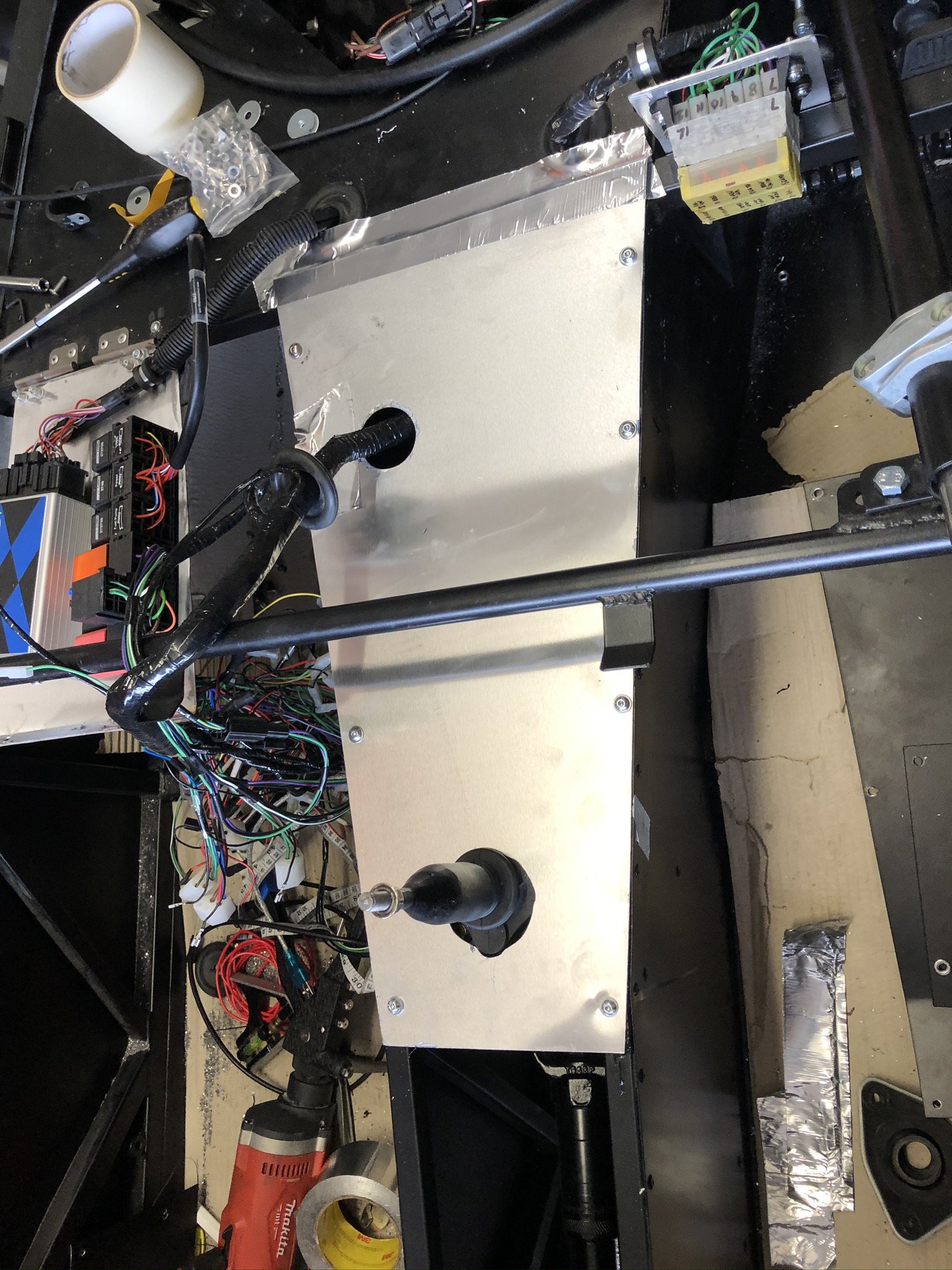

Here’s a pic of mine for reference
looks like your ok. The hole you have left is used for the ecu to engine harness

Hi all,
Thank you for your - quick - responses, particularly Si with the picture.
Looks like I will have to take the wires out of the multi-block with relays (or whatever they are). Does not seem correct. However, I will continue with a trial assembly until it looks correct.

yours looked correct they come out of the hole with the main wiring loom close to the dash and sit generally on the Ecu tray or wherever you want to mount them.
Althogh yours look like they are coming out on the right of the car rather than the left side
It's perfectly normal to have to disconnect the fuses blocks to pass them through the holes. The relays need to be removed from their holders, and where there are multiple holders clipped together, you will usually need to slide them apart, but they will fit through the openings without further disassembly.
To a degree your in an area where there aren't hard and fast "rules", the bare building blocks are provided for you, it's up to you as the car builder to decide exactly what route you want to take, as so many builds are ever sol slightly different to each other, as the builder adds various personal touches etc.
