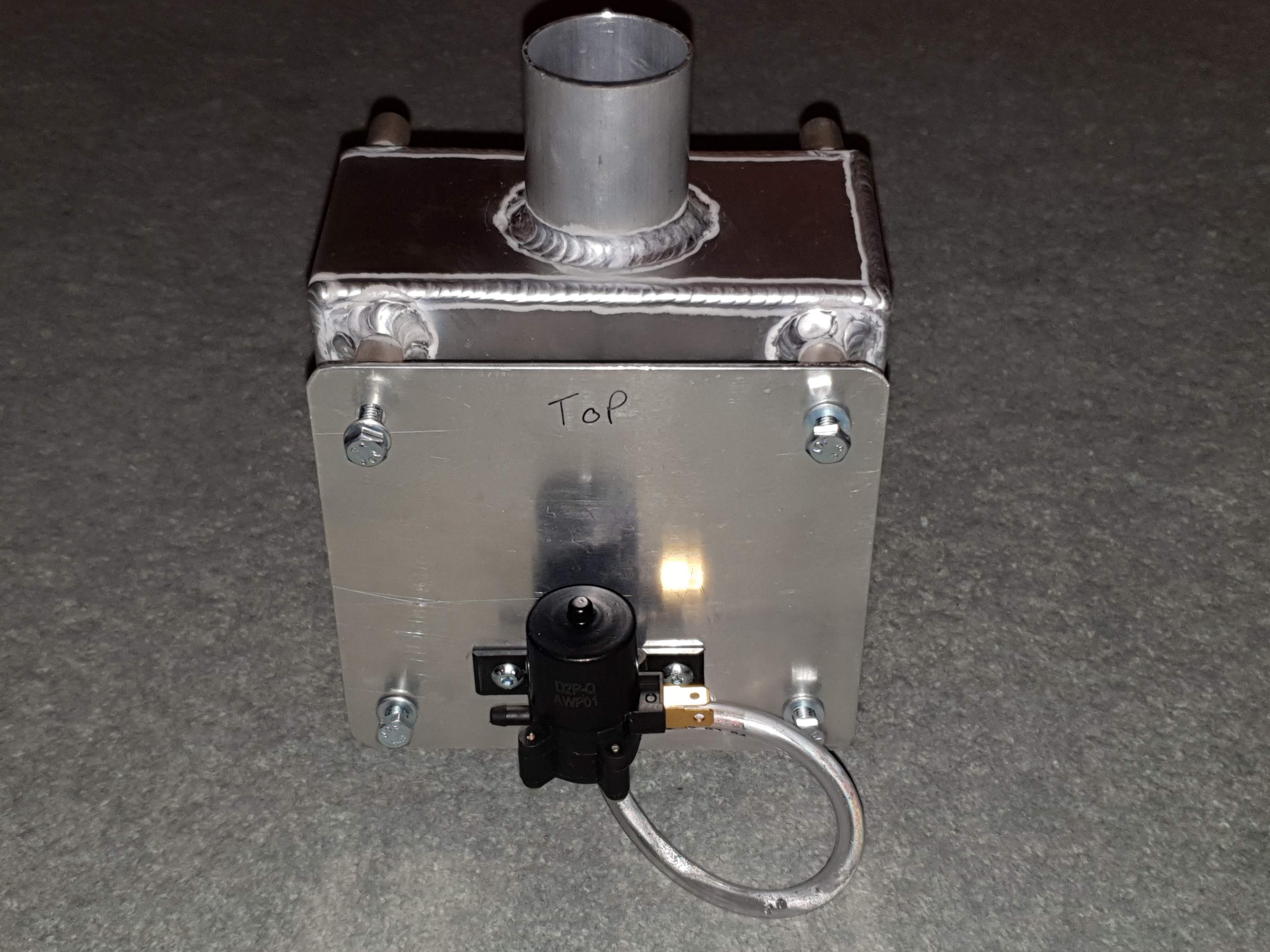

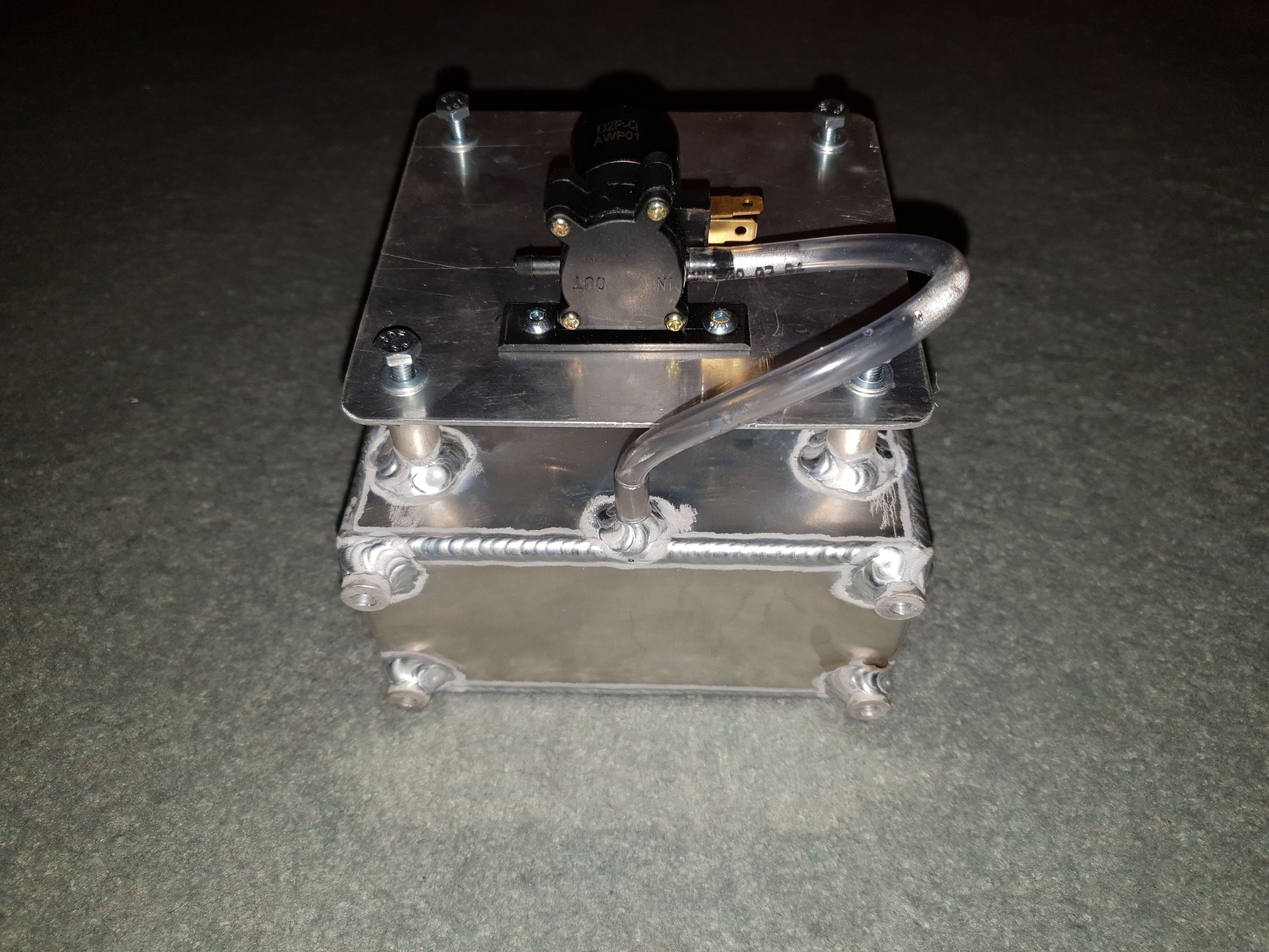

Part of it yes, it's just dry assembled at the mo, before I get it powder coated.

I’ve designed a tank that will fit inside the cockpit, at the end of the passenger footwell, (it’s going to be protected by a footrest, which Gareth is also making).
It holds about 1.5 litres so being a little paranoid(!) ive had four mounting bosses on the bottom of it, to bolt through the floor, but also a couple of extra long bosses on the front, that will bolt through the bulkhead. (They’re extra long, as my chassis is one that came with both right hand drive and left hand drive pedal mounting brackets. I cut the main parts of the brackets that stick out off, before I paneled the chassis, intending to do this mod then, but for one reason and another never got to it. However, I still have the metal plate that the MC’s bolt to, so the bosses help clear that.)
I’ve used a sepperate pump, (eBay!) mounted on a front carrier plate, for ease of service/maintenance.
And of course, my design has no lid on it!! The filler spigot is a sepperate piece, which I got Gareth to weld a mounting flange on to. This will then fit through a hole, (sealed, of course), and stick into the engine bay, for topping up the screenwash.
As I say, he actually made it almost before I was ready! Very pleased with his stuff, deffinately be back next time I need anything fabricated.

Thanks Dave, looks a tidy job he did there..think I'll need to get the tape measure out and see what I can do...
