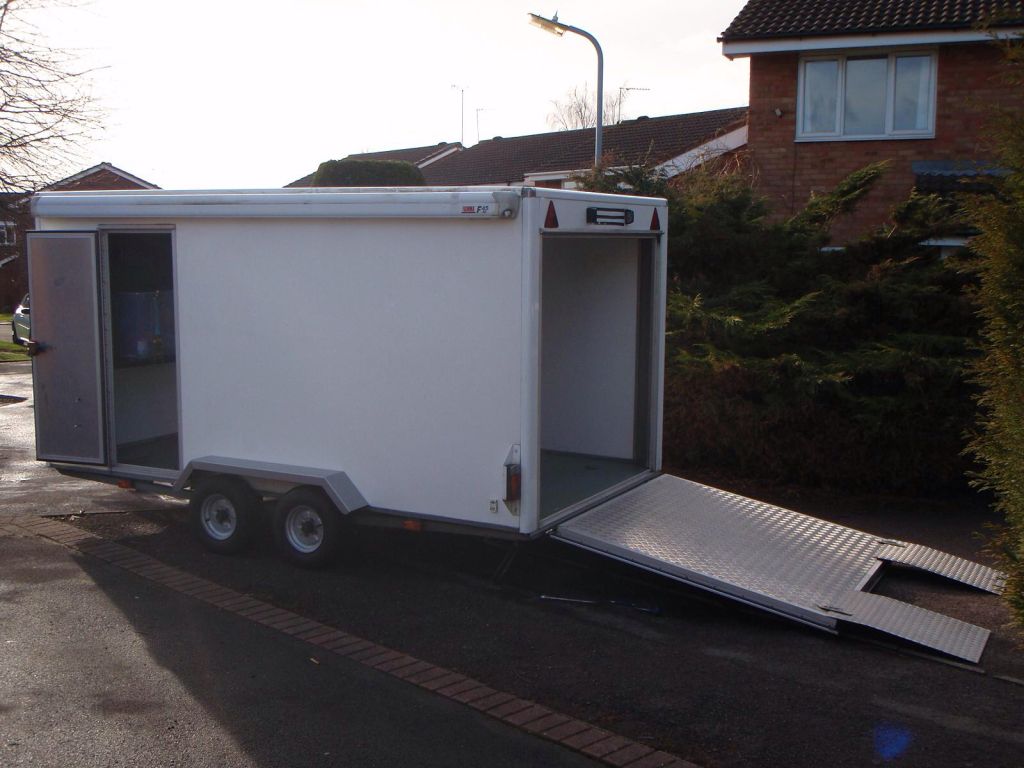

Barry Ashcroft Posted December 27, 2014 Posted December 27, 2014 When I bought mine all 4 tyres 145/10 were perished. But changing to a more common size 5.00/10 saw me buying wheels and tyres for £38 each Quote
Fordboi Posted December 27, 2014 Author Posted December 27, 2014 Thanks for all the good advice. That's some trailer Barry! I like the look of these minnos. There are a couple on ebay but at 1,250 and still rising so quite pricey. I'm torn between one of these and a slightly bigger BJ clubman. I don't really need the bigger trailer but its there if i were to need it and makes it more versatile. Storage isn't an issue so I'm not too concerned with the width. Mmm decisions.. Quote
