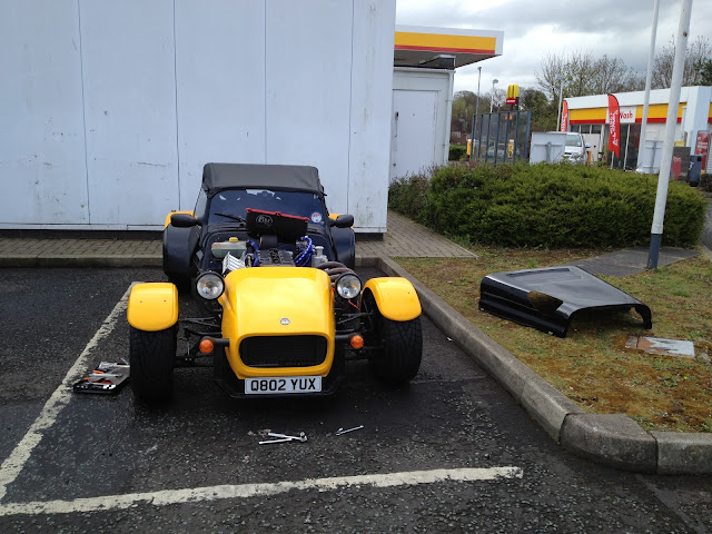

Trust me, would have far rather been there!
Pulled into the Shell garage in Congleton about 8.20 am, total electrical failure when I came to restart, finally admitted defeat about 8.45 and rang Chris.
By 10.45 I'd found the issue an rigged up a temporary fix. (Having walked up to Halfords and bought some spare battery leads and stuff).
IMAGE_3CC153B4-DC3A-4327-A73A-19FFE24909
Not where I wanted to spend a few hours on a Saturday morning!
But thank goodness it did it on the petrol station forecourt. Can you imagine if I'd suddenly lost all electrical power halfway through the tunnel!

No ground from battery to chassis. Never been too keen on the rack mount bolts as the ground point for nose mounted battery, but it's worked fine up to now - went to Three Sisters and back only the other day. But now absolutely no continuity. (Initially thought it was the live to starter run as it seemed intermittant - then realised the cheap continuity tester in my in-car tool kit was falling apart :laugh:)
Rigged a temporary lead up from the battery's negative terminal to a manifold stud. (The only non suspension pick up bolt i could reach with the (short) battery leads I'd been able to buy at Halford's round the corner).
When I removed the ground wire at home i also noticed that the copper seemed to have frayed out of the crimped on eyelets slightly - though by no means enough to reduce the current much. So as I also bought some new eyelets this morning i've just replaced them.
Refitting everything to the car now and clipping wires back up.

anyone can park there car up and take the bonnet of then take a picture , that was from last year wasnt it fair weather
Link to comment
Share on other sites
:laugh: I'll have you know that took hours in Photoshop; I even got the shadows right ;):p :p :p
