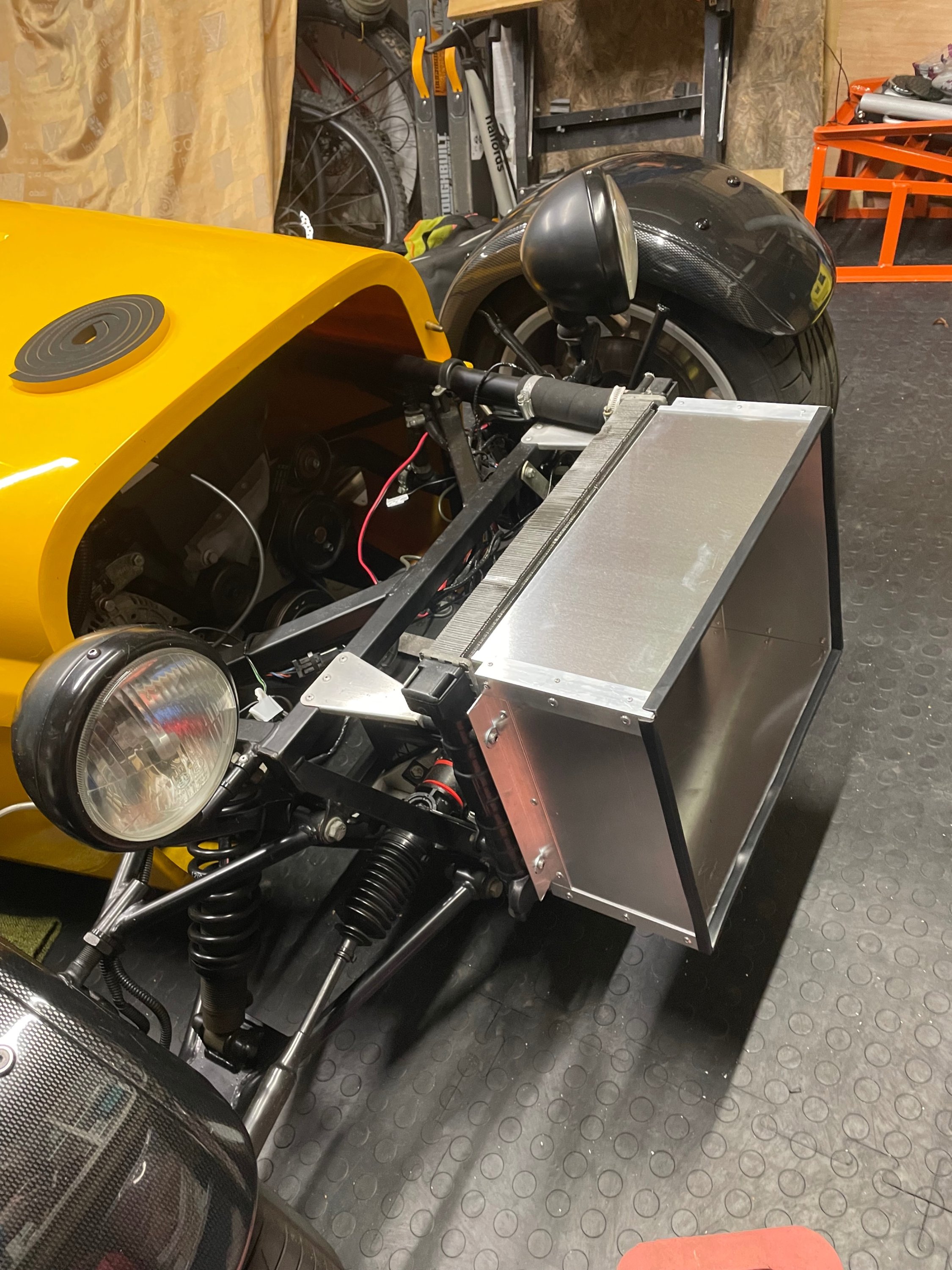

Buzzz replied to DamperMan's topic in The Start Line
Just finished some ducting for the rad and sealing the joint between the fan and rad due to the bracket. Hopefully a lot better cooling when needed. -
