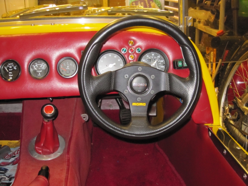

I change boss, mountney m range 300mm and a 25mm thick quick release.
7BC21AA8-8C63-4F70-A8A9-CC0B37614BCB-507
See the clocks fine
42A3D9E2-06A6-432F-9583-0D5EA9C37780-184
Only 25mm thick
70C2CF75-B299-49DD-84B3-4CF2F30378F3-184
Not much left on steering wheel. The wire is my own addition, there is a horn plate, but small contact area held together with springs I thought would wear in time.

Where did you get your surround for the gear stick gaiter? I like it.
It's an iPhone cable... Not normally there, under that is a nice chrome one I got from eBay or Europa spares. There's a matching handbrake surround too, really finishes it off.
Youa can just see it in this picture... I would get a better one, but it's cold out there!!!

Did it just glue to the carpet?
God no!
It's a solid chrome ring with 6 holes in it. The handbrake one is a oval with straight sides, again 6 holes in it.
I lined mine up, drilled six 3mm holes while it was in place, then got some bathroom mirror mounting shelf tappers with chrome caps and screwed it in. Over the top of the carpet and through the gaiter to hold is in place. Same on handbrake. Took less than 15 mins each.
