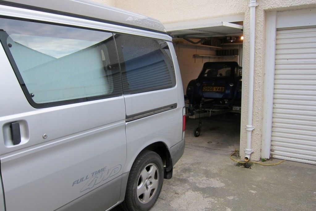

Here is my setup:
Ready to run tomorrow...
From the pictures, it looks like your not using wheel straps, but standard straps passed through the wheel
I found the wheel straps better as it holds against the tyre so no rubbing on the wheels when towing
Maybe an option for you later
Wheel straps are a must, and they're not expensive.
I'll ratchet them down in less than 2mins, then take a 300k Ferrari across the country without even bothering to check them.
Used with wheel covers, they'll do no damage either.
Trailer balance etc has clearly been covered, so you're well away.

I always load engine first buddy as per Brian James instructions - there is a very good VOSA document on towing somewhere... :-) nice wheels mate
I thought the engine should always be at the tow-hitch end (IOW, yours is the wrong way round!) That's what I've been told, and how I've always towed my TVR and the Westie.
(I have a Wessex 4 wheel beaver-tail I tow behind a Disco 3. I have wheel straps which I got from Brian James, and I cut them to length (and singed them) once I'd worked out the best way to strap it down.)
Will have to lookup why it should be engine first. I was just focussing on getting the weight right and thought you have to go backwards at some stage so why not up? :-)
Update. Seems the engine-forward advice is based around making sure that too much weight is not at the back so you don't get trailer whipping. As I have mine balanced with 70kg at the front it should make no odds.
