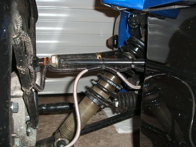

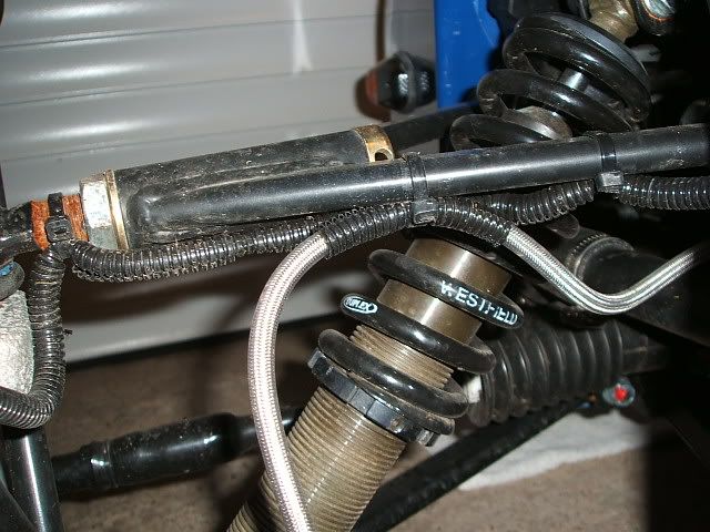

I got my flexi hoses under control by cable tying them to the wishbone in one or two places, but not directly. Separate the wishbone and the flexi with a length of small bore rubber hose, a few CM long, through which you thread the cable tie. Not easy to describe but I can post a piccie if you want.
Think I know what you mean, but a pic would be really appreciated. Thanks
Here you go...
Ahhhh. That's novel.
Will give it a go, it's only the very last part of full steering lock to to the right, so hopefully it won't take too much footering!

Neat, I like that :t-up:
Or
Mine too:
