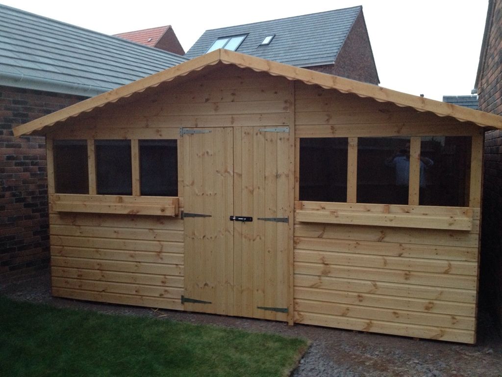

Well the shed arrived today and was installed in double quick time. Need a couple of days for it to settle then can start insulating and shelving it!
what colour are you gonna paint it ?
I think I will leave it natural as it fits in well with the garden

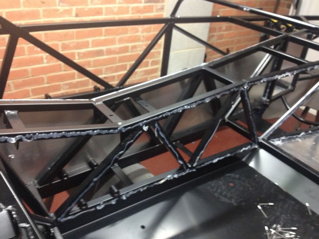

We then proceeded to put on the driver side panel and back panel, plenty of silicone and a little tip don't try drilling into a circualr bar as it just won't work!
Working out which way to put the back panel on was a little confusing but I worked it out in the end. One thing I forgot to mention were that all my panels were pre drilled so made it a lot easier for me. Thanks Westfield!

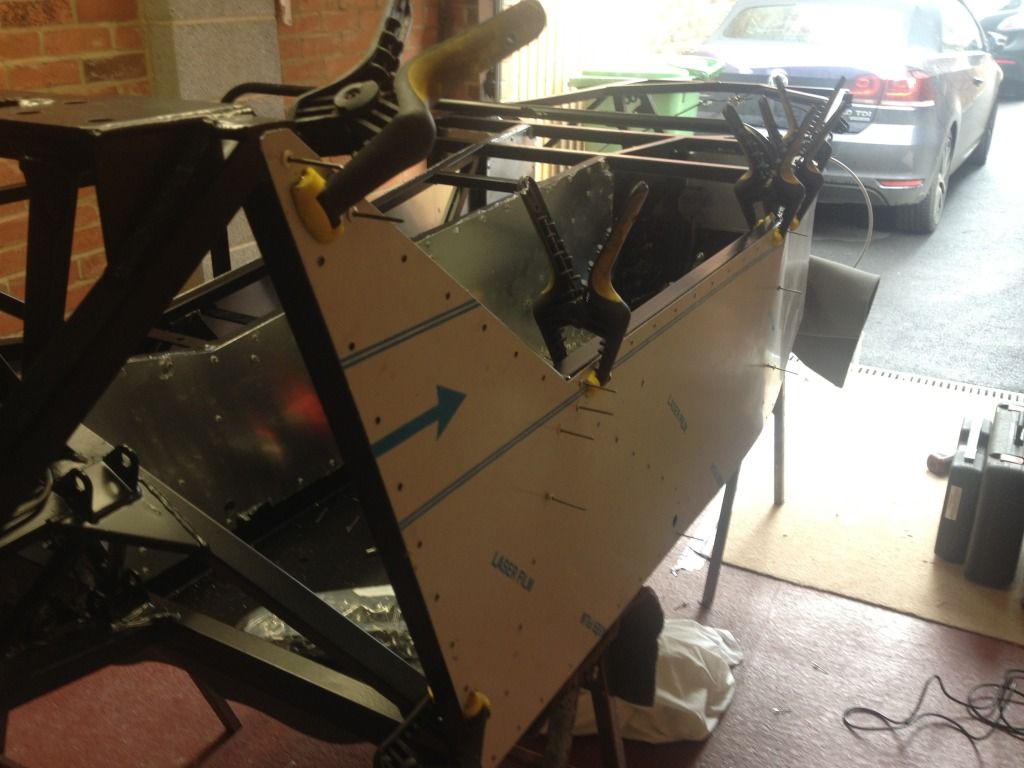

Monday 22/10 I got home as soon as I could from work and my good lady even helped me with the build. She was concerned that everyone else was getting to help and she wasn't so I enlisted her help. Monday evenin we proceeded to put on the nearside panel with all 90 rivets which also included a 17 minute dash to and from B & Q to buy some more drill bits as the panel was 1/2 drilled at the time and at 2035 the last bit broke. With B n Q closing at 9 and it normally being a 10 minute each way trip I am surprised I got there, bought bits, and back home in 17 minutes. After then cleaning and siliconing again this was the picture to close Monday night.

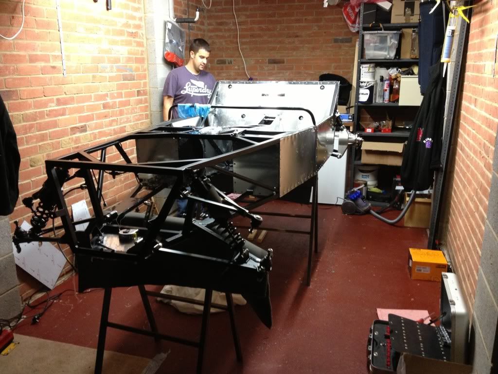

We then moved on the rear suspension which went if fairly easily (well when you have a highly skilled mechanic mate and an expereinced Westie builder!)
Didn't have the diff so could only get in the suspension arms, wishbones, dampers and hubs.

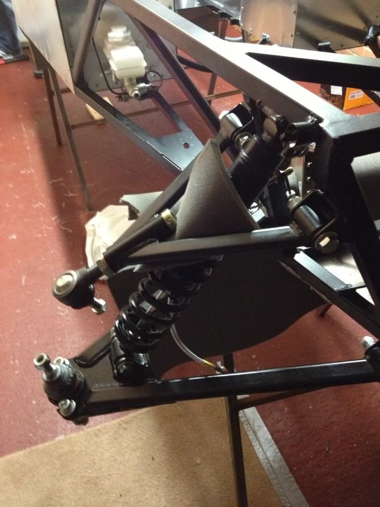

We then moved onto the front suspension but one thing you quickly learn to adapt to with a Westie build is shortages, now what bits could be missing?
Which rounded off another nights successful building

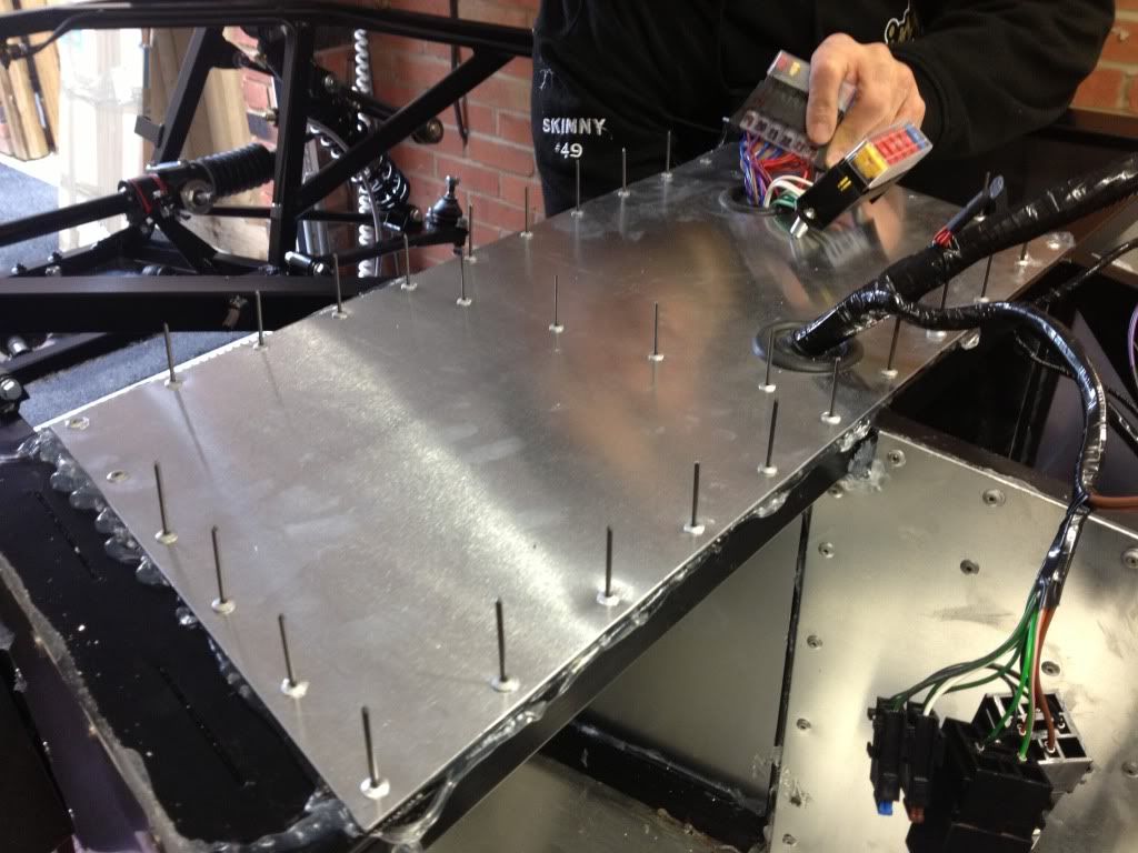

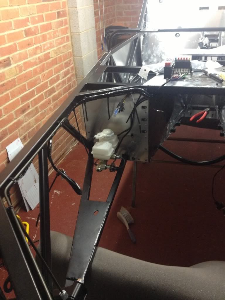

This weekend we started on getting the brake lines and wiring loom in. We started putting the tunnel panel riveted in (I swear if I never see a rivet gun again after this build I will be a happy man! - although thats Kev getting right in there in this pic)
We got the cable ties holders riveted in and ready to get the loom tied up
