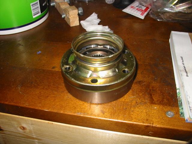

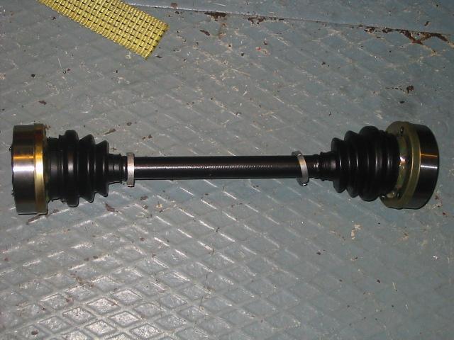

Mike-SEiW Posted October 22, 2003 Posted October 22, 2003 I don't understand the problem. Just remove the lock-clip that holds the CV-joint and pop off the joint with the metal "cover" intact (lobro joint if you like). Then remove the metal clip that holds the rubber boot, buy new ones, put them on and slip on the cv-joint, lock it in place, grease it up and then fasten the new rubber boot. There are some pictures of this installation and the parts I had on my build on my website. I did have to buy those metal covers (dirt shield) from Westfield (Ford doesn't have them), but otherwise, no big problems. Metal cover (dirt shield) on CV-joint: Rubber boots on before both cv-joints are put in place: Finished item: There are more pics at http://www.kallerman.com/westfield under the entry dated "2003-10-04 & 05" Doesn't yours look like mine? Should be very similar. Mike Quote

Mike-SEiW Posted October 22, 2003 Posted October 22, 2003 Yes, on one end it was harder than the other, that is correct. Wasn't so hard, just banged it with a piece of 2x4 wood and it went on. The metal covers were hard though to put on, diameterwise about 0,3mm smaller than the cv-joint outer diameter. That is why you see a hammer next to it in one of the pics up top. Quote

predawson Posted October 28, 2003 Author Posted October 28, 2003 When building a SDV Westfield, Sierra drive shafts are used and the circlip is not accesible. I have now managed to find driver shaft "cans" that can only be removed by damaging them. They can be purchased from Ford dealers and I have the part number is anyone would like it. Quote

Vogalogue Posted August 5, 2018 Posted August 5, 2018 Old thread resurrection! Can anyone point me to a supplier for CV gaiters that looks like those? I got generic sierra cones off Ebay, and they metal "cap" was too long, as was the boot itself so the ribs will rub as I drive and I don't expect it'll last five minutes... Failing that the ford part number for the "cap" and boot would be ace. Cheers. Quote
