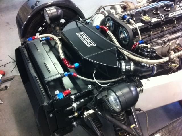

Not at all. Its on a T34, would be a pussycat to drive off boost with nice and pretty progressive powerband.
Because Westys are so light, they dont make full boost in 1st or 2nd gear. That would only be pulling 2 bar and making big power in 3rd onwards so you dont get the traction problems you think you would!
I think it looks a really well spec'd car. I like the fact its apparently got a big intercooler as heat management is key (especiallu if you wanna track it)
a 400bhp is just not the scary animal you would think it is. I had a car of very similar spec before I went really power crazy... mine was a nunney cat on the road and really usable.
Yb engines are VERY VERY strong as standard... they get let down my old parts like injectors, old wiring looms, old sensors..  or anything that causes the engine to run lean... and melt under boost.
so if you do buy it... first job. Get it to a Cosworth specialist and get it run on some rollers to check the fuelling.

i had a pax in a 340ish one,dunno tbh-prefer a 220-250bhp nasp car,preferably a well spec'd duranail car.the fella who owned the one i went in had heat soak problems even with a custom cooler and could only do 4 laps b4 he had to pull in.2/p
Its very handy if you let other people drive the car like I do ;)
Valet mode :)
What was getting hot? water temps or charge temps?
did he have custom rad or custom inter or charge cooler?
A std 4x4 Cosworth cooler can easily cope for endless laps with 350bhp from a T34 if you get some decent airflow to it!
I used to lap HARD at full chat until I ran out of fuel in my 380bhp ish Westy.
It wasnt until I went for around 500bhp that I needed to get serious about cooling....

you don't NEED big power in a Westy to have fun. FAR FAR from it... but 400bhp from a YB doesn't need to be unreliable or unusable and it isnt the scary monster you would think!
I wouldnt do it again though if I am honest!  would just get a naturally aspirated Caterham R500 or CSR.  Would have been cheaper and a make alot more sense financially! and be less of a pain in the A*** as bits are on shelf and not all one or two offs!
