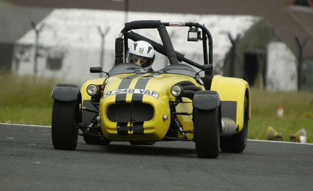

I have a second hand custom made bar that would fit the bill. It could do with a like of paint but it would be high enough to do the job for all but the most lanky. I could be tempted to part with it. ;)
Matt...............your supposed to put your undercrackers round your nuts,not under your helmet  :oops:  :laugh:  :laugh:
stew,on emms login  :devil:  ;)
I dont where any Stew ;)
