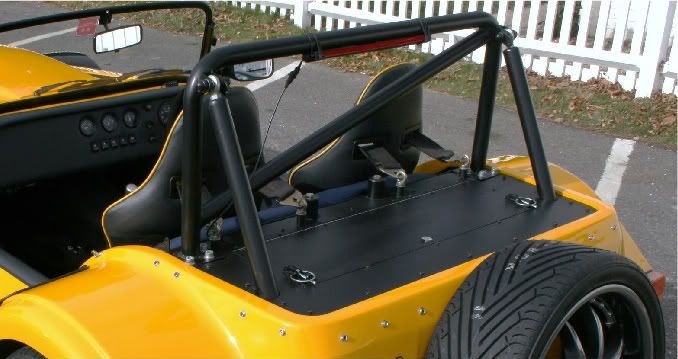

I couldn't cope without a boot for long, this is my attempt. It's not as big as the standard boot box, but it's enough room for clothes for camping (tent straps to roll bar), it's lockable and I think looks the part ... :

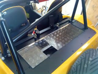

All made from sheet aluminum - quite thin, with some ribs running underneath to stiffen it. Piano hinged lid, yale cabinet lock in the centre and two mini bonnet pins at the edges (prevents the lid being forced up if it's stuffed full) with rubber seals so it is waterproof (well, splash proof at least). The inner box is made from thin alu 5-bar tread plate and has an inspection hatch through to the diff and fuel pump and level sender. Where possible the box is formed from a folded 'net', and either welded or rivetted to 90deg angle strips. The relatively thin aluminium was later covered with sound deadening (like the hifi stuff) to stop it 'drumming'.
And inside: (sorry, pic before I was finished)
