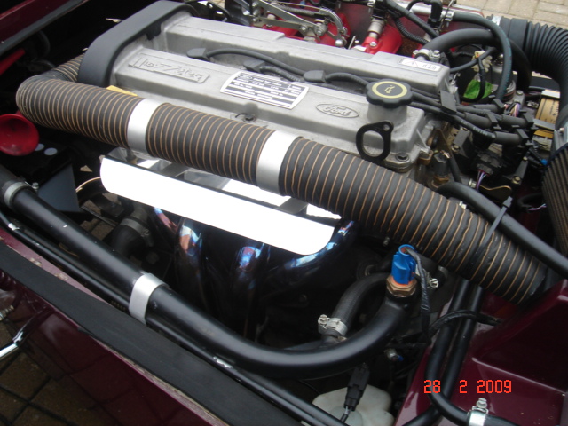

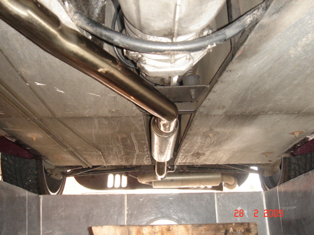

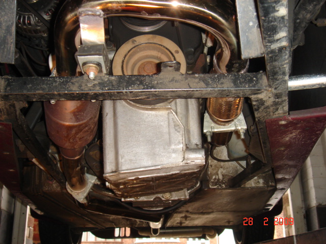

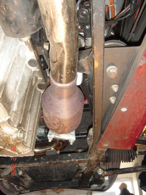

Here is the underslung exhaust of my ZEI, placed by the previous owner (custom made). The engine is a ZETEC. May help even if it's not a Mazda SDV
