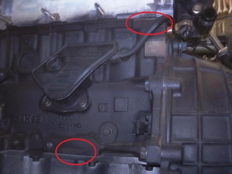

Here is a picture off the side of my engine.
The top right of the main block in red says G305A 2 2 2 2
The bottom of the block also circled in red has 021035607
Both are the only bits I can find that are stamped on the block.
Top left not shown is where I found the other bits starting in RF94B... and they are forged onto the block.
I cannot find anything else on the block at all???

the engine number should be above the thermastat housing on the head. thats where mine was anyway

If it's on the head, it aint the engine number... ;)
As it is/was probably supplied as a 'crate' engine (or industrial unit as Ford liked to describe them), it is unlikely that it was actually stamped with an engine number.
'Ford' engine numbers, until recently at least, have always been the last seven digits of the car it belonged too. If it was never fitted to a Ford, it wouldnt have a number... :(
