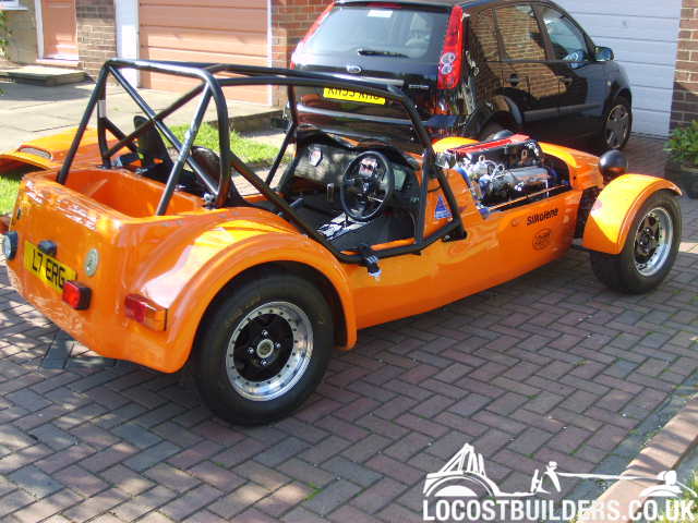

Well its finished, final spec
A special MAPTUN ecu tuned for the westy, MAPTUN sweden is one of the best tuning houses for saab engines out there, they have lots of experience with these engines.
Nitron shocks all round
fuel injection
swirlp pot
walbro 392 fuel pump
forge dump vale
forge actuator
BEC chassis
new BGH E7 gearbox
new CSR high powered electric water pump
davies craig small electric water pump for the charge cooler system
image 3 piece wheels
yokohama 048 tyres
front anti roll bar
rear anti roll bar
ali uprights
brmbo 4 pot front brakes
oil cooler
polo rad with high powered fan
charge cooler rad
new PWR chargecooler
full silicone hoses in blue
carbon dash
new full caged cage roll cage
race seats
new 5 point 3" driver harness
new 4 point 3" passenger harness
new race technology DASH2 dash
quick release steering wheel
cossworth 7.5 3:18 diff
new hydaulic clutch
new clutch plate
saab aero pressure plate
boot box
etc.etc
I drove it this week and it moves lol, I couldn't give it full beans as the gearbox is brand new but its plenty, not been above 4k yet.
here are some pics

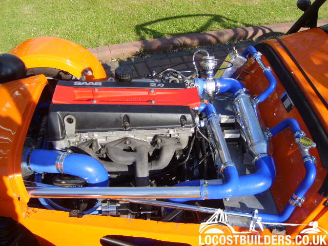

Is it dry sumped aswell?

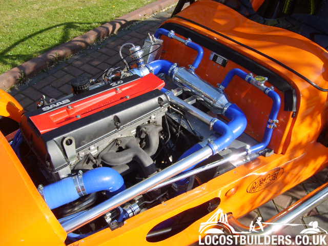

Lovely job nice to see someone go an unusual route re engine, looked a bit of a squeeze or was it ok, must have done a lot of research b4 fitting it. Wot made you decide on the Saab lump in the first place ( I,m sure its been on here B4 but cant find it)
Mike
I had massive help from the guys over in sweden, especially tourqueman, he went way further than the average guy would to help someone he 's never met before, so a big thanks to you Patrik.
It is tight but very do-able, 285bhp is just on standard engine / turbo, you can get up 500 bhp with no internal mods theres one on you tube with 850 bhp in a 9-3, so upgrades are as cheap as chips, best thing is, if you do blow the engine, its only a couple of hundred quid for another one.
