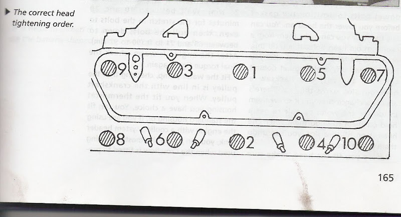

Can anyone let me have the torque settings for the head bolts?

Do you know the tightening order? If not I can scan in it and post.

No I dont have the tightening order. If you are able to scan the page and post it. That would be great
