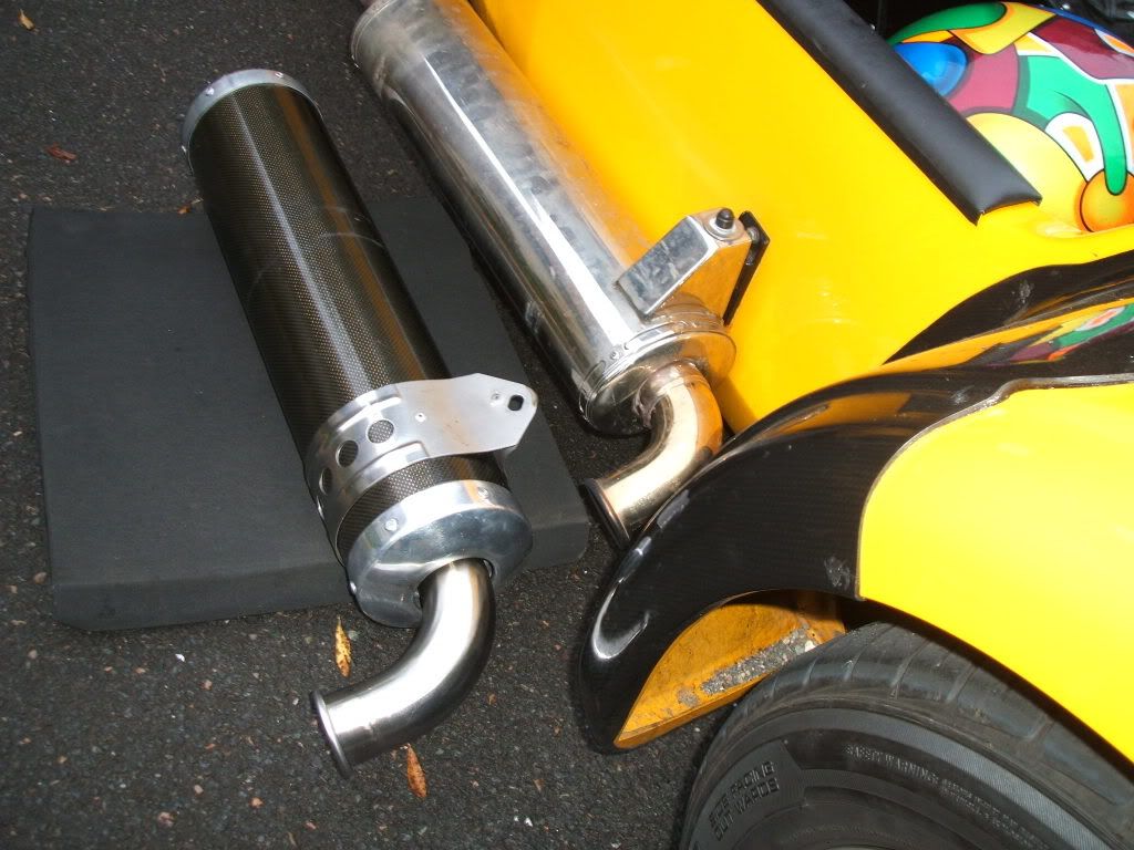

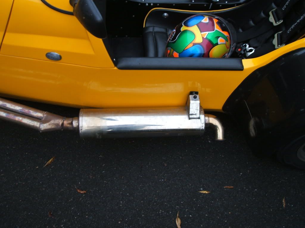

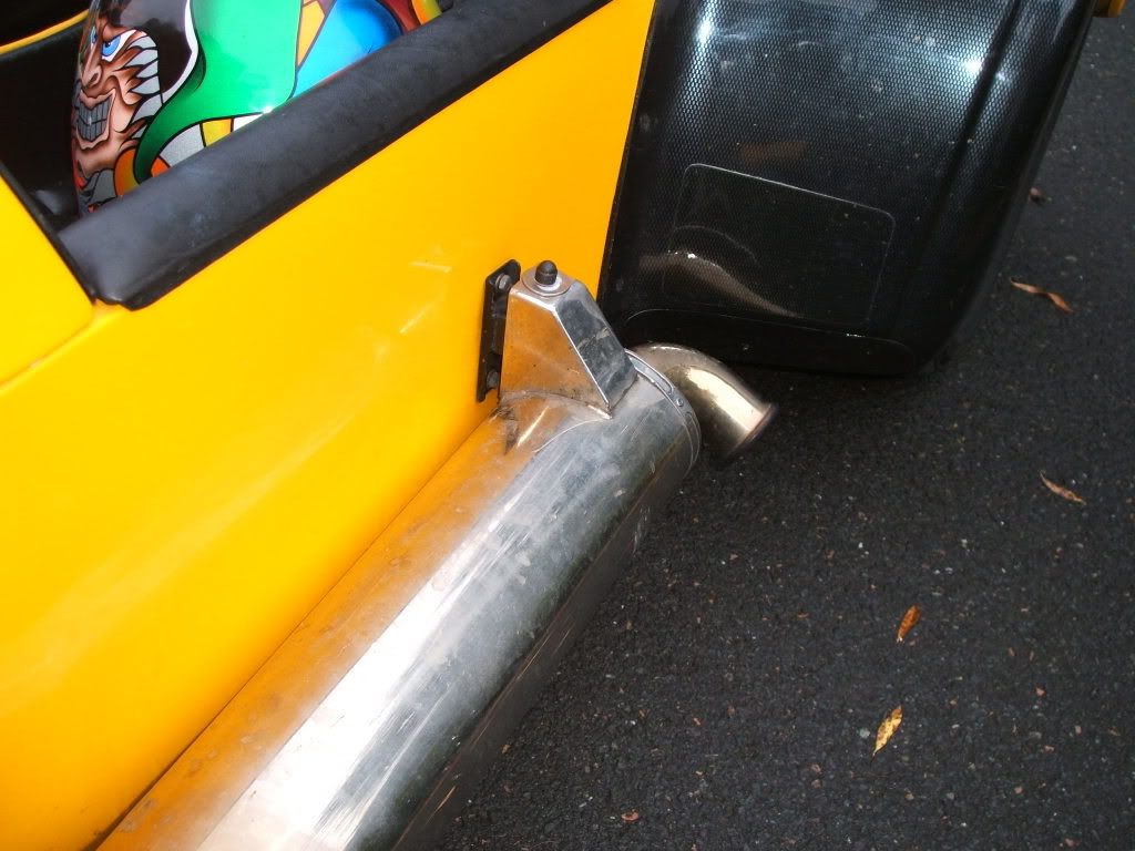

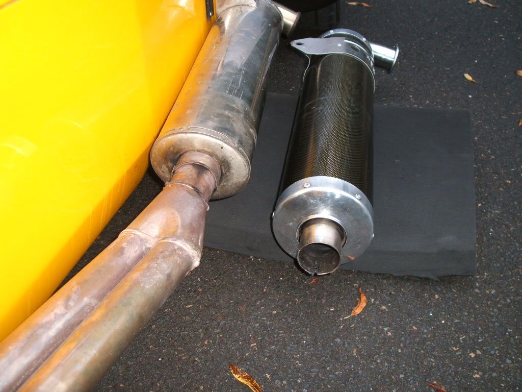

These are a couple of pics of my setup. Like I say I have the megablade and as far as I can tell the Westfield supplied silencer is just a motorbike silencer anyway.
The can is a standard R1 exhaust (as carbon fibre finished and my R1 was quite queit) that I had a exhaust specialist add end pipe and connectiong pipe for £30.
I then moved the mount (that is riveted on) so that I could still use my existing mount. Therefor it changes over with just 2 bolts for trackdays if the westfield one fails noise. Have a search on here for R1 exhausts though as some people have found that they loose noise reduction if permanently on car hence why is swap only for track days.
Cheers
Eddie
That looks very close to your bodywork, has it caused any problems? :suspect:
