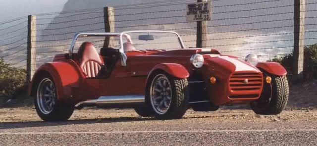

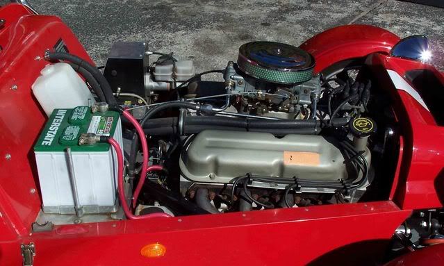

Specs
Ford Motorsport 302 Crate Engine, rated 320 hp
Transmission - Ford Tremec five-speed + reverse
Wheel base 2335 mm
Front track 1311 mm
Rear track 1330 mm
Overall length 3540 mm
Width                1560 mm
Tires, Pirelli P700; front tire 205/45ZR16; rear tire 245/45ZR16
Wheels, Image modular 16" dia.
Top speed recorded 135 mph
Best 0-60 time                 4.2 sec.
Best quarter mile time 13.0 sec.
Differential assy, Ford Sierra with limited slip 3.36:1 ratio
