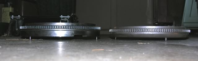

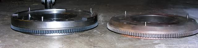

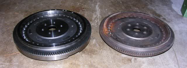

I think the1.8 is lighter, but there may be another other reason. Mate with tiger cat has used the 2.0 flywheel
yeh the 2.0 is a heavy b******* when compared to the 1.8.
I had a motor out of an auto (less chance of it having been driven on the limiter) so I 'had' to change it anyway
My 2.0 flywheel weighs approx. 22.75 lbs.
The 1.8 flywheel weigs approx. 18.5 lbs.
