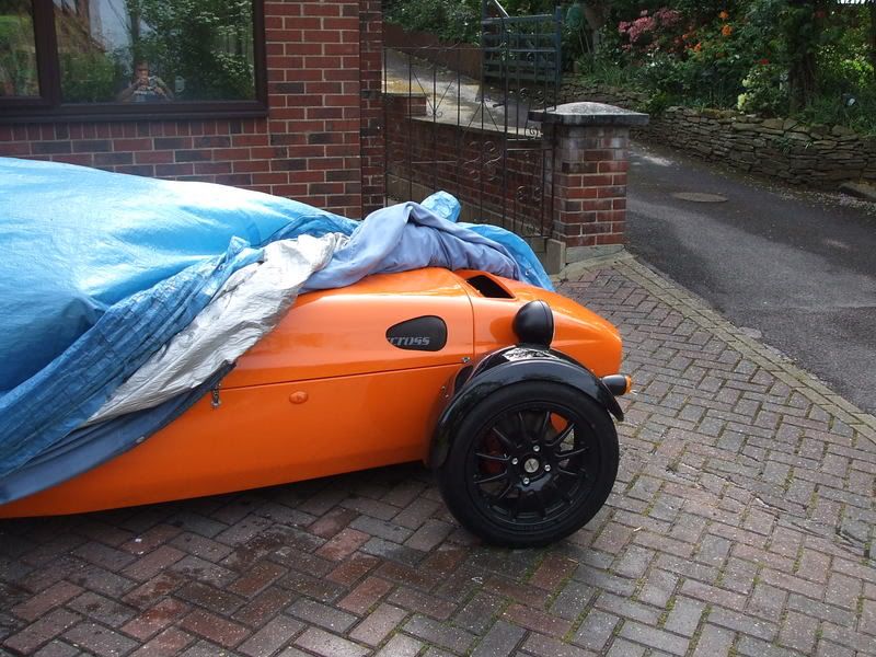

I'm about to put a sausage filter on a CVH, I've ordered a blank back plate so I can cut my own holes and therefore avoid contact with the Master cylinder.....

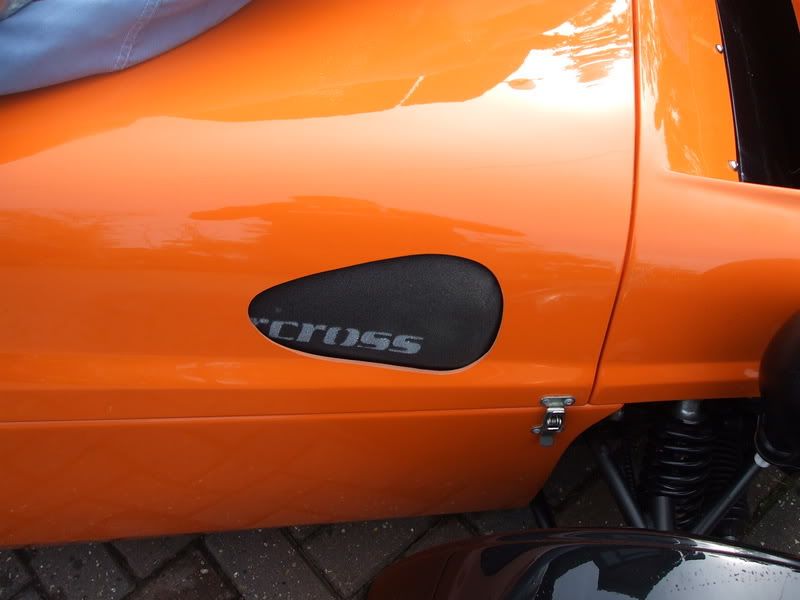

Just as follow up to this thread.....
I've now fitted my sausage filter and trumpets, and cut the dreaded hole in the car.....
I can confirm it makes a very obvious difference....the car feels like it has a little more pick up through out the rev range.....AND IT MAKES A VERY NICE NOISE :-)
The car is a 2'ltr CVH, so I had to cut out my own base plate (pipercross do a blank).....but it does fit (just without hitting the break master cylinder).......
The filter is 90cm inside and the trumpets are 26mm....

That is the neatest hole I've seen. Top marks . I really dont want to do that but I'm almost tempted, I planned on putting a blister snorkel on the side of the nose cone and then duct it to a angled filter box but the hole you made has forced me to think that maybe a side blister facing forward might be better - and give some ram effect at speed.
