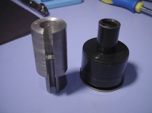

scott beeland Posted December 3, 2006 Author Posted December 3, 2006 Rubber bush (at bulkhead) has perished and was mushrooming out on pedal pressure (therefore losing some clutch action). I've had a nylon bush made up to replace it. Clutch cable eye would not pass through white plastic piece ( despite a good bit of heat softening) so I cut it off. I now need to replace it (and hopefully find a way of getting it to allow cable eye passage) so that clutch cable inner does not wear on it's way through the chassis Quote

scott beeland Posted December 3, 2006 Author Posted December 3, 2006 Not for now ta. But it might come to that if I can't get Gromits white placcy piece to go over the cable eye Quote
