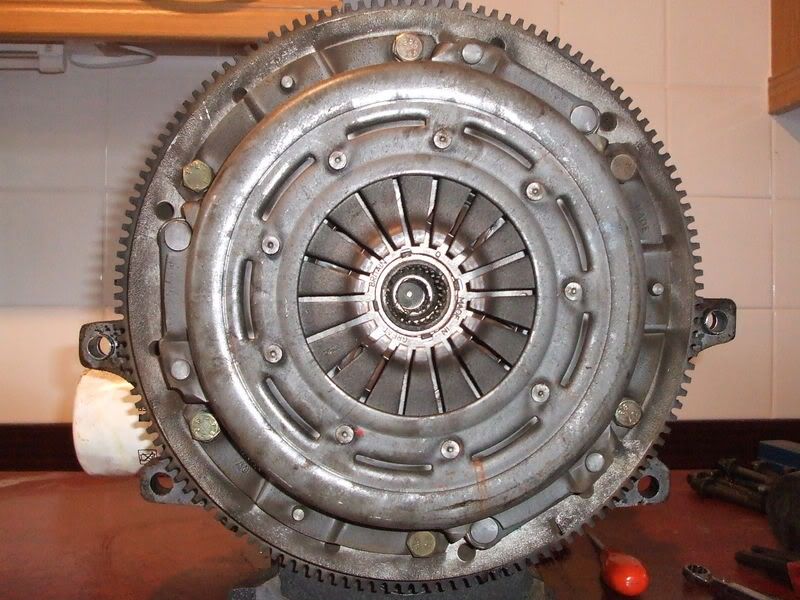

I have a cvh, but the clutch and flywheel are xflow......As I'm putting a 2ltr engine in my car, I have  replaced the clutch cover, and clutch plate for ap racing  items.....
The clutch is actually in good condition and the pressure plate is unworn having only done 7k miles....Yours for a tenna plus postage if you want to try it......See pic below for spline number (clutch is 190mm)....
Failing that, if you go down the ap route, don't expect any change from £180....

Spine number looks good ( i.e there are lots of them haven't counted).

OK , I'll check the spline count tonight and get back, looks like a sale !

Jenko, your clutch plate will have a 1" 23 spline plate for a type-9 5-speed  box, Hammy's 4-speed box wll probably be 7/8" 20 spline, suitable clutch kit will be Mk2 Escort or Mk3/4 Cortina (cover will be the some though).
I've counted my spines - difficult in a dark garage !! I actually counted 21 (certainly not 23 anyway) , but what RichB is saying is therefore probably correct and the clutch is not suitable.
