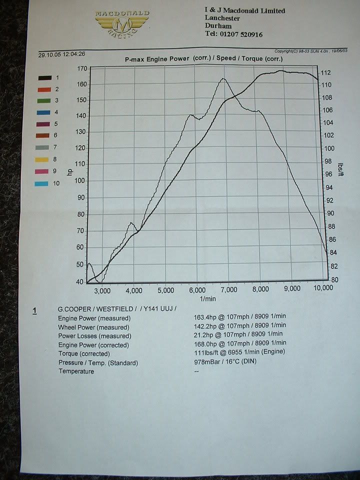

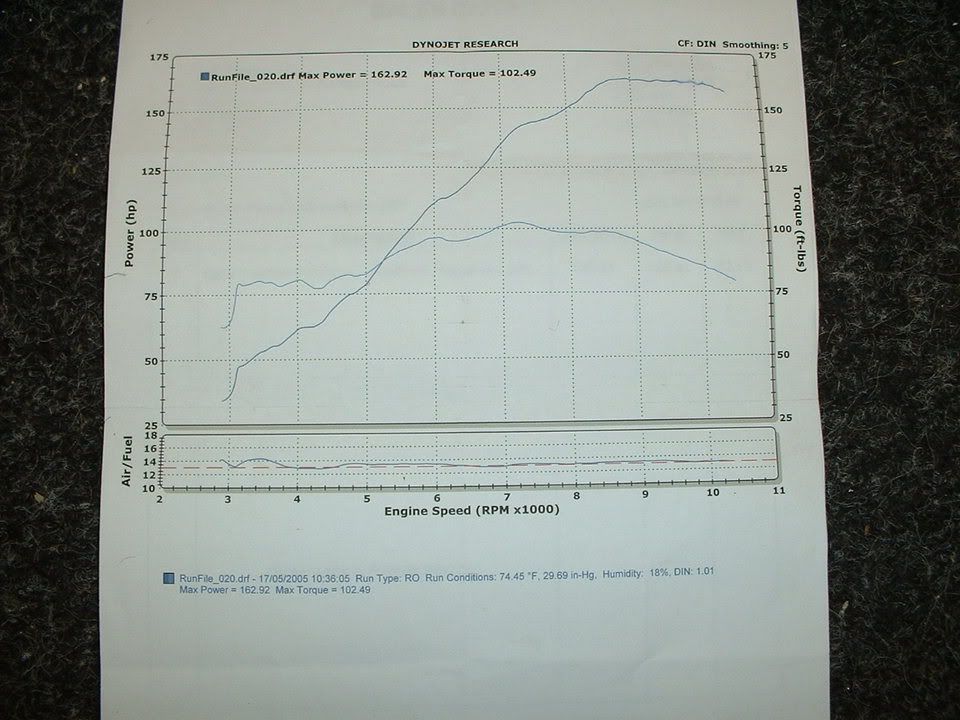

these are the 2 graphs for my car  from 2 different roads,both with Power commander fitted ..  on the 2nd graph Mcdonald racing only difference in the car was I had changed to a bigger exhaust ..
the first holeshot graph Jack said were  at the wheel figures... I was wondering if his road actually calculates at the engine bhp , but that would make most of the Busas only producing 145 ish so my  theory is prob wrong ???
Jeff,
I have to admit that my understanding of rolling roads and their difference is limited... certainly Jack seemed to think 145+ was about the norm at the wheels.
Do you have a reverse box like mine... would be interesting to know how much it takes out at the wheels.
Jon
yes westfield reverse box fitted to mine... It wasnt running My 13" tyres  at Mcdonald ,had to Put I think 15" to get it on the rollers  but I dont think that should have made a difference.. ???
