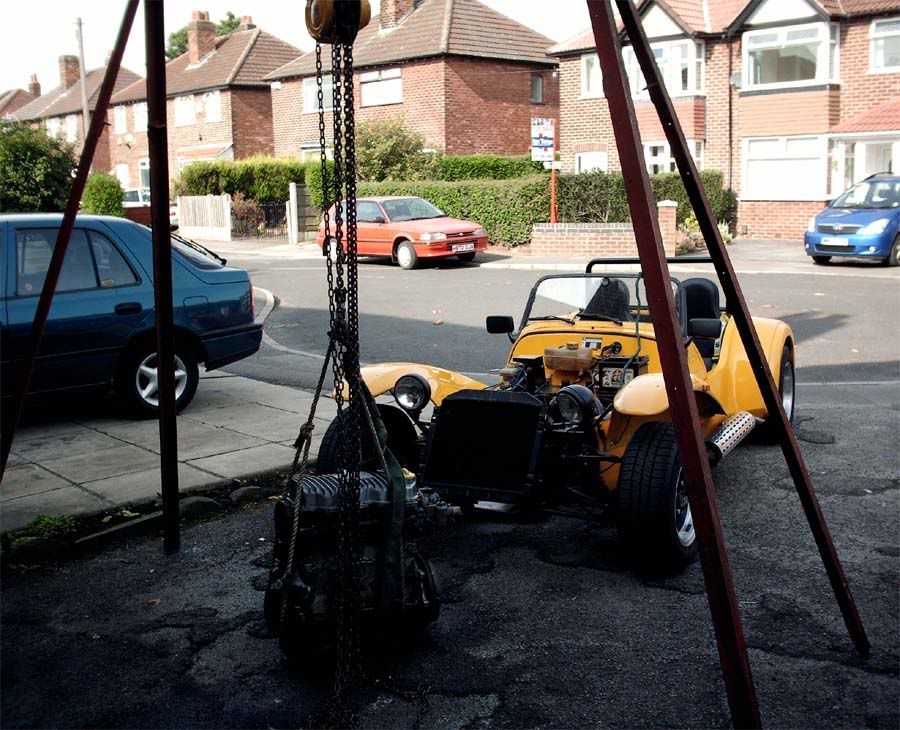

Here are a few photos of my weekend: -
How it was:
Engine out:
Engine bay needed a bit of a tidy:
New meets old:
Almost there:
The old engine was standard apart from the carbs, giving out about 120bhp.  THe new engine is Mark Stanton's old CVh which according to this : http://www.ferriday.co.uk/performance/solid_lifters.htm
is over 150bhp.
Thanks to Mark, my Dad for helping me and every one who gave advice and offered to help.  :t-up:  :t-up:  :t-up:  :t-up:
Kirk :t-up:  :t-up:
p.s. the title was suppose to say 1.6 cvh to 1.6 cvh engine conversion  :arse: .

By the way .How come you can swop Mills with the Gearbox still int Motor.?

Peter, why not change the engine without taking the gearbox out?

I'm impressed - a good bit of work in thetime.
However, I thought you had to take the CVH and gearbox out together as there is not enough space in front of the block.
Is it a 5-sp type 9 for the record ?.
Just in case  / next time query as I had the same layout and rad off, lifted the whole unit out with gearbox ( and it took me a lot longer ! )
Yep, Highbury Hose were cheaper than anywhere else and delivered quickly, I was really impressed by their service.  The old hoses were starting to crack so i needed the Silicopne hoses.  They look cool as well :cool: .
We didn't have a problem taking the engine out without the gearbox, there seemed to be plenty of room.  We just had to be careful of the brake pipe, but it still wasn't in the way.  It is a type 9 box.
