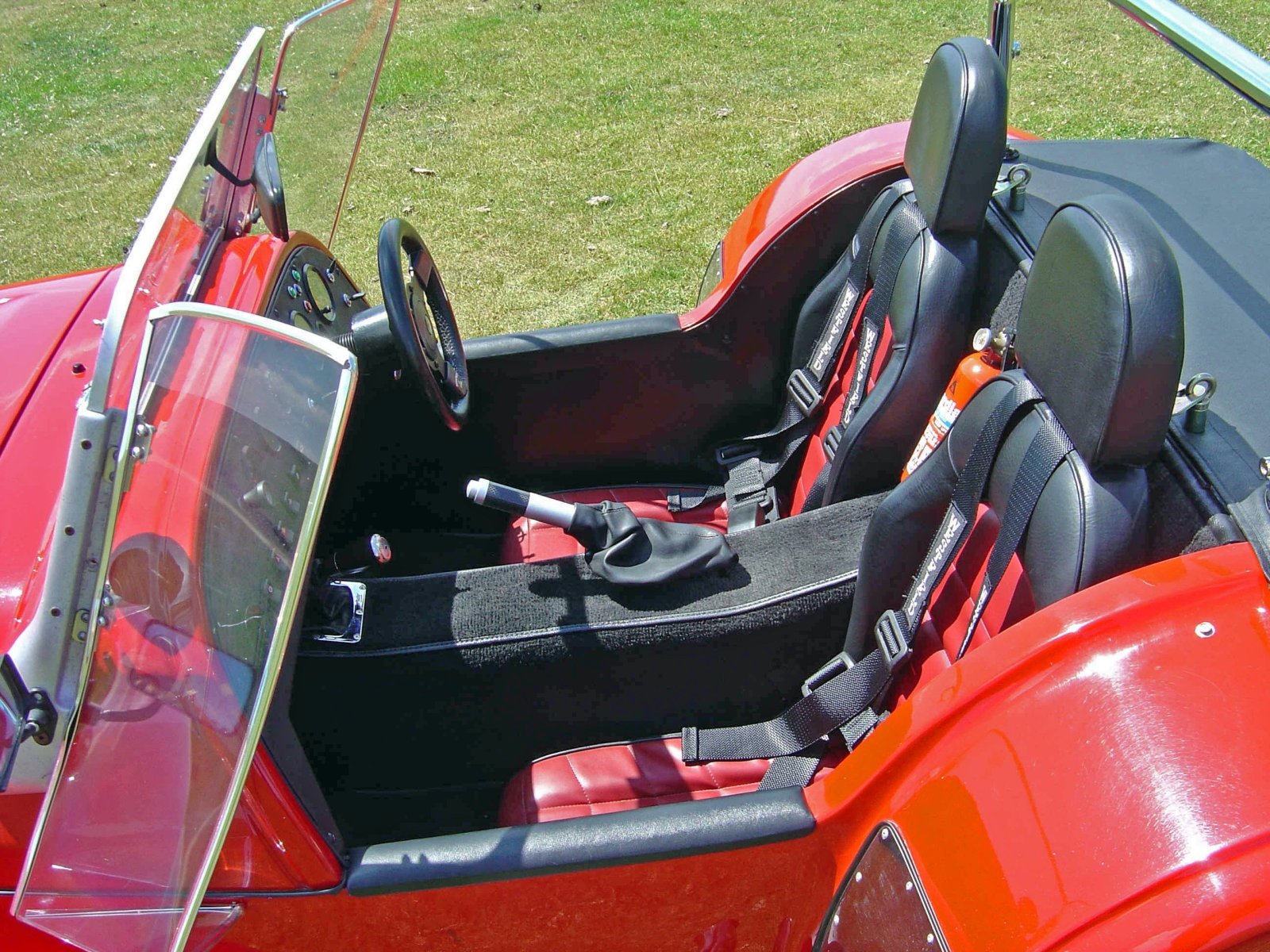

MarkWestfield Posted August 15 Author Posted August 15 1 hour ago, Flying Carrot Steve said: A rain cover will go over the high back seats no problem at all, they are generally not too high and lower than the roll bar for example. When choosing your next seats, I'd put safety and comfort first and get the normal (high back) seats, it pays to have something behind your head in cars like these. I was thinking low seats to keep the cover over the tub as in the below. You're right with head rests and was thinking of building some that attach to the roll bar. 1
Captain Colonial Posted August 15 Posted August 15 Rare as hen’s teeth now but worth a trawl for Richfield RX777 seats on FleaBay, etc. which is what I have in my narrow. I found the Inatrim seats to be overly side bolstered for my retired torso, personally. Whatever seats you decide on, sit in them before you commit!!! 1
