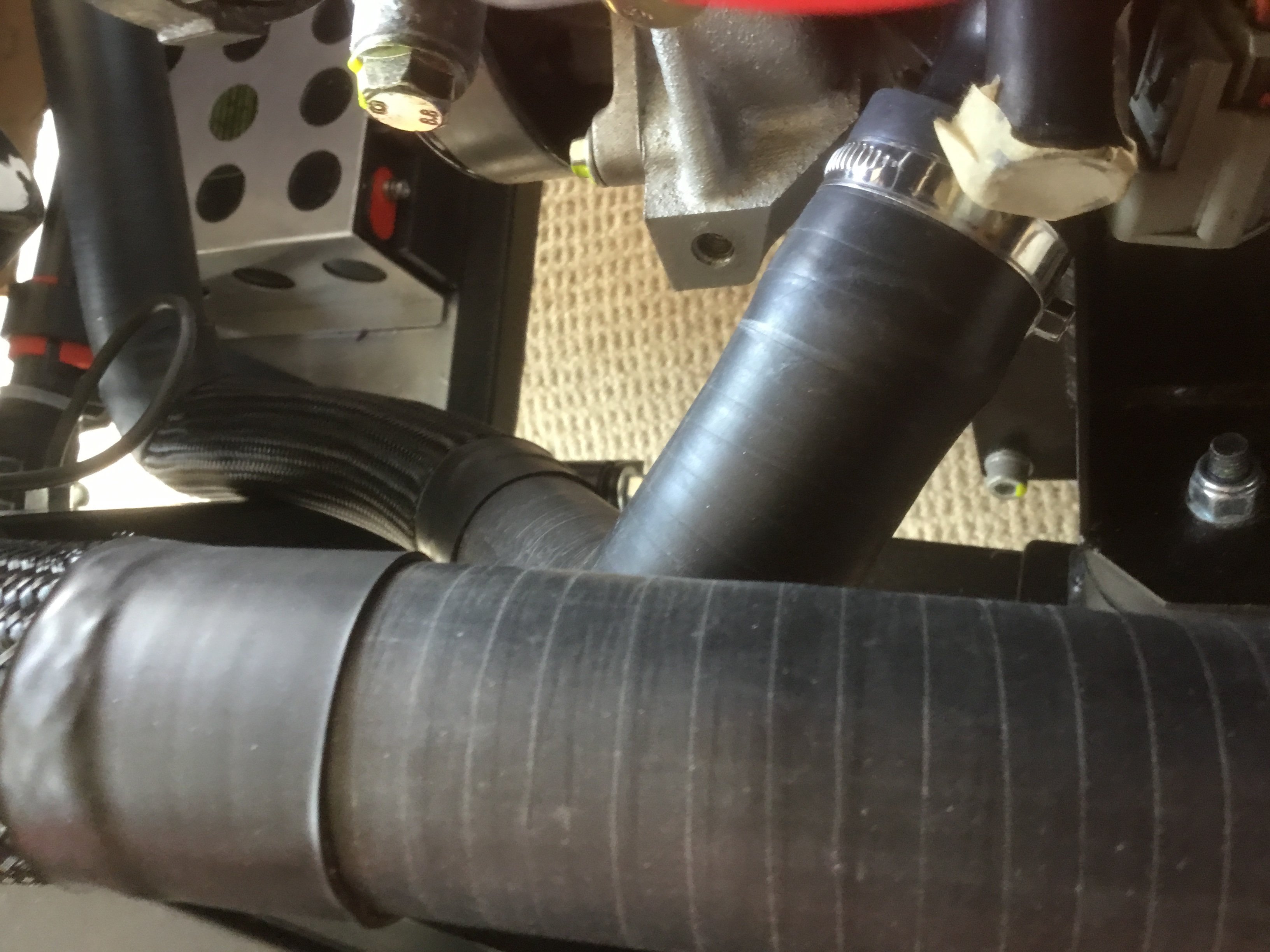

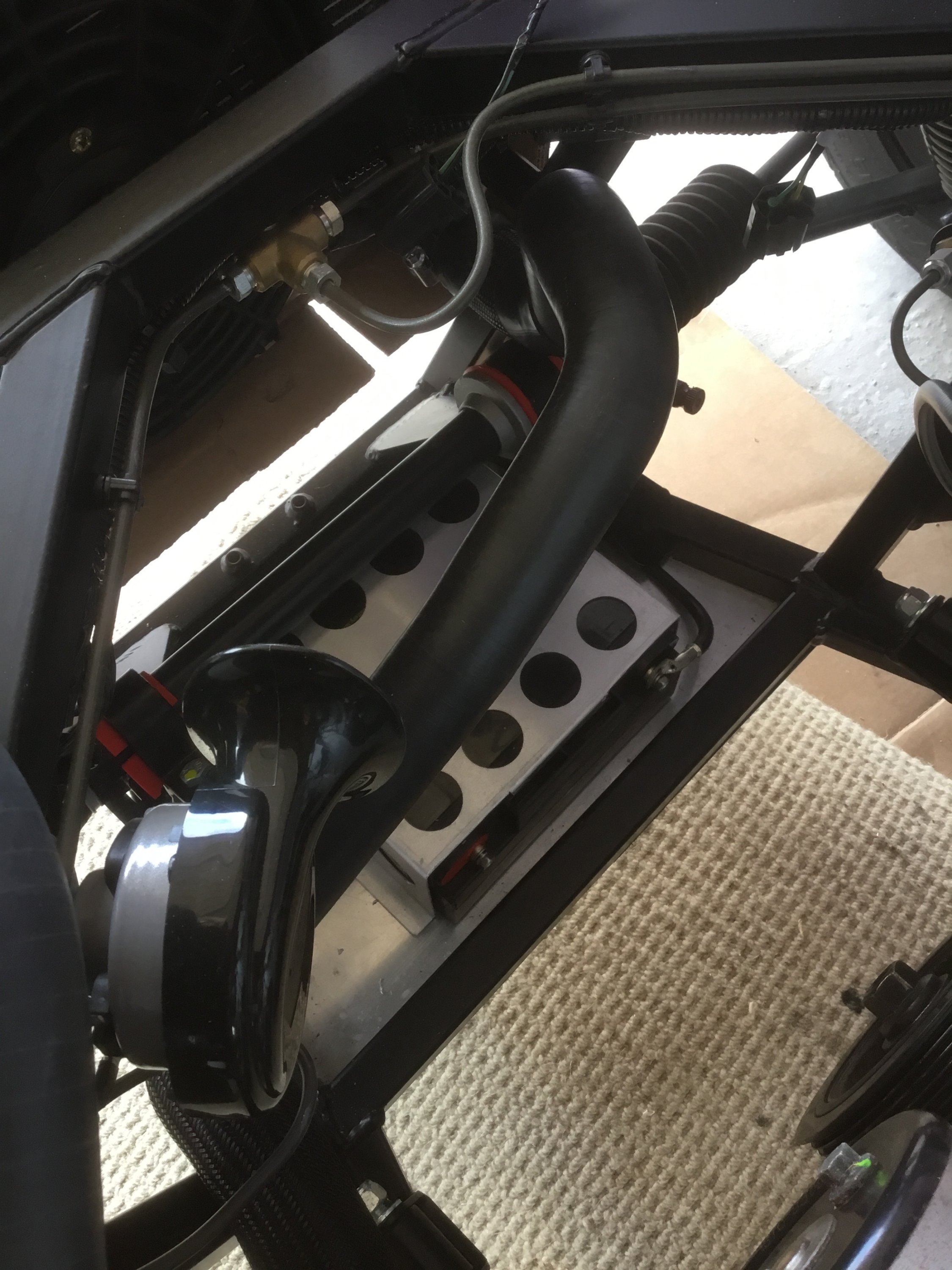

So it was this set (pictured) that you are using? I can see that the thermostat bypass hose would likely fit, but a lot of the other hose runs look significantly different to what I have. I presume that the set eliminates all the rigid aluminium pipes?

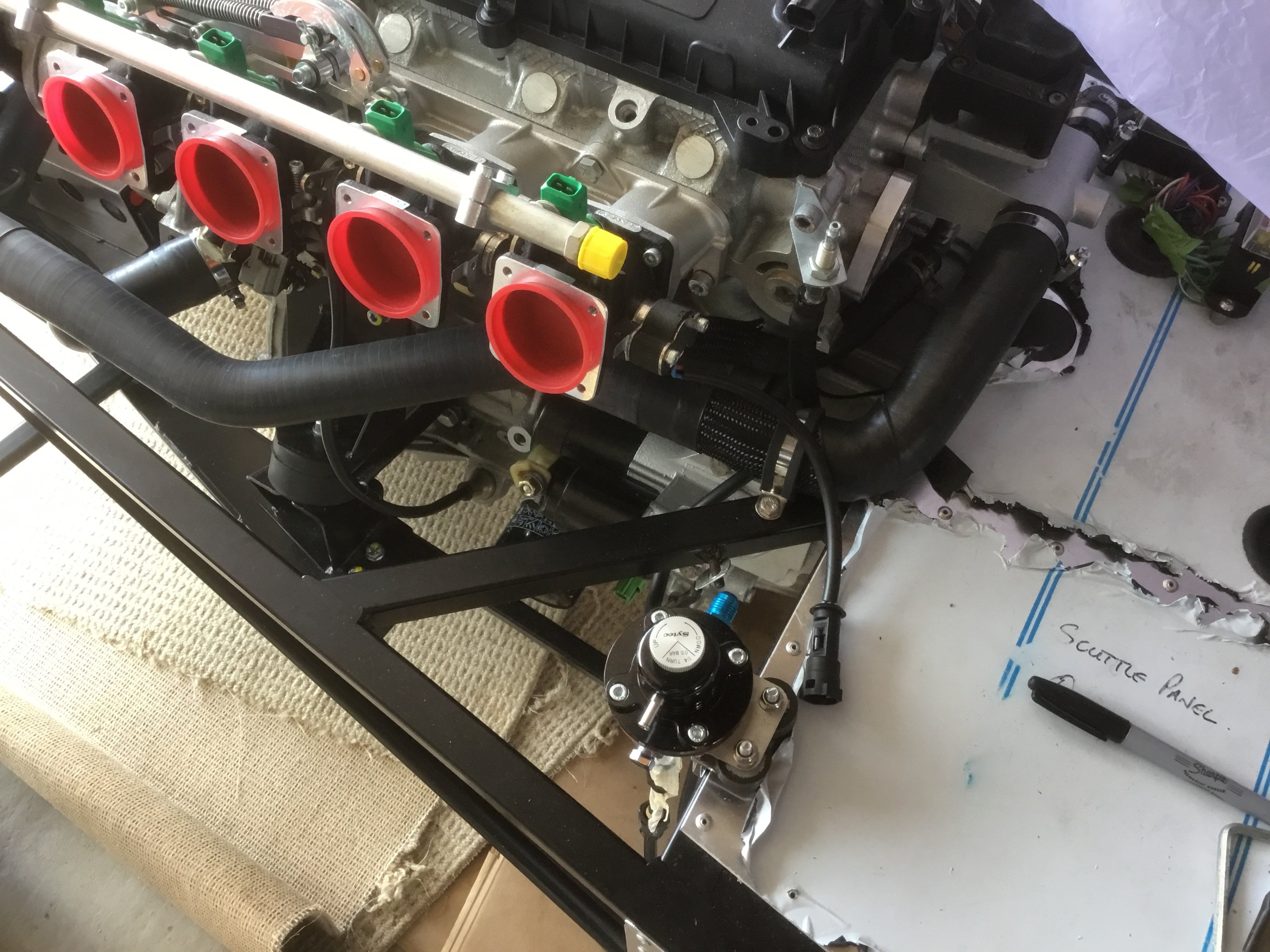

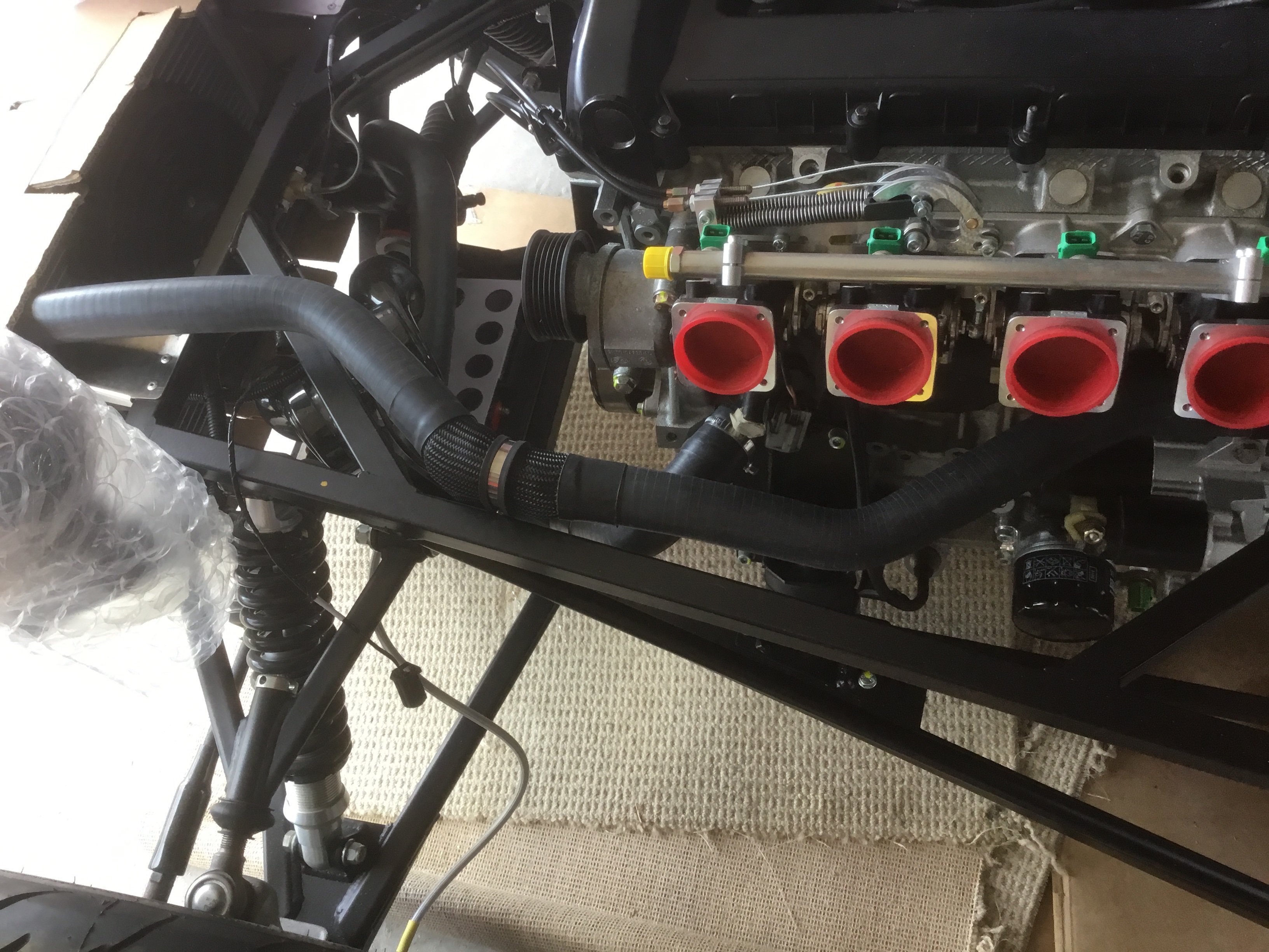

Would you be able to get a few photos of how you are running the hose set on your car? Thanks. IMG_3926.jpeg.07576d10b366ab13d64ec6e03ddb05db.jpeg
As far as I know it eliminates the solid sections. I am not running a heater so I guess my setup is quite simple. So far I have only fitted the top and bottom radiator hoses. The set cost me £330. IMG_0978.thumb.jpeg.9fe79407e736775a27687ee8f71030a6.jpeg
Thanks for the useful photos.
I can see from them that it works for your car but my setup is very different. My radiator has both the input & output on the left plus I have a heater. I’ll have to continue with my current plan of piecing together various off the shelf parts until it fits!
