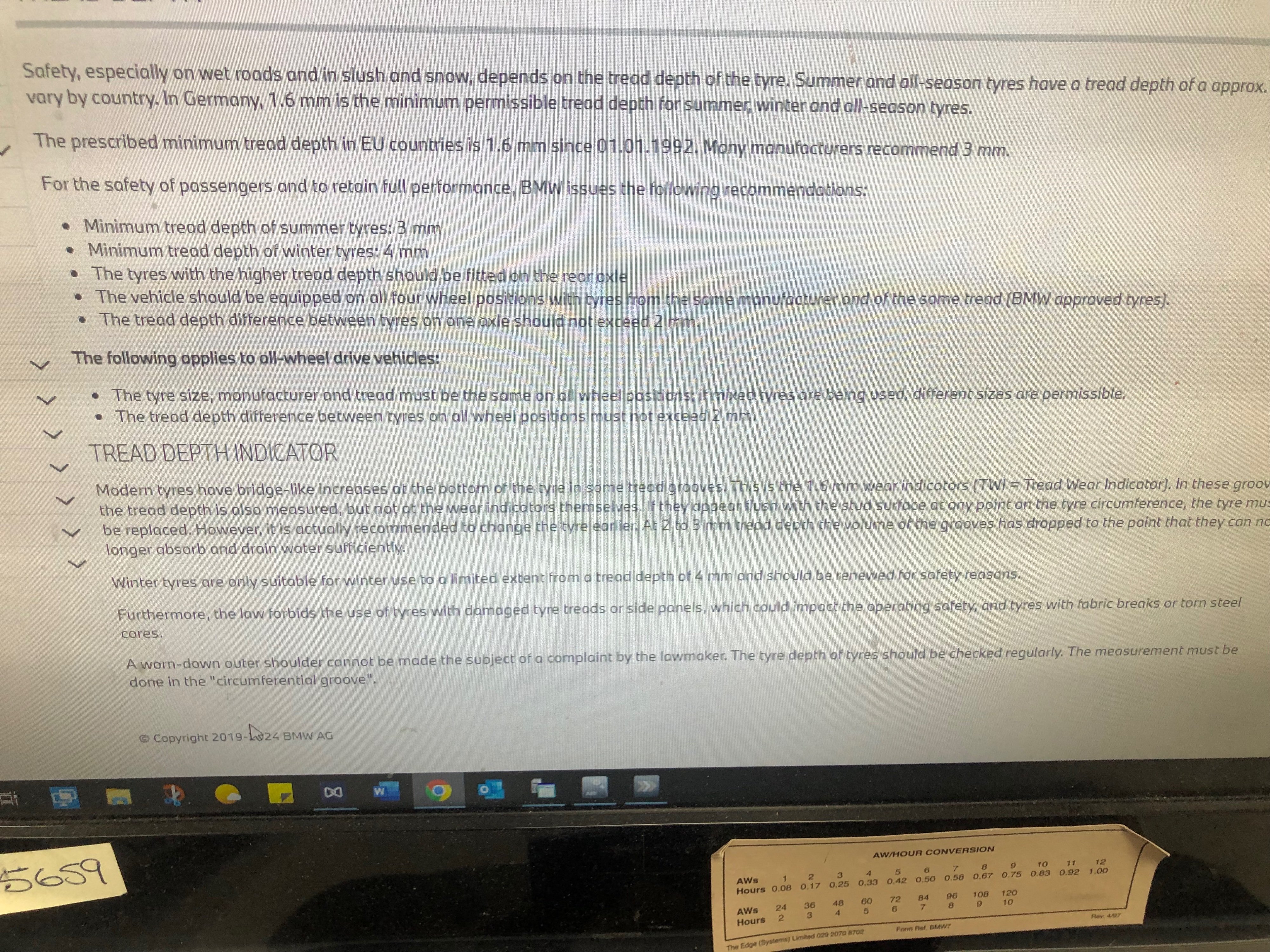

No, other STAR RATED brands are acceptable, just make sure they are compatible with vehicle. BMW’s stipulated tread depth deviation across the axle is a max of 2mm .. see attached, hope this helps
  • Thanks 1
@Michael Berisford thank you. It's an X3 F25 30D on 19" staggered wheels. Originals were Michelin Primacy 3 run flats and the 2nd set of these are now about due. But I'm considering Hankook S1 Evo2 runflats as a set of P3s are well over a grand now. The Hankooks are star marked and used as original tyres (in different sizes) on the X3 G01, but if it's that crucial, how do I find out if they're compatible with the F25?
