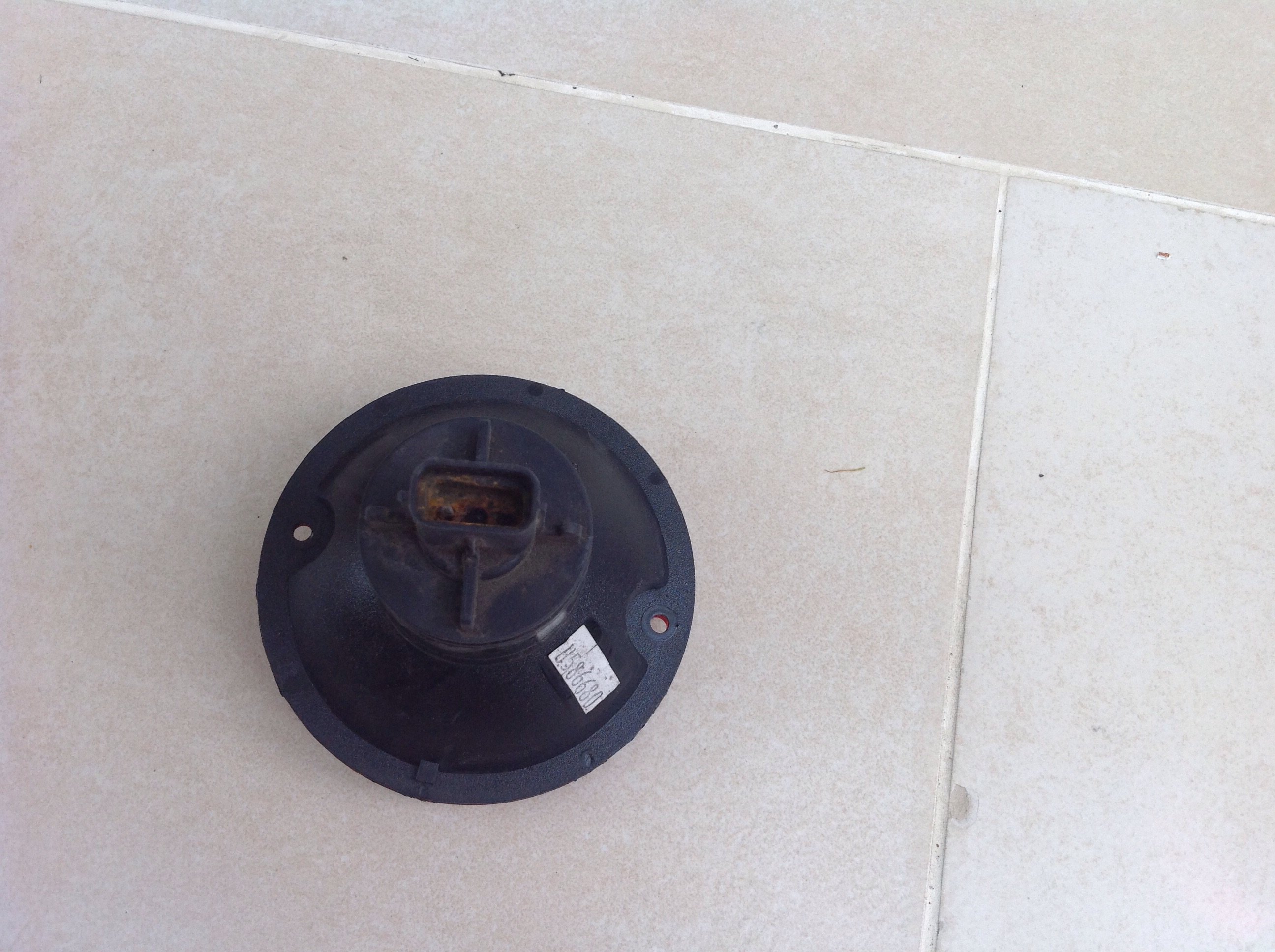

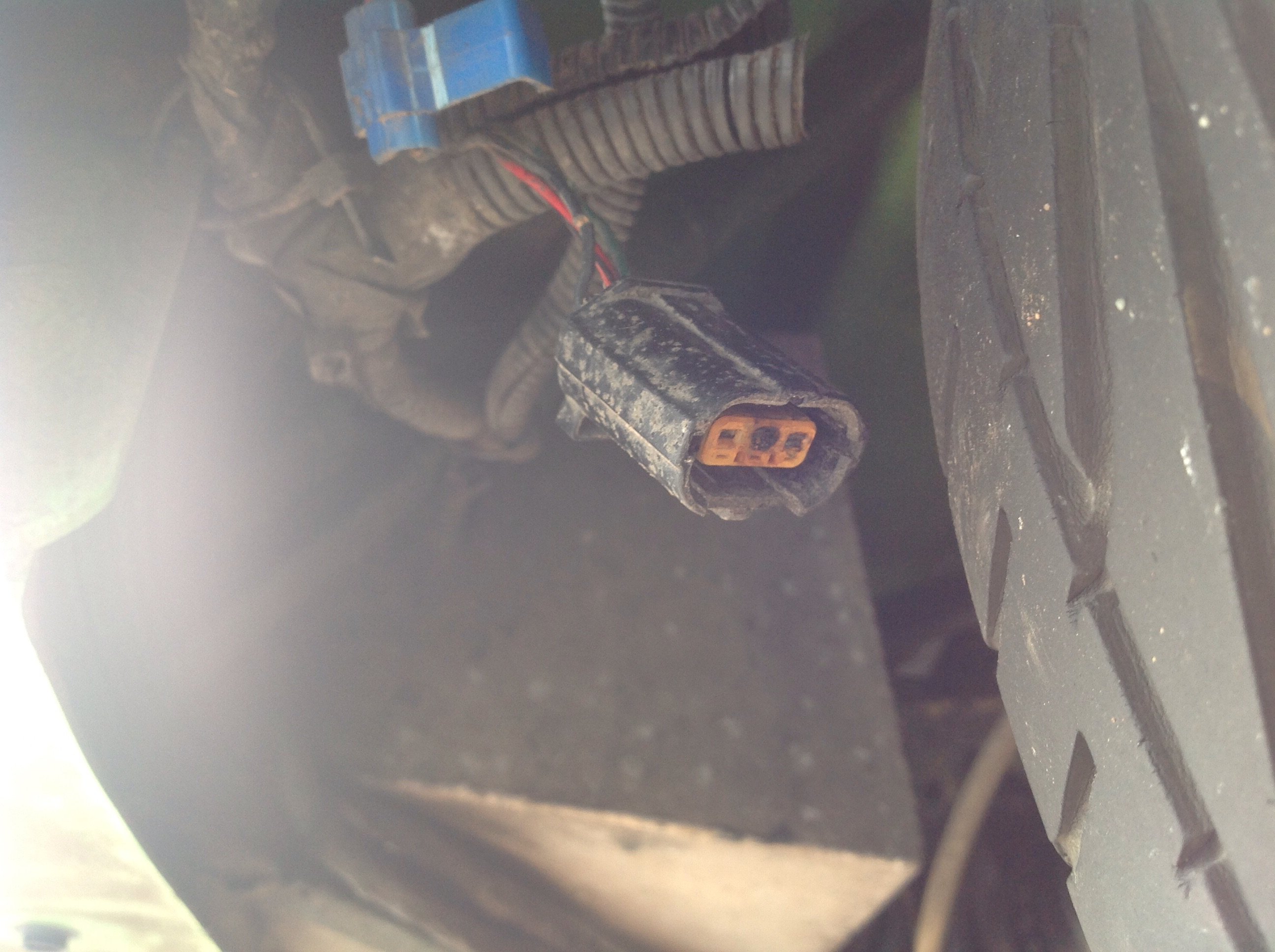

Does anyone have an old connector for the rear stop/tail lights please? Mine has corroded! I've ordered new 95mm round lights but they don't come with the connectors. I've asked SVC, CAR BUILDERS, RS COMPONENTS & EUROPA SPARES but non stock the connectors and can't /won't point me in the direction of a supplier. It's a 3 pin female plug.

Have you got a pic of the new rear light connector?  They look like Econoseal connectors like this:
https://polevolt.co.uk/acatalog/3w-Econoseal-connector-female-with-terms---seals.-ESC3F.html#SID=57
Thanks, I've not received the new lights yet so can't be certain, but the econoseal
ones look to be right.
many thanks
Mike
I can confirm they’re Econoseal connectors, as used on some Land Rovers (95mm fog & reverse lamps on 2002 onwards/TD5 Defenders, and 73mm 300TDi stop/tail, sidelight and indicator lamps).  You can buy them with tails from Britcar, Paddock Spares or similar if you don’t have the right crimping tool to do the terminals.
