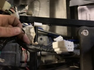

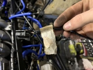

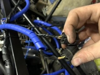

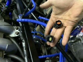

Hi there guys been on this forum for a while now, reading loads and loss of posts! Trying to gather as much information as possible. Quick history, bought an unfinished MX5 kit car, on the loom at the moment as I’ve fitted the gearbox and engine. Got a couple of plugs that I can’t quite place! Any help would be massively appreciated!
1st picture: It says Fuel pump actuator
2nd picture: 2 plugs of the main engine loom
3rd picture: the radiator plug
4th picture: plug of the main inside loom
If you go to mellens.net you can download the mx5 wiring diagrams there.
which version have you got?
The fan switch , if using the mx5 ecu there is a feed to the cooling fan , failing this you can wire it through the thermal switch on the radiator ( power to the rad switch, rad switch to fan , other fan to earth)
the two engine plugs would need to know the wire colours but should be straight forward to identify ( where are they in relation to the engine, side front reAr) I just happen to have an engine harness on the dining table.......
again the internal block would have to try and check through the diagrams but again would need to see the colours
