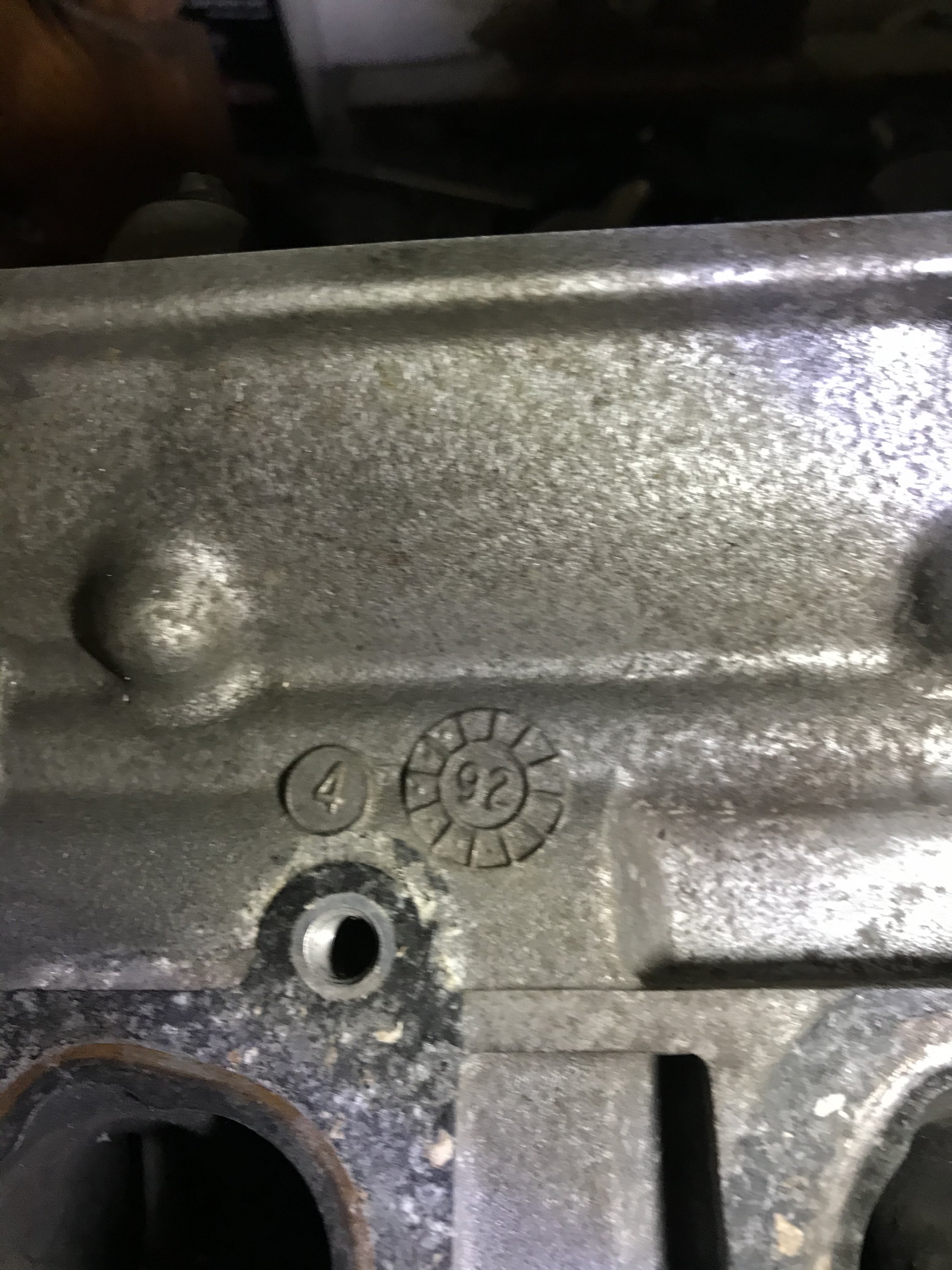

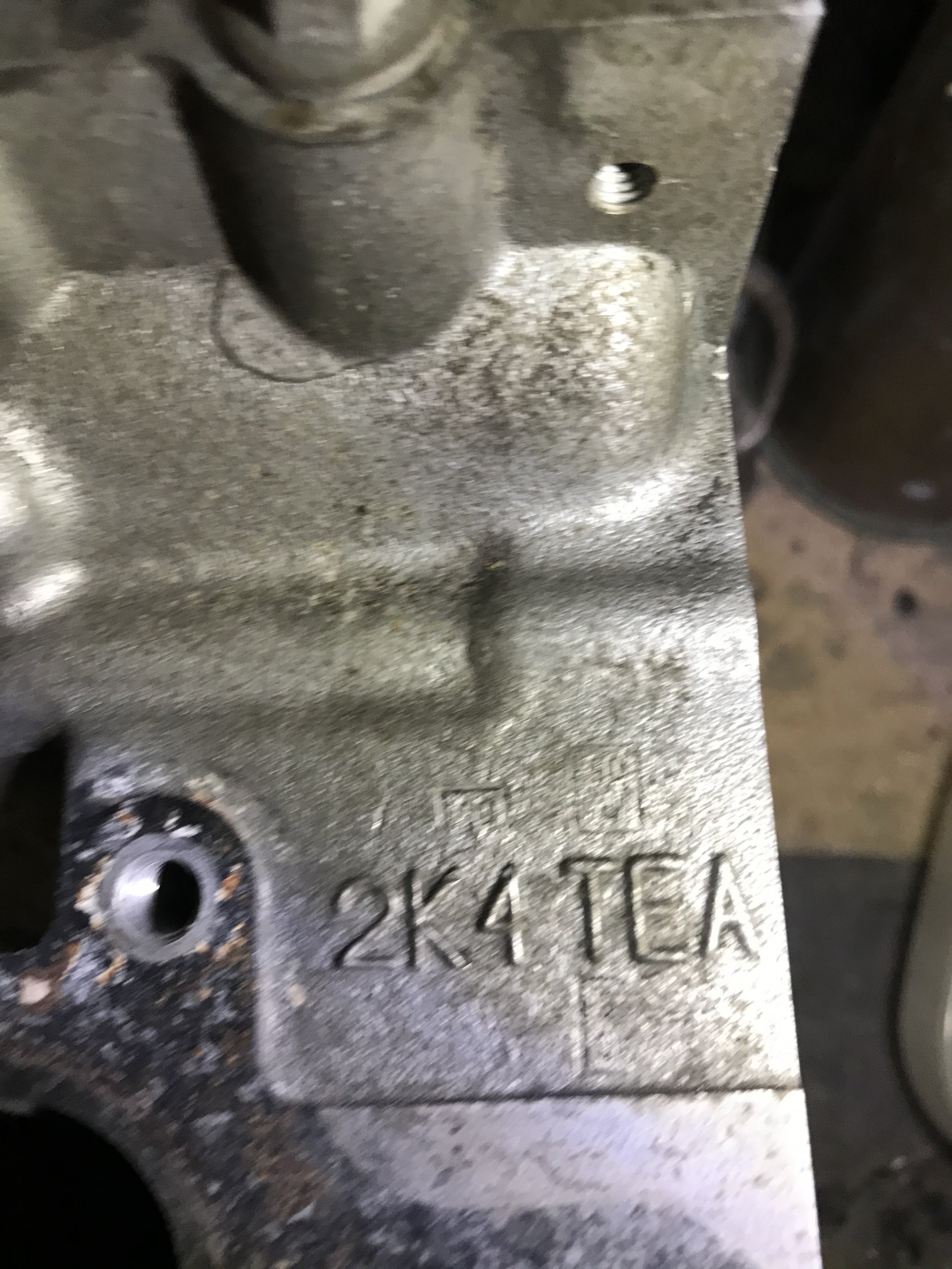

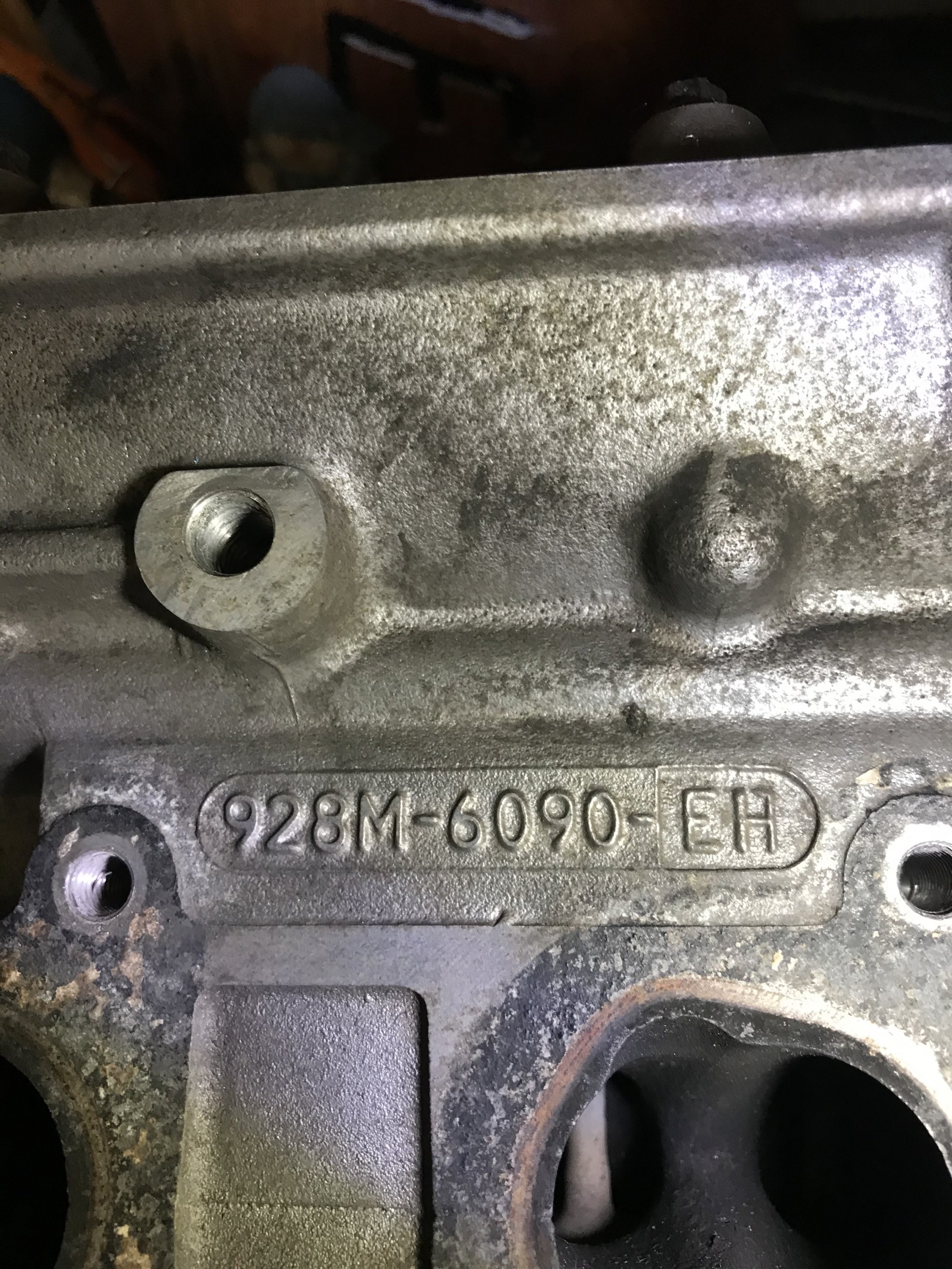

Hi This might be a dumb question but  I have purchased what I believe to be an 1.8 silver top head, to get ported ( I wanted to minimise the time my will be off the road) before I send it away is there anyway of ID it to guarantee what it is? I believe the zetec head came in 105 or 115ps?? I would hate to get it ported and end up with the same power as I have now!!
The 92 will be the date it was cast. The dots relate to the month. Havnt a clue of the rest sorry

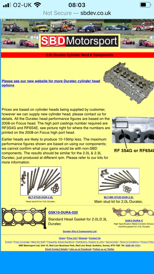

Hi after a search, the Zetec 1.8 head is the same casting , port wise on the 1.8 and 2.0 , cams are interchangeable
the duratec 1.8 has a difference in design and the later head produces more power ( see pic for details)
hth Gary
Thanks Gary I might email SBD and ask them about it
