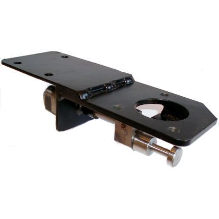

Type 9 Gear lever extension
Anyone have a gear shift extension that is surplus to requirments. For type 9 box
I maybe wrong, but a 2l Zetec (assumed from your car details) mated to a type 9 should only need a cranked gear lever. I found the gear lever extension on my Duratec would have put the gear lever too far rearwards, so much so that the extension would hit the chassis within the tunnel.
