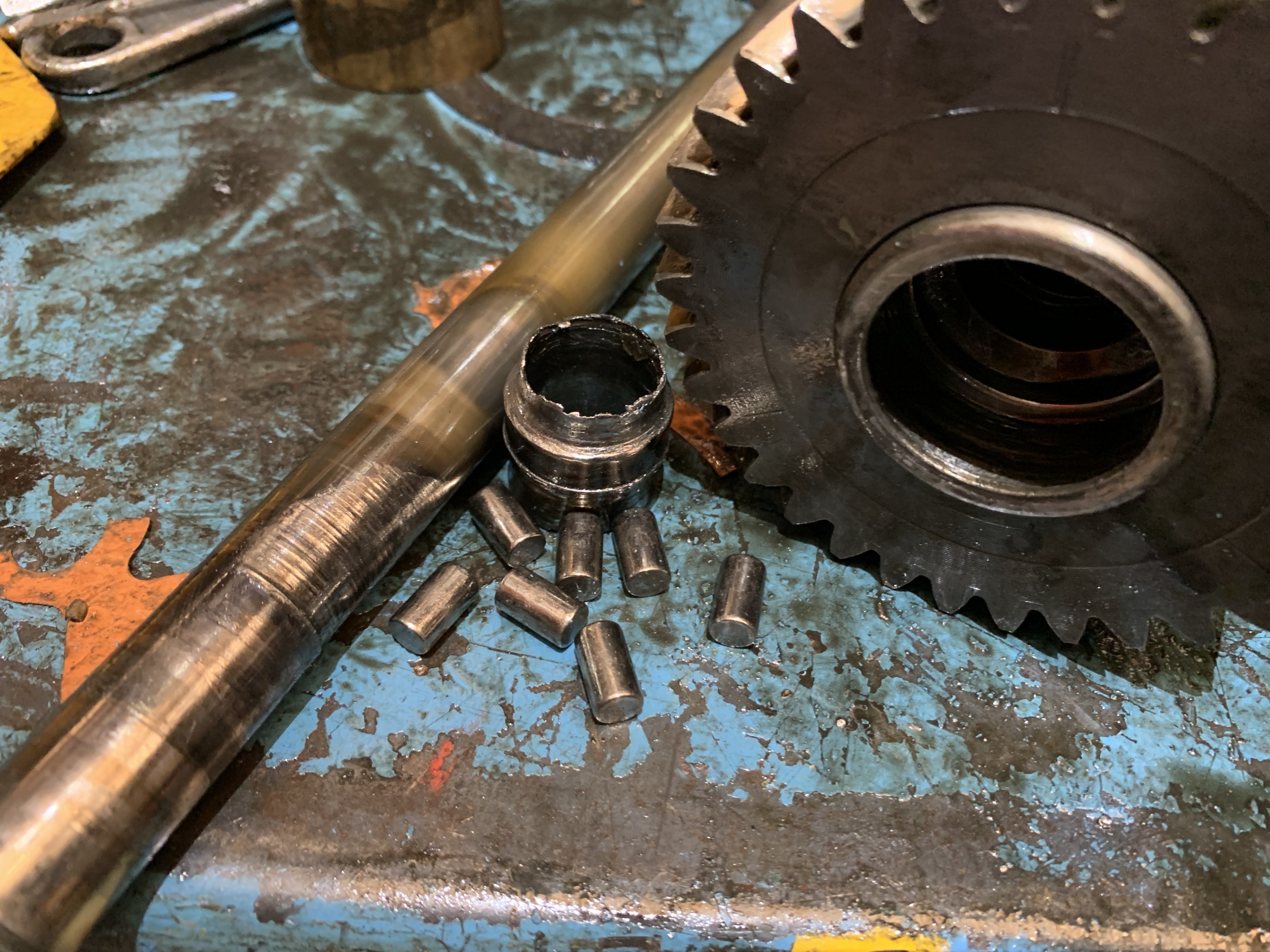

Mostly uprated boxes will use Standard casings with the v6 Larger lay gear bearing and then a spacer off the inner shaft to act as the needed larger inner race. My previous “good” professionally built close ratio HD box spun this spacer on the shaft and ....
not sure if it was a builder issue or not. The builder is no longer about so this build will be my own and if it goes bang there is no one to blame except me :)
