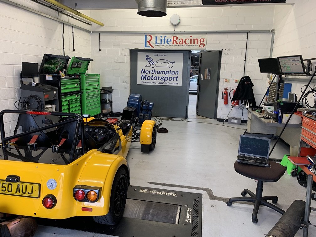

First thoughts - very impressed with the setup - clean and impeccably organised, with some pretty serious machinery in the workshop - always a good sign.
Second thought - despite being a very busy man, Troy put up with me watching the entire mapping session and asking all sorts of daft questions - I really like to understand what is happening and he was happy to explain.
Super-clean dyno cell

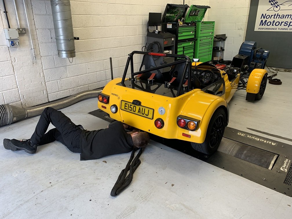

Car being strapped down onto the rollers

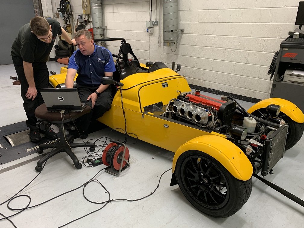

Troy and assistant (sorry, I didn't get your name!) setting up the laptop to talk to the ECU

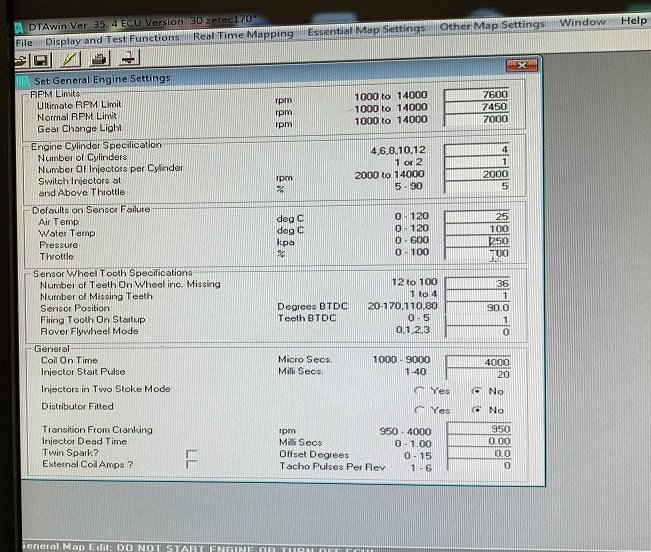

Some of the many ECU settings

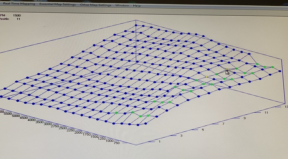

Early tweaking of the low-rpm sites on the fuel map - the end result was significantly different to this

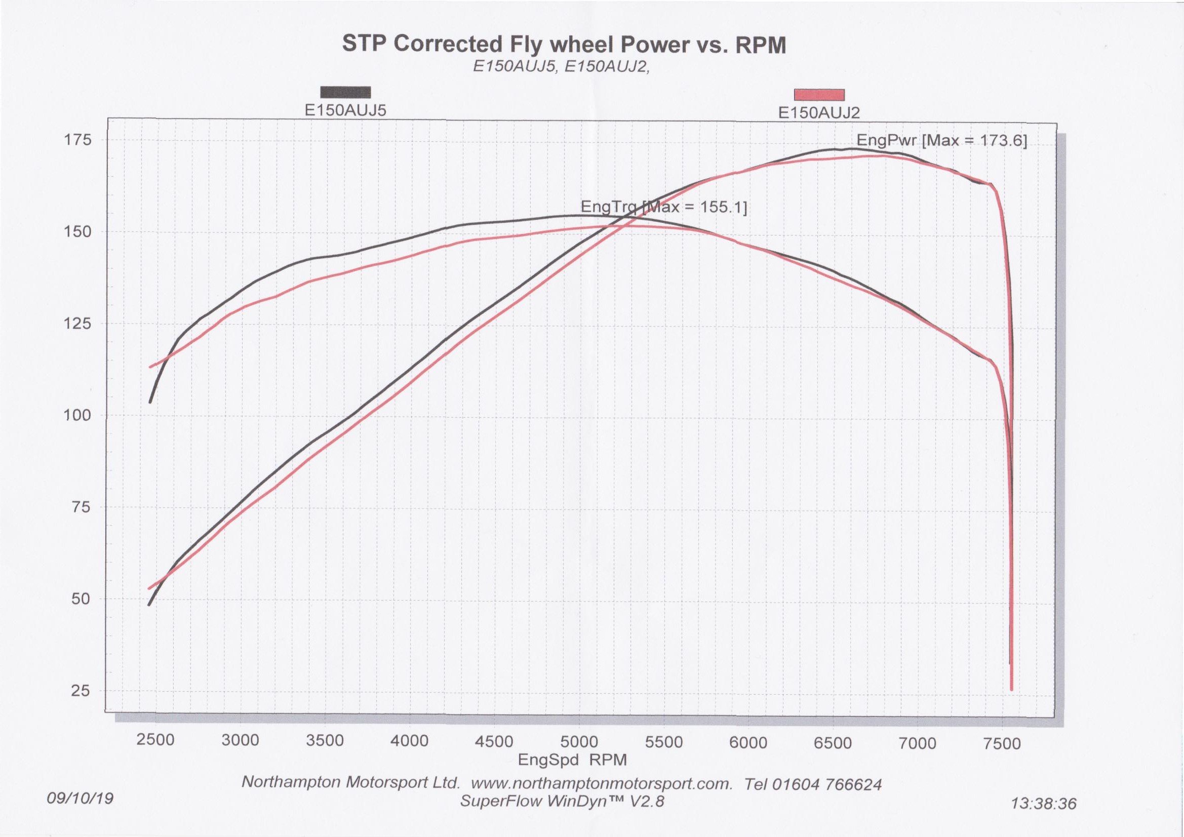

The Results
Now I'll be the first to admit that I was hoping for some extra power - the engine spec (2L Zetec silvertop with Piper 270 cams and Jenvey TBs) suggested there should have been another 10-20bhp available. The previous graph from the last mapping session in 2012 showed 172 bhp @ 6,500rpm and 147 lb ft at 5,500rpm.
The first power run gave about 170bhp, which was encouraging, if only to show that the original power figure was probably fairly accurate.  Troy also ran the car with and without the air filter, just to see if there was any restriction - the result was exactly the same, so it went back on.
However, despite a tweak to the cam timing and a thorough re-work of the ignition and fuel maps, Troy only managed to increase the power to 173.6bhp @ 6,500rpm and 155 lb-ft @ 5,000rpm, which he said he was surprised at - normally the cam timing tweak gives at least 10bhp. We worked out that something else was probably the limiting factor - we suspect its the exhaust manifold (OE Westfield)
Before and after graph
What the graph doesn't tell you is:
1) I can now blip the throttle without any hesitation
2) The pickup from a closed throttle is much improved
3) Throttle response is noticeably better
4) It's smoother throughout the rev range
5) Power delivery is less "spiky"
6) The pops and bangs on the over-run have almost disappeared
The combined result of all of the above (and the torque increase of 5-10 lb-ft from 2,750-5,000rpm) is that the car is quicker and easier to drive, but not because its more powerful.

Don't sweat it about the manifold, I've seen close to 200bhp @ 8000 rpm from a 1.8 Zetec on the same dyno that NMS use. With the torque (and power) curves dropping off as they are in your case, I'd say maybe the head could do with a fettle if you want more power? As well as the cams, of course. You will end up with a less 'driveable' car though, the slippery slope...
The DTA EX48 ECU you have there is pretty old and not very advanced, so the 'throttle on' response is tricky to tune in - great to hear Troy has improved it significantly though!
As you said, no bigger headline figure but a quicker car due to much smoother map and better torque - I've always found the same from a proper map and glad to hear you have too :t-up:

power vs rpm.pdf
